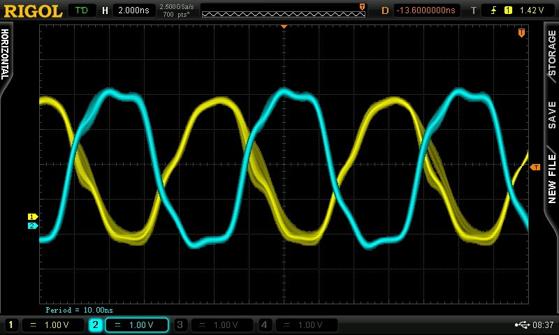

How did you see a 100MHz clock looks like a sin wave?
There are lots of ES9038Q2M dacs that come with 100Mhz clocks. in some cases we have experimented with replacing the original clocks with Crystek 575 100MHz clocks. For one example: ES9038 Q2M I2S DSD Optical Coaxial Input Decoder DAC Assembled Board DC9-15V 8751762607403 | eBay
Of course with a 100MHz scope, a 100MHz clock will look like a sine wave anyway, or pretty close to that. The first harmonic frequency of a 100MHz square wave is at 300MHz, well above the maximum frequency of a 100MHz scope. However, even using a 600MHz scope, Crystek 575 waveforms don't look very square. The blue trace below is the output of a 100MHz Crystek 575 100MHz clock, and the yellow waveform is the MCLK signal from a Sabre dac exported on a GPIO pin. The Crystek clock looks better than some cheaper competitors, but still not all that square. The dac GPIO MCLK output looks pretty much like a sine wav. Of course, its possible if using active differential probes it would be possible to see somewhat better looking waveforms, but not in all cases. Some ultra-low jitter clock manufacturers include output waveforms in data sheets, and they rarely look all that square at very high frequencies. It probably would make more sense to have LVDS clocks and dacs if we ever get to DSD2048. Even DSD1024 is really pushing it with data being clocking on both clock edges, IMHO.

Both scope and probe are rated at 600MHz bandwidth.
Risetime of Crystek 575 is rated at 2ns max 20%-80% Vdd.
A 100HMz clock has a period of 10ns, which is to say a half-cycle is 5ns. With a 2ns risetime, there might actually be 3ns when it is at or above 80%Vdd (or at or below 20%), and of course we expect some loss of detail on that with only a 600MHz scope and 600MHz probe combination. Better to have a 5GHz scope, or faster.
In the above regard Crystek clocks are pretty good.
NDK NZ2520SD which are available up 80Mhz are rated for a rise time of 6ns max.
Hopefully we will always be fortunate, and have much less than max risetimes 🙂

Hi Markw4,
Your 100MHz clock waveform doesn’t look that correct. I cannot see a clear rising edge or falling edge, as well as ringing, overshoot and reflections. Looks like the bandwidth is not sufficient though you said you oscilloscope has 600MHz bandwidth. Just hope you can figure out what’s the problem of the measurement.
The attached picture is the waveform of a typical 98.3040MHz audio clock I measured while back. There are roughly 1ns rising and falling time, as well as ringing and everything. It doesn’t look like a sin wave. My oscilloscope has 1GHz bandwidth with sampling rate up to 8GS/s. It doesn’t superior too much than yours.
If you cannot see the true waveform, what you get from your measurement will mislead your analyzing result. For example, when you talking about the 100MHz clock, you are worry about the setup time and hold time because of that waveform you saw. Actually Tsu and Th have nothing to do with the accuracy and sound quality. It’s all about the tolerance of your digital system. For a synchronized logic system, they describe the relationship between the original clock and date (or generated clock). If the Tsu or Th condition (depend on the logic chips) doesn’t meet, the output will be wrong, and you will hear noise or get malfunction (So you will clearly know something wrong). If that is the case, it will be totally unacceptable for audio application. Otherwise, the digital music will be 100% correct. It’s black and white and nothing in between.
In the digital domain, the only thing impacts the sound quality is the jitter of the MCLK. Propagation delay and skew are all totally different concept to the jitter. They will have no any business with sound quality as long as all timing requirements are met.
Clock frequency doesn’t have direct relationship with the clock quality. Both 100MHz and 50MHz clock can have same raising and falling time, same overshoot, same reflection. The difference could be only the plateau time. Actually, if they have same phase noise numbers, the higher frequency ones will have less jitter.
So, higher frequency clock closing to 100MHz doesn’t look like a sin wave and it doesn’t degrade the sound quality (may upgrade) under the same condition (as long as your DAC can work with).
