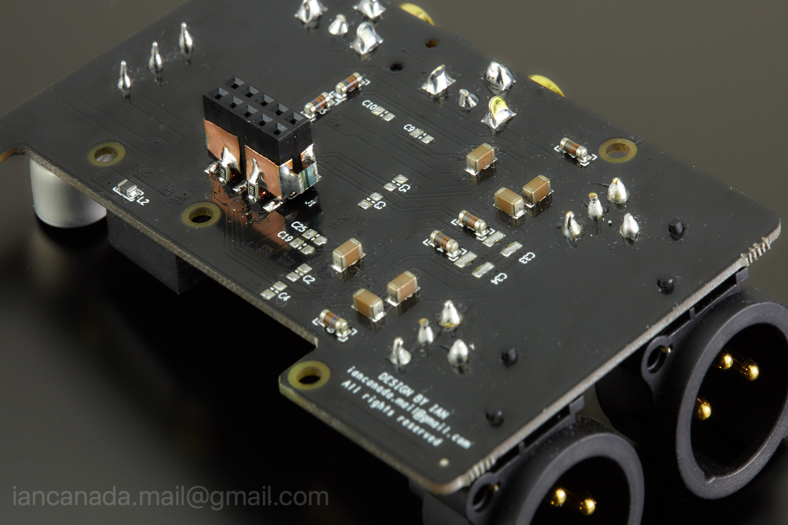

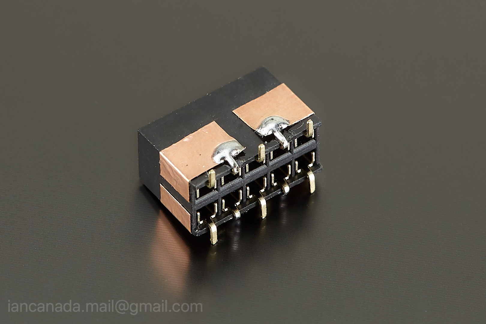

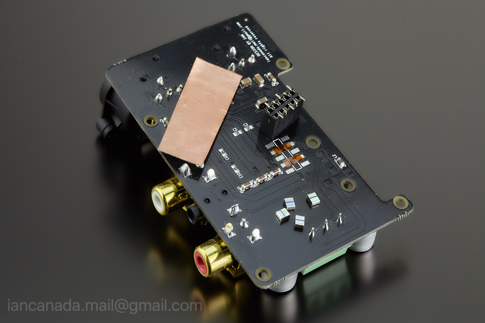

Implement Greg's Rasmussen filter
I implemented Greg suggested Rasmussen filter for my I/V STD in this way. I'm pretty happy with the solution. Please find the pictures for details.
It needs to be run-in it for a couple of days before doing any listing test.
Ian

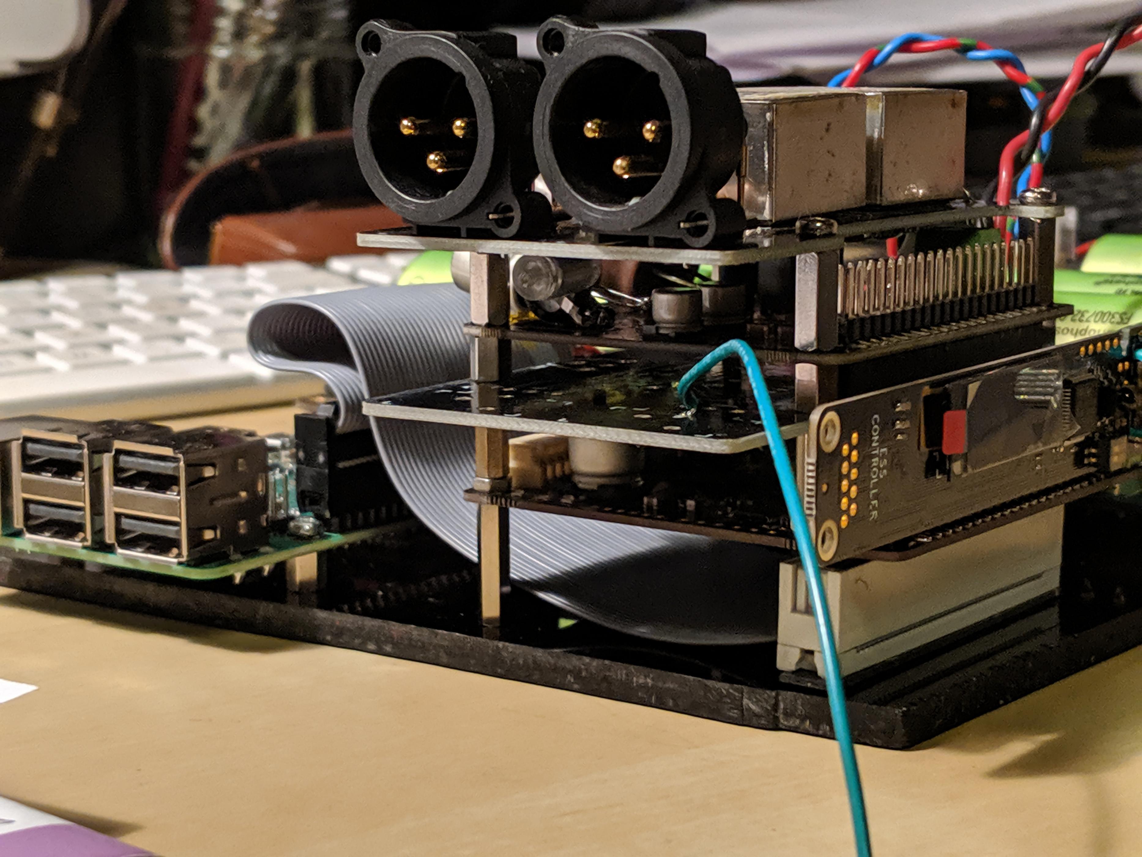

Ingenious Ian!
I've separated my Pi from the stack as suggested previously with a ribbon cable and used a spare transfomer IV pcb for a screen between the DAC and the FiFoPi.
I scraped a little solder resist off the ground plane and soldered a ground wire, despite a few tracks on it I think there's still a lot of screening. This definitely reduces the remaining slight grain and makes the presentation a bit smoother. The only downside is that two of the mounting holes are now blocked by the IDC connector. A bit of decent double sided foam tape solves that.
It also makes sourcing an enclosure easier with reduced stack height 😀 I'm getting close to putting this in a box and just enjoying it. I found the player a bit grainy and shouty at first and struggled with bad recordings (I have loads of those!) but as we have gone along and developed these tweaks, it's got to the point where I can just put something on and just listen. Thanks to all the contributors and especially Ian.

Low budget shield board would be to cover a board with aluminum foil, and ground the foil. You could also use copper tape, but copper tape is not cheap these days.
I've made shields with copper tape, then cover the tape with kapton tape so there is no risk of shorting to something.
I'm trying to design a shield HAT to be installed under DAC HAT. Maybe I could share some once I have the prototype PCBs.
