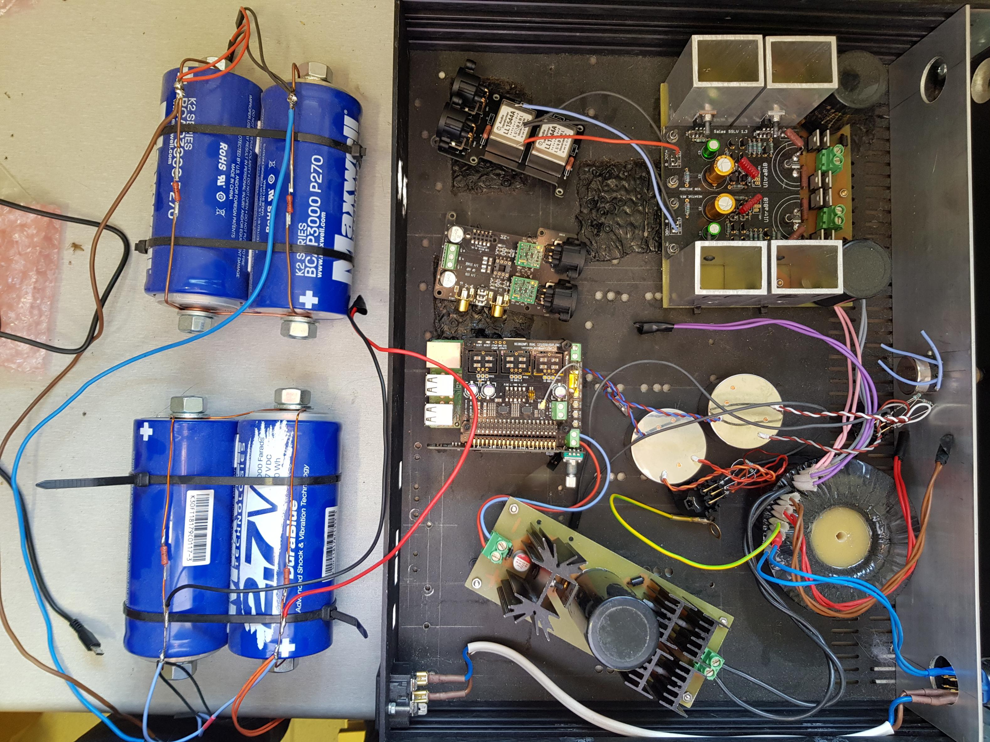

Hi guys,
Here are the result of my test on output stages for dual es9038q2m:
The gear: Rpi was powered by low noise 5V LDO, FifoPi powered by Ultracaps @ 3.3V and Dac board powered by another Ultracap @3.3V.
I tested following output stages:
- Ian opamp board with Sparkos Labs Class A power by Salas Bib 1.3
- Ian LL1544A board
- Super V/I LL1684 converter (voltage out mode)
- Ivans trafos sepcially made for dual es9038q2m from this thread:
Output transformers for DACs
The amp was Modulus-686 from neurochrome from this thread:
Modulus-686: 380W (4Ω); 220W (8Ω) Balanced Composite Power Amp with extremely low THD
Out of those three stages I tested Ivans trafos was absolutelly the best! I would say the most musical and natural sound. I really recommned you try them. Now I am waiting for Ivan to make me voltage out trafo for ak4497 so that I can compare them to Teramoto Finemet
So now I got 2xLL1684 and 2xLL1544A to sell. Anyone? ...
Thanks Ian, Thanks Ivan for your great work guys!

Here you go. All the goodies in one place.
I also got Ivan's transformers but haven't got around to install them. With your positive feedback I better do it soon. Btw, how do you load the transformers? I see that there are resistors at the output. What values do you prefer? Thanks.
In my case: XLR out. Ivan suggested to use 3K3 on each phase to get 2Vrms on the output.
Thanks! Will try that soon.
