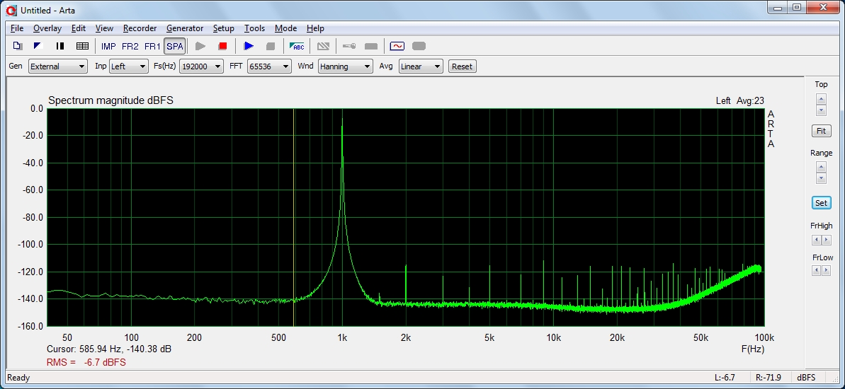

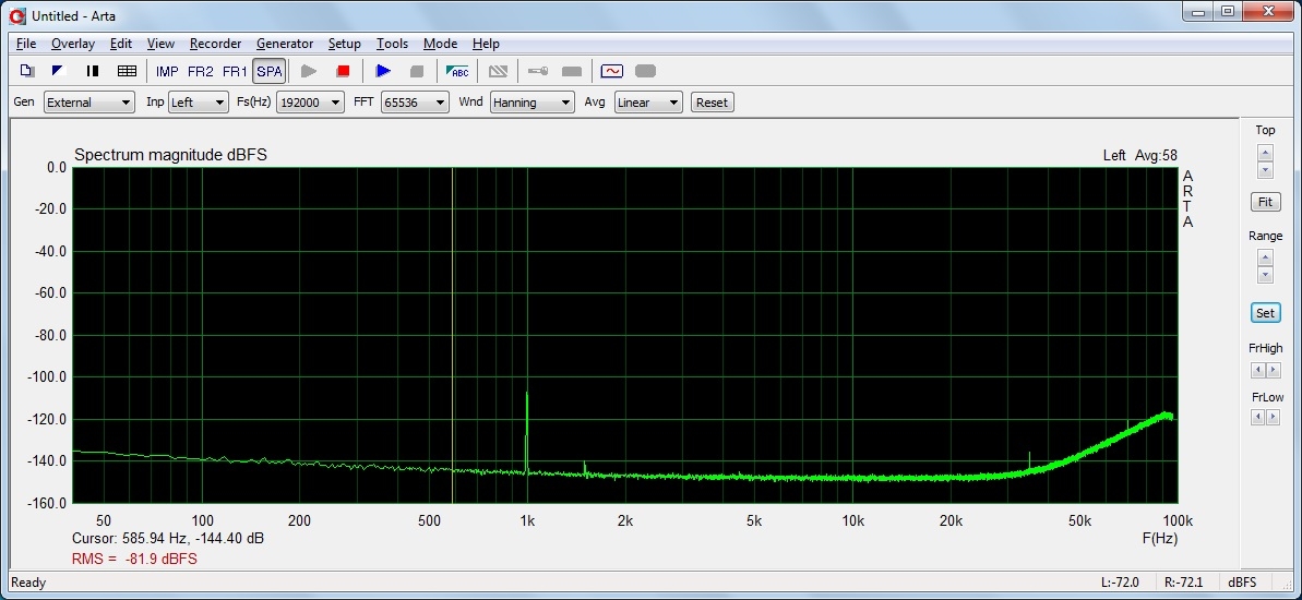

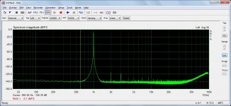

To follow up a bit on my last post, three screenshots of FFTs attached below. The first pic is 997Hz with dac volume level @-100dBFS. The 2nd one at 997Hz, 0dBFS clearly shows 2nd and 3rd harmonic distortion compensation would probably help reduce a little low level distortion. Changing the measurement frequency by 3Hz to 1000Hz as seen in the 3rd pic makes it look like 2nd and 3rd harmonic compensation might be fairly useless. In other words, the distortion changes with the frequency, and that's with only one frequency present. If there were lots of frequencies things would only get more complicated. Nonetheless, IME, performing adjustment of H2 and H3 in the dac registers can audibly help sound quality. So can improving output stage filtering at HF. One can't directly hear all the ultrasonic distortion spurs, but they may cause increased audible distortion in some power amps and some speakers. For whatever hard to pin down reasons, more filtering usually sounds better. I will think about redoing the design around the 3rd opamp on the output board.
Also, switching to DSD instead of PCM may improve the distortion situation vs frequency. That will be looked at later. The first thing is to get this part cleaned up as much as possible.

There are other complicating factors with dacs too, IMHO. People have started marketing dacs that measure quite well, but don't necessarily sound all that great for their price point. To my way of looking at it, if a dac doesn't measure pretty well there are probably related problems with it that are audible, but if dac does measure well that doesn't guarantee it sounds as good as another dac that measures about the same, or maybe as good as one that even measures a little worse.
You have summed that nicely, Allo found that with their Katana, and offer 2 output stages, one optimised for measurement and one optimised for 'sound'.
