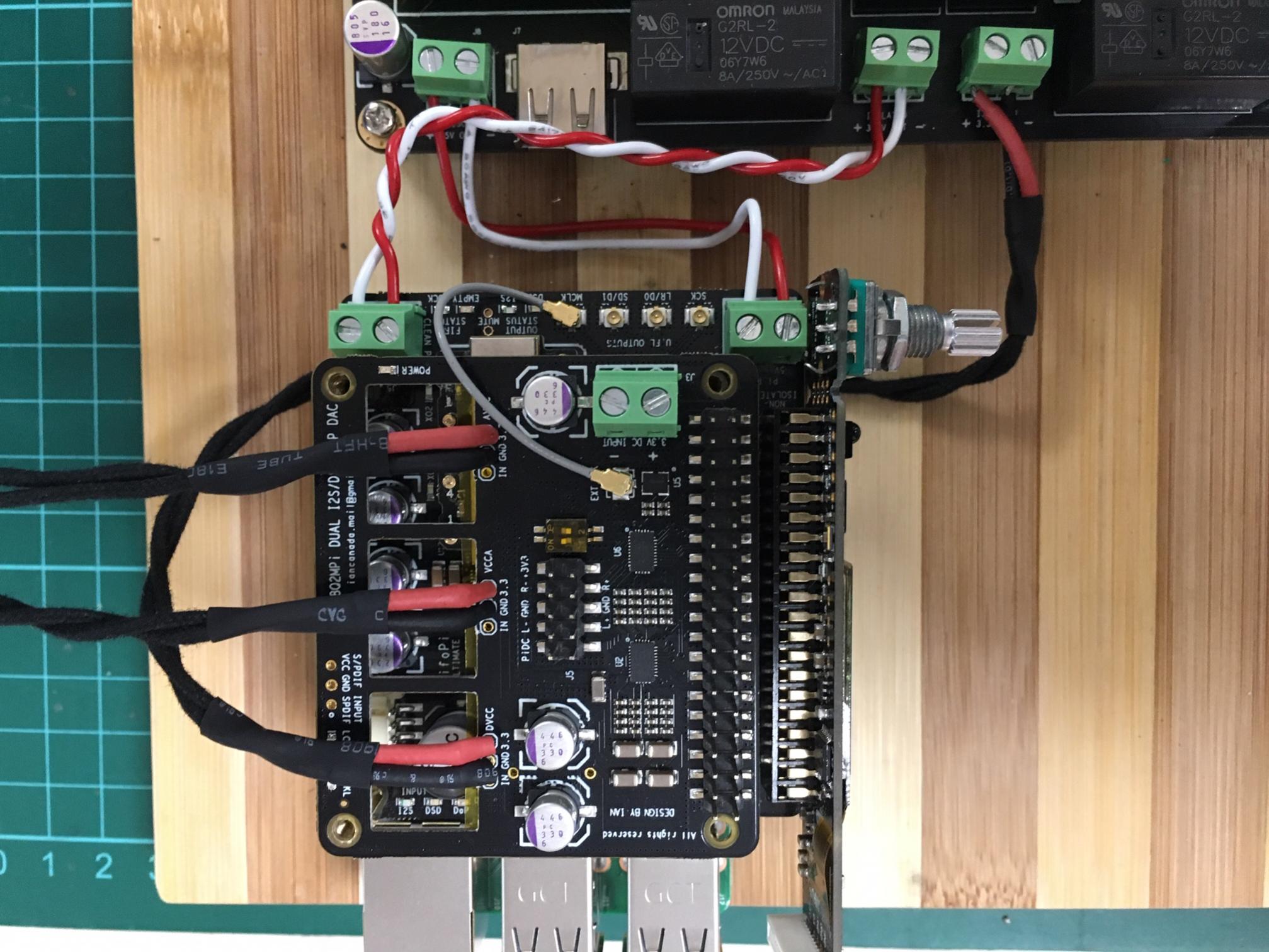

Thanks Jacklee. I completely removed the capacitor boards. Will double check the wiring.
LOCKL & LOCKR LEDs are lit up red.
In the manual: On Indicates... LOCKL - Left ES9038Q2M DAC U2 is locked to input music signals. Same for LOCKR.
LEDs are red
I've been looking for a photo of them lit up. They light up after I start a song, but no music.

Are you using the HiFi Berry dac driver, or what driver?
Also, do you have an oscilloscope?
What did you try so far?

I recall the led is green color when locked, not red. Are you using true-sync mode or async mode?
I attached a photo of my setup for your reference.
