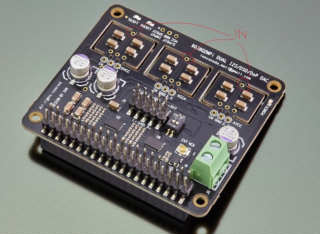

Seems to the easiest and cleanest solution to test/provide separate power rails for DAC with rollback option? Just to confirm, if understood correctly:I will solder pins to the PCB & CAP Cards. Then I'll just cut the 'IN' trace from the PCB & Cap card(s), put a jumper on there, test. Then I can pull that jumper, connect up separate 3.3v and hope for the best!
- Cut the connection only for IN trace between the DAC and daugther boards;
- Solder pins to all the GND and 3.3 holes on DAC side;
- For easy rollback can solder pins to IN holes on both sides;
- Connect separate power rails to soldered pins on GND and 3.3 holes on DAC side, while the daughter cards are still attached and GND/3.3 traces still connected.

For point #1 note that there are two bridges for power IN: one next to the IN mark and the other one at the opposite end, unmarked.
Rollback can also be done by simply connecting the three separate rails to the same battery rail.
I also found leaving the cap mini-board in place sounds better.
Hi jacklee , can you show me where is "bridge at the opposite end"?
See photo below. You can use a DVM to test continuity between that and the input power connector.
