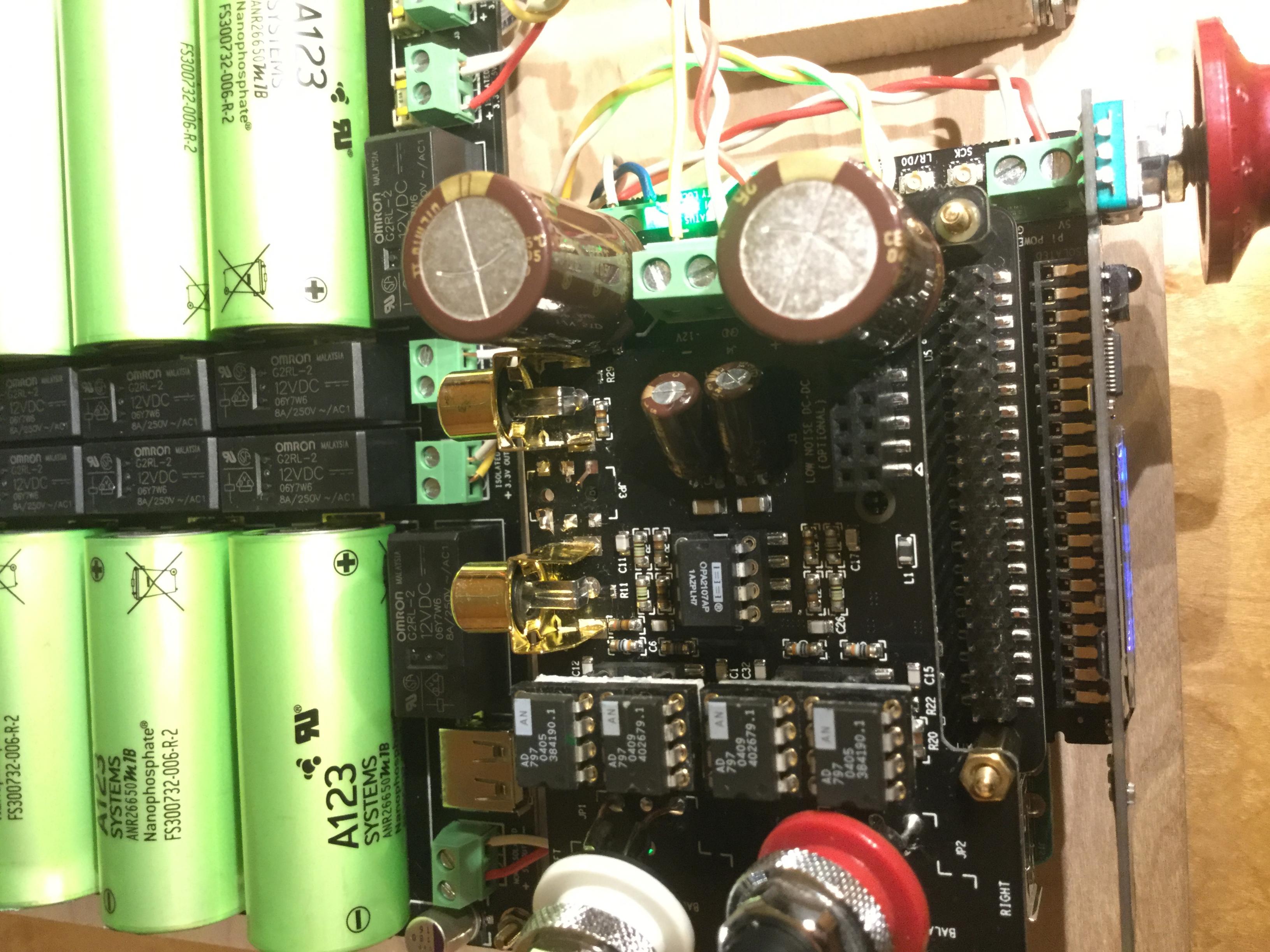

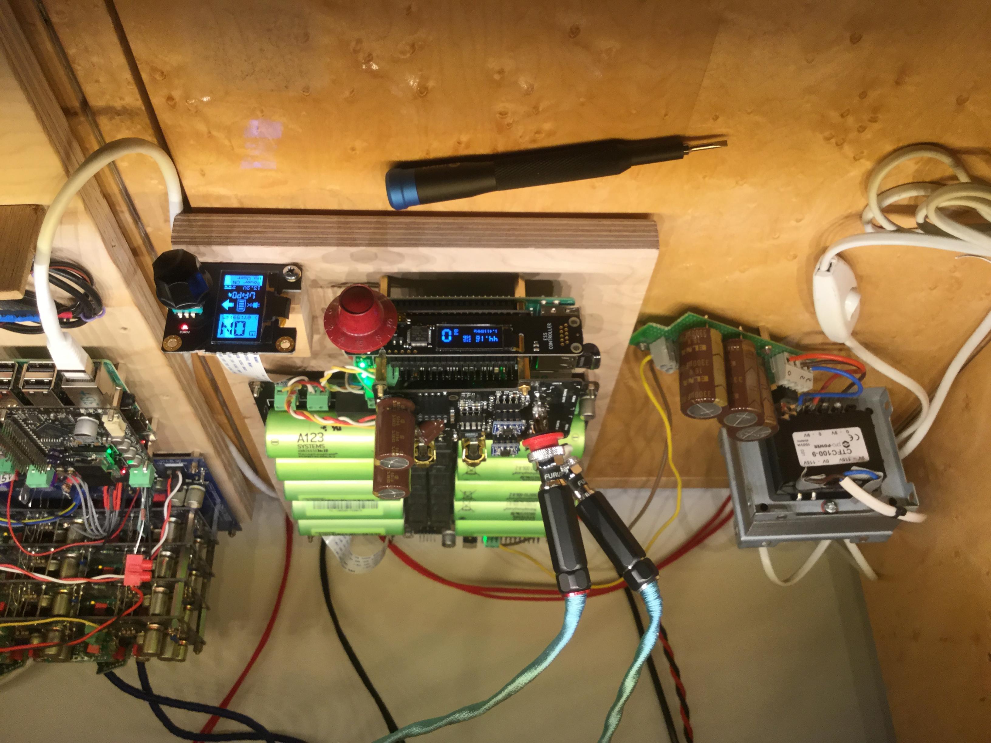

Last week I recieved the sparkos opamps and one broke down during the first day of playing, it got pretty hot! Could this be oscillation? Will it make sence buying another sparkos or will they have the same problem with this design?
What about the burson opamps?
I am now playing with AD797 opamps, using the balanced output (not using the ground) into my tvc volume transformers of my amps.
First impressions are good, more transparant and detailed than the standard opamps.
I also have some OP627 waiting for testing.
On the picture you can also see Elna silmic capacitors on the power supply line.

@sq225917 It's been about two weeks now, in various configurations for testing.@blue, long has the fifopi been running, I've experienced quite some settling in with mine?
I Will follow.Last week I recieved the sparkos opamps and one broke down during the first day of playing, it got pretty hot! Could this be oscillation? Will it make sence buying another sparkos or will they have the same problem with this design?

Can you also share the modifications you did on the board ?

That says it all. Your power supply impedance may be too high for best sound quality with more suitable opamps. AD797 becomes unstable if impedance at HF is too low. Other opamps such as the recommended OPA1612 love low power supply impedance (at HF, not just DC). If you would like to try a passive solution, enough uf in good quality film caps such as Wima mks4 from +15 to ground and from -15v to ground should fix it. You may be able to start hearing some improvement with as little as 15uf per rail. More uf might help more.
Your answer is puzzling: you mention that high ps impedance is not good but also that AD797 is unstable at low ps impedance??
I use the battery ps with A123 batteries so the ps impedance should be fairly low, or not?
The problem I had was with the sparkos opamps not the AD797. I also think that I have discovered the problem; the smps ps was making a lot of static noise, this has probably led to oscillations of the opamp. This noise was apparant through the complete system so I guess ps quality feeding the battery supply is also important!
I am now using a lineair unregulated pc to feed the battery supply.
I have changed the ps capacitors on the iv board for silmic 470uf with 33uf parallel. In my experience elna silmic is one of the best capacitors for analog stages.

At HF, its true. If you look at the AD797 data sheet there is advice about adding resistance to large decoupling caps near the dac chip.
In my own experience, I was using two of AD797 as opamp-based AVCC supplies for ES9038Q2M. Adding some film caps in parallel where the +-15v rails entered the board to power the output stage and AVCC opamps made AD797 go unstable. I could have added a small few ohms of resistance in line with +-15v power for AD797 only, but I just switched the AVCC opamps to OPA1612. Also used OPA1612 for the output stage. Film caps fix some graininess in the sound for all audio opamps other than AD797, and in that case OPA1612 sounds better than AD797 did before adding film caps.
In same vein, people have the exact same issue trying to stabilize AD797 as the error amp in a Jung-Didden regulator. Impedance at HF is too low for it.
Other opamps don't have that same particular sensitivity and sound great with some good quality parallel 10uf film caps filtering the +-15v rails to ground. Silmacs might be good, but if they are not as good as film caps at HF (such as Wima mks4 10uf). A combination of mks4 caps in parallel such as 10+10+22+33 could be one possibility (all values in uf, per rail).
Easiest thing for you to do might be to try it. Put OPA1612's in your output stage and maybe ~50uf of parallel film caps from +15v to ground and -15v to ground (or as much parallel film cap uf you can muster for a test). If the film caps change the sound for the better, and they likely will, then you will have a better sounding dac. If you like the sound and want a lower cost solution, that may be possible too. Please let us know if you decide to give it a try. Some people have reported better sound quality with as little as 15uf of film caps per rail, so try what you can reasonably manage would be my suggestion. You might be happy you did.
