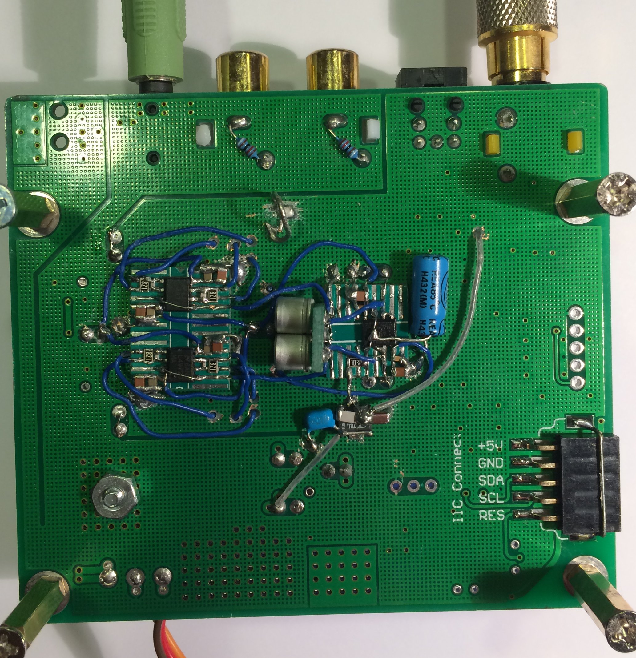

Anyway, I'm thinking of trying an experiment to separate the output stage board from the dac board and maybe do a little bit of RF filtering. Would be interesting to see what happens.

Just put the output stage on an extender cable. Now its starting to sound more like clock problems will be the next thing to look at.
So, you think power quality is the clock issue? Maybe too much lead inductance with the plug-in clock boards?
Also, notice that Vref on the output stage is not set to AVCC/2. Rather it is AVCC/3. Wonder if that might be to reduce the big DC offset currents though the very low resistances around the opamps. Looks like the circuit was optimized more for low noise than for low distortion. May have to come back to that later.

My initial impression is that the extender cable may have reduced some output stage distortion. Picture in earlier post: https://www.diyaudio.com/forums/pc-...essions-tweaks-mods-hints-33.html#post5788176

My initial impression is that the extender cable may have reduced some output stage distortion...
Forgot to mention that folding over and taping the ribbon cable as shown in the picture put the dac +- outputs for each channel next to each other. The capacitance between them may have attenuated some HF junk, which is why I taped the ribbon cable in the position I did. Probably not as good as twisting the +- outputs for each channel together and maybe running the pair next to a ground plane, but my impression was that it helped some. I did not stop to investigate more carefully at this point, however.

*Output stage on ribbon extender to help attenuate RF leakage into output stage
