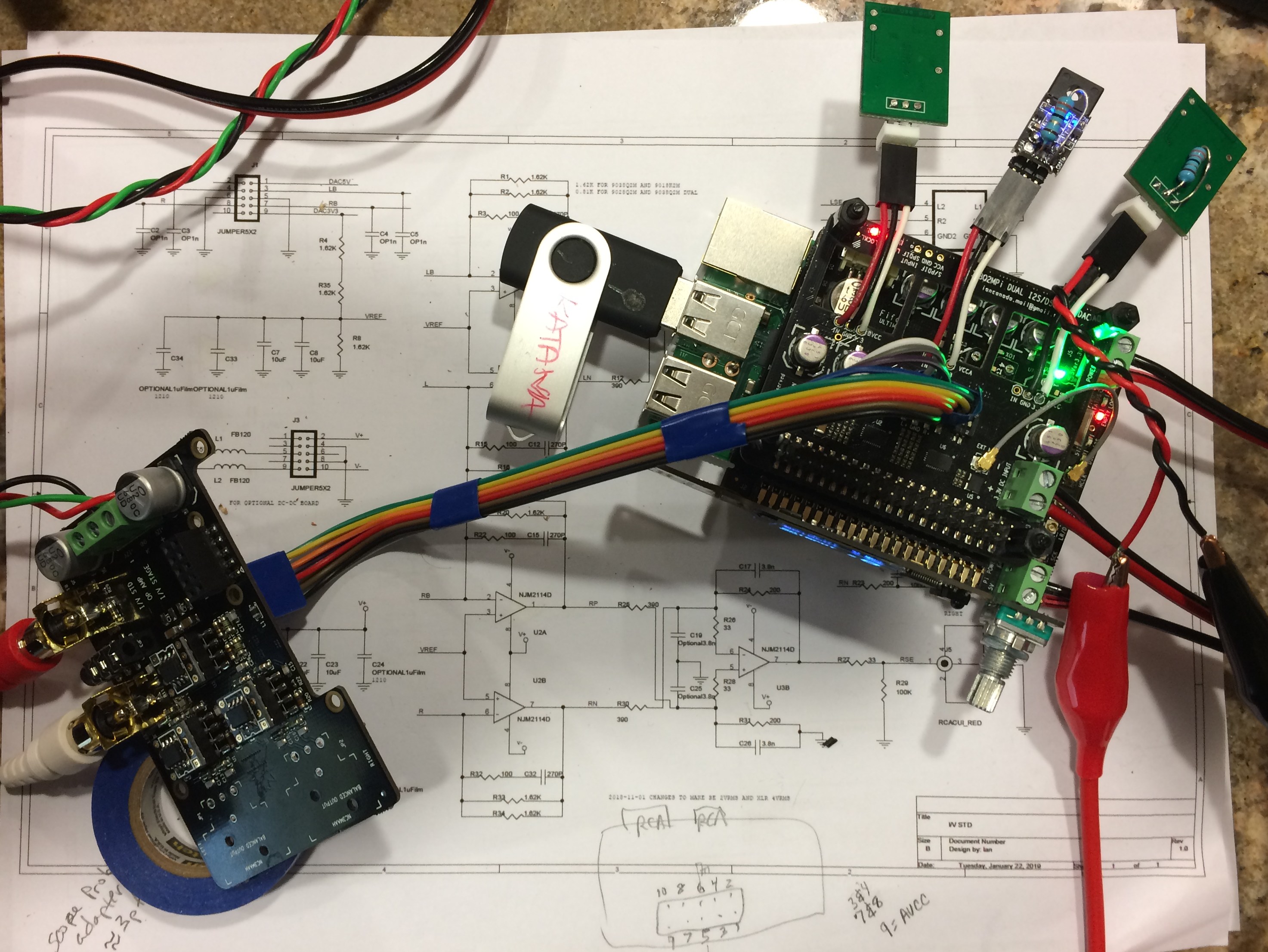

@Greg, any others,
Looks like the dac I2C bus is idle most of the time except when status changes in volumio or when input to Ian's controller occurs. That being the case, it might be very simple to hook up an Arduino to adjust harmonic distortion compensation without disturbing the existing Ian dac controller. I will probably go off and do it on my own because I want the dac to sound as good as it can. If others are interested, we could make it more of a group effort.

...if you send what you prefer there, I'll get another from Ian and build it up to try.
Increasing resistor values would require reducing capacitor values by the same factor, if the same corner frequencies were to be preserved. There are a whole range of possibilities for changes. Usually it is easier to find resistor values than capacitor values, so scaling the caps down in value would probably come first, according to what NPO/COG/SMD_film cap values are available. After that resistors can be scaled up by the same factor.
I would prefer to see resistors that at least limit the loading on any opamp output to not below 600-ohms at any frequency. Higher resistance values should be safe.
Resistor matching between channels is important to minimize distortion, so tighter tolerance parts are better, say, good quality .1% or better thin film resistors.
Regarding noise, it is signal vs noise that matters. Once the signal is up at a reasonable level (say, 1 volt or more), then heroic noise minimization is often much less of a concern.
For a possibly more challenging alternative to re-scaling existing parts values, the output stage design we have been using over in the ES9038Q2M board thread sounds good to at least some people. There might be less loading on the opamps than they can handle, and more noise than the minimum, but you might try that and see what you think (assuming you can patch around the existing board traces for the slightly different topology.
Along with trying at least somewhat larger value resistors, I would be inclined to try changing the Vref divider on the back side of the output stage board so that it produces AVCC/2, rather than AVCC/3. In theory that should be where dac common mode distortion should be the least.

Fitted OPA1612 tonight, that's much better a big improvement. Definitely heading in the right direction now. Clocks and supercaps next.
Just tried the Crystek 957 clocks instead of NDK. Sounds closer to right to me, although still some remaining sound quality problems.
Cleaning up remaining distortion should help a lot. Now it sounds more like IMD rather than jitter, as the bigger problem. The sound seems a bit muffled and jumbled together in the midrange which sounds like a lot of HD/IMD contributing to that. But adding artificial brightness and pseudo-clarity from NDK jitter is not the fix, it just adds another problem.
Harmonic distortion compensation should probably be the next thing to look at. If an FFT shows much in the way of higher than 3rd harmonic, then some hardware troubleshooting would be necessary.
To summarize configuration so far:
*DVCC on ADM7150
*VCCA on ADM7150
*AVCC on NewClassD UWB2 (with 5.7v regulator powering dac board)
*Output stage +-15v using parallel film caps from each rail to ground (10+10+33+33+33, all values uf, Wima mks4)
*Output stage on ribbon extender to help attenuate RF leakage into output stage
*Crystek 957 clocks, rather than NDK.

Also, checked I2S signals on clean 40-pin GPIO bus. Don't know why termination resistors would be needed. Pic of BCLK below.
To follow up a bit on my previous post above: Tried both ADM7150 and UWB2 regulators with 33-ohm load resistors for AVCC. Both sound better that way, or maybe the AVCC circuitry inside the dac likes the 33-ohm resistor there. Either way, it helps improve sound quality.
UWB2 sounds a little softer on the transients than ADM7150, but it also seems a bit more forgiving of distortion (all dac board regulators still supplied with 5.7v in order to bias on UWB2, but not exceed board filter cap voltage rating).
For the next test, I separated the AVCC regulator from dac board 5.7v supply and connected that one regulator to a variable supply. Didn't want to get the regulators too hot since they were both supplying 100ma to the 33-ohm resistors mounted on them, so avoided raising the input voltage very much. Found that both regulators sounded better and SQ was less distorted with regulator input voltage increased to 6.7v. With the input voltage increased, ADM7150 turned out to produce the best SQ, it was both tight and punchy as it should be for the music that was playing, and it also provided for the lowest distortion I have heard so far out of the dac.
I really think its time for harmonic distortion compensation at this point. The dac is getting much closer to producing acceptable SQ for my testing purposes. Depending on how much HD comp. can help, it may be okay to leave the output stage as-is (on the extender cable). Otherwise, the output stage will be the next thing to get attention.
