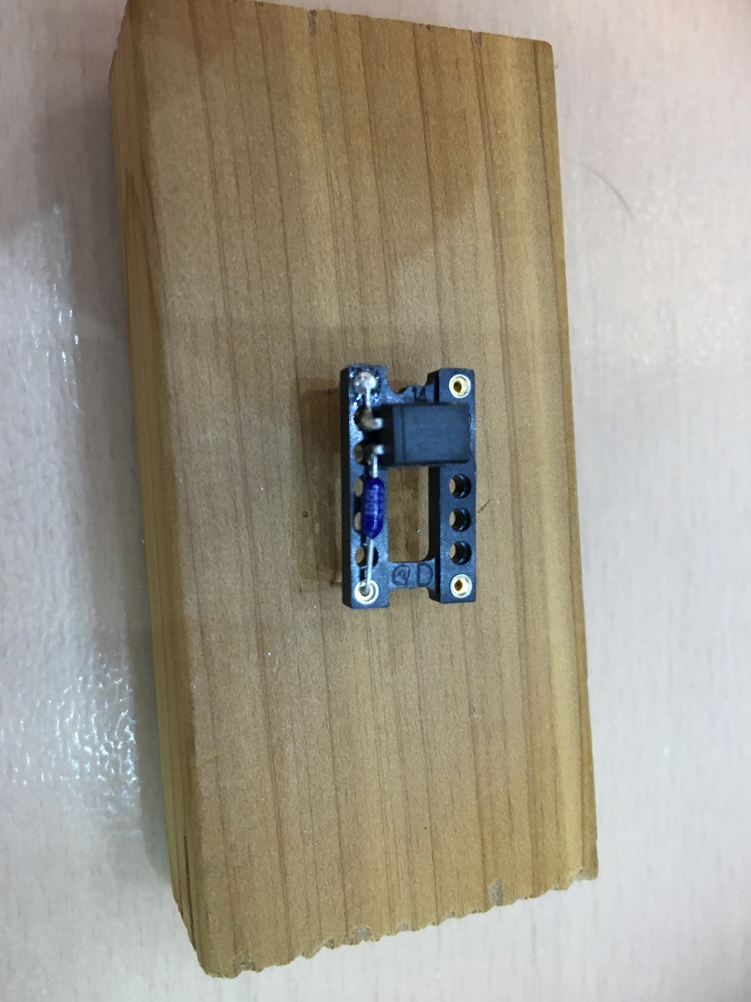

Experiment with Clocks - Part III
I spent the whole day did some more clock-related works. I successfully implemented a dual Neutron Star 2 setup with proper functioning clock-enable-disable features. I hope my experiences will save some time for others doing the same mod.
1. Clock Enable/Disable Feature
Off-the-shelf clocks all support this (except specialized ones like Pulsar Clock) via Pin 1 (ENABLE) and Pin 2 (GND). The fifopi will supply Pin 1 with 3.3V if it wants the clock to run and 0V otherwise.
The NS2 clock has a similar feature, known as "Host" via a Host pad on the board. If the Host pad sees a 3.3V then the NS2 clock will be enabled, and 0V it will be disabled. To use this feature one needs to activate it by removing the solder from the bridge pads known as "Ignore" - which by default are connected such that the NS2 clock ignores the Host pad and run all the time.
There are two ways to make this work. The simpler (and better) circuit idea came from Lars of NewClassD and it works as follows:
I attached a sequence of photos for the build process.

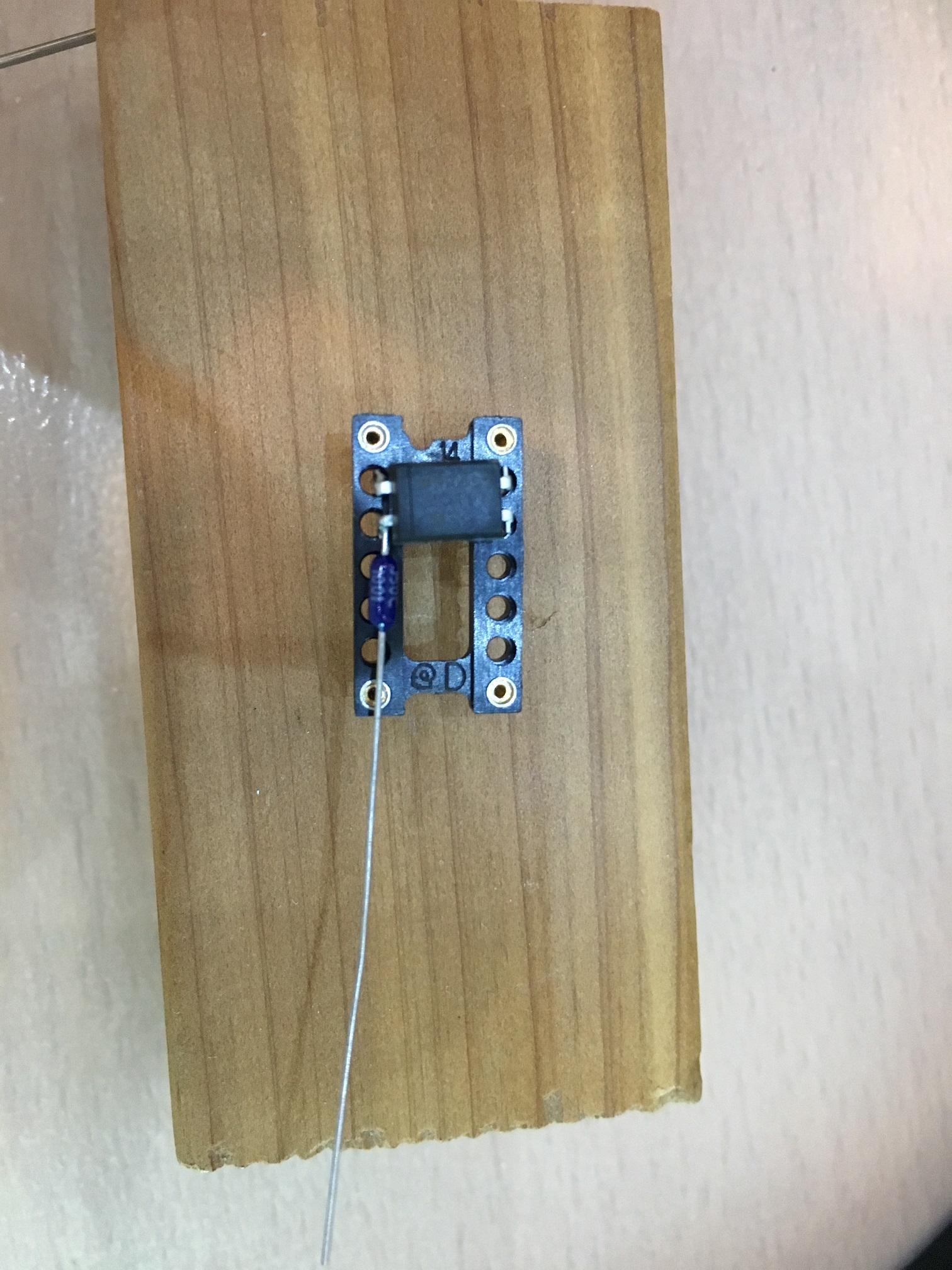

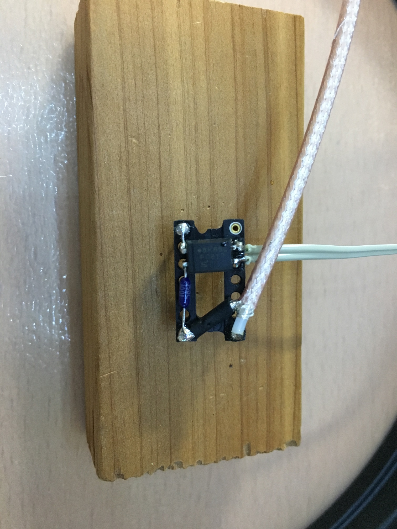

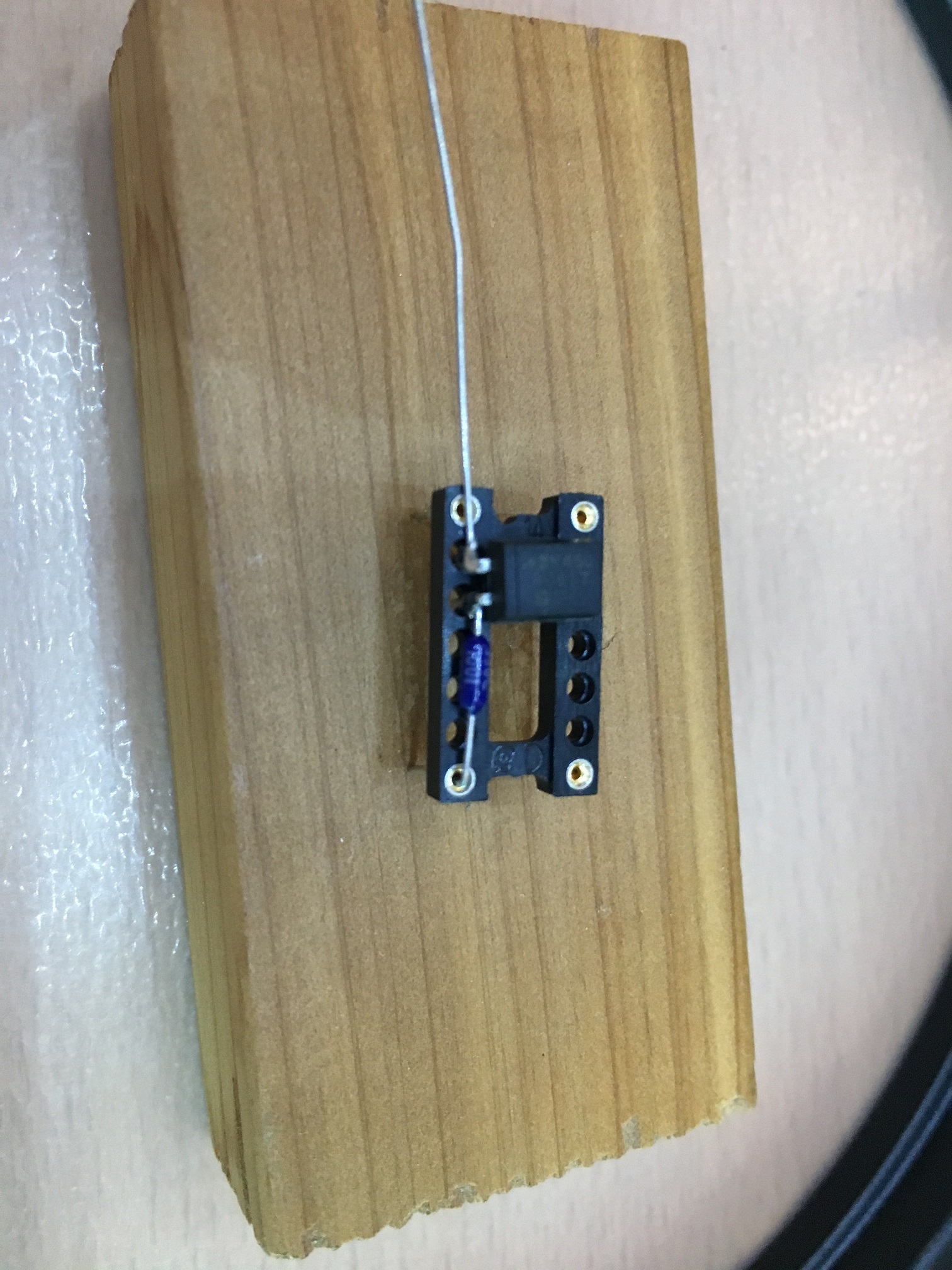

- The Host pad is *not* used.
- The "Ignore" bridges are used as switch to turn on/off the NS2 clock.
- There are two components: an optocouple (e.g., Sharp PC817) and a 1K ohm resistor.
- All components can be installed into an oscillator socket.
- The optocoupler has 4 pins, 2 on each side.
- One side is the input, with Pin 1 connecting to the socket's ENABLE Pin (i.e., also Pin 1); and Pin 2 connecting to the socket's GND Pin (i.e., Pin 2).
- The output side: Pin 3 connects to RIGHT side IGNORE pad and the Pin 4 connects to the LEFT side IGNORE pad on the NS2 board.
- The NS2 clock output connects to the socket's Output (Pin 3) and GND pin (Pin 2).
- Make sure to solder the 3.3V bridge pads on the NS2 as it defaults to 5V output.

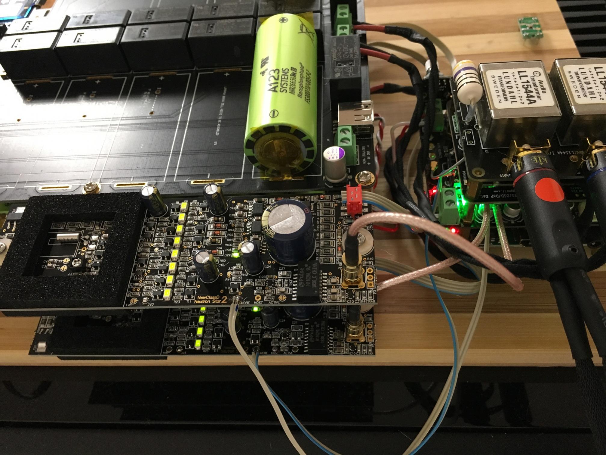

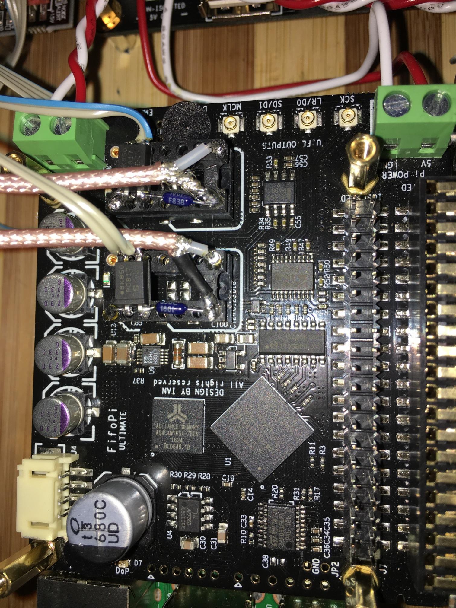

In the process I also found out that:
- There is no mute function in the clock module in fifopi. I attached a scope to one socket's output pins and I can see the clock signals from the other clock if it is running. That means the ENABLE/DISABLE function described above is essential if one wants to use NS2 in dual clocks setup.
- I evaluated the sound using one NS2 clock (45Mhz) and one NDK SDA (49Mhz) in a dual clock setup. My goal is to find out if having a second NDK clock (not running) in place will degrade the sound when using the NS2 clock. My results clearly showed that it does degrade the sound.
- The big question then is whether two NS2 clocks will have the same problem? My initial evaluation is that it does not suffer from the same problem as in the NDK case. Perhaps this is due to the complete isolation of the two clocks. I have not done any extensive listening yet but the initial results are very positive.
Have fun modding clocks!
A couple addendum to the clock mod:
1. Why optocoupler?
Because the alternative is to tie the Host of the NS2 to the ENABLE pin on the fifopi, AND tie their GNDs. This degrades the sound significantly (no better than Crystek IMO) so the optocoupler is introduced to decouple the two systems galvanically.
2. Dual NS2 Boards
The two NS2 clocks are powered by separate battery rails (13.2V). Although I stack them their GNDs are isolated as Nylon studs are used to mount the upper deck.
3. What's next?
If anyone is doing the same mod I recommend to also try connect the optocoupler's input pin 2 to another GND location, e.g., input power GND on the fifopi. The thinking is that there will be (tiny) current flowing from the optocoupler's pin 1 to pin 2 (to drive its internal LED) where pin 2 is also the clock signal GND. Separating the two may provide even further benefits.
1. Why optocoupler?
2. Dual NS2 Boards
3. What's next?
