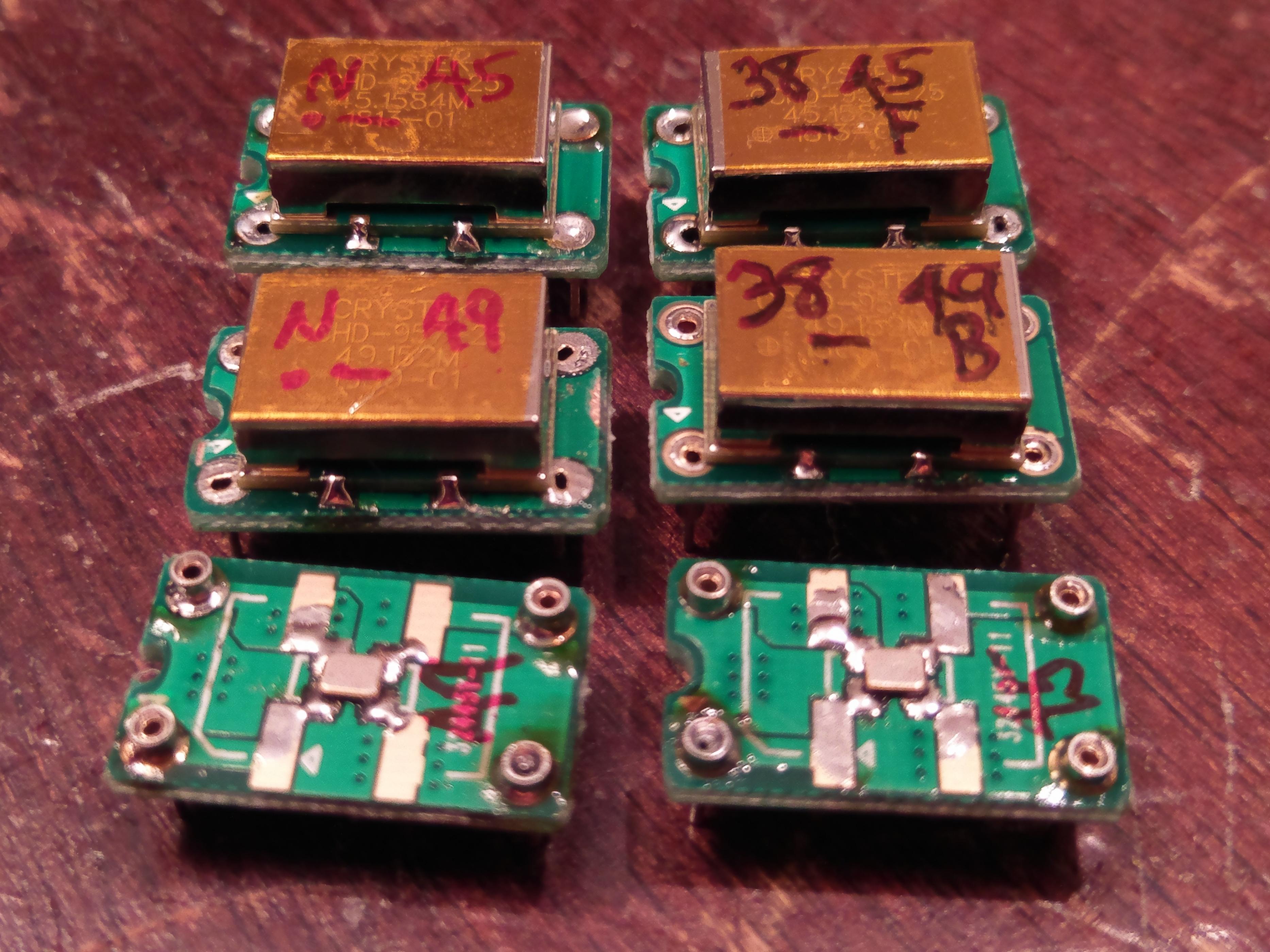

P.S. After some initial excitement with NDK SDAs, I'm back to Crysteks. I have assembled a few other options to try including a 22/24 Crystek pair and a pair of selected 90/98 NDK SA's I got from Acko a few years back. That doesn't mean I've given up on NDK SDAs... just that with the setups I'm running right now, I'm getting better results from the Crysteks.
I'm planning to wait and hear what others report on the clock bypass C front before jumping into that myself.
I also attached some pix of how I use remnants of the PC board from the adapters to space them as I cut (needed only for Crysteks on the original adapters) and solder the pins into the adapters. For the Crysteks on the original adapters, I first add the bypass Cs, then cut and solder the pins, and solder the clocks on last. On the newer adapters or any other clocks on the original ones, I do the C's first, then the clocks, and finally the pins.

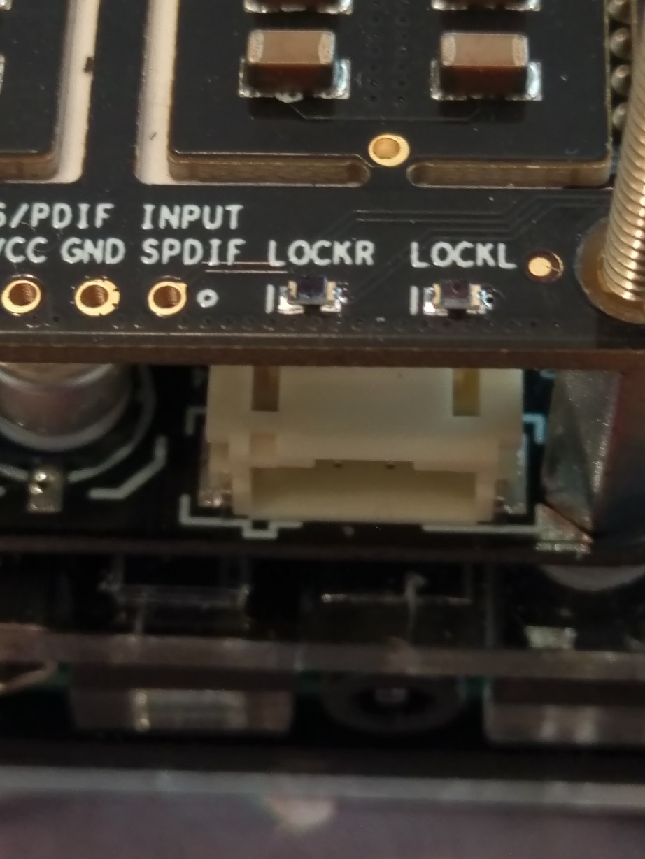

1st, as someone else (@wlowes?) mentioned, I like how Ian has implemented LEDs to signal various operational and error status. BUT if you use his GB gear in a darkened room (like my downstairs bedroom setup), they can be VERY bright. I solve this by coloring them with a permanent magic marker (Sharpie brand here in the US). If you need them darker, use a paint-marker. See attached picture

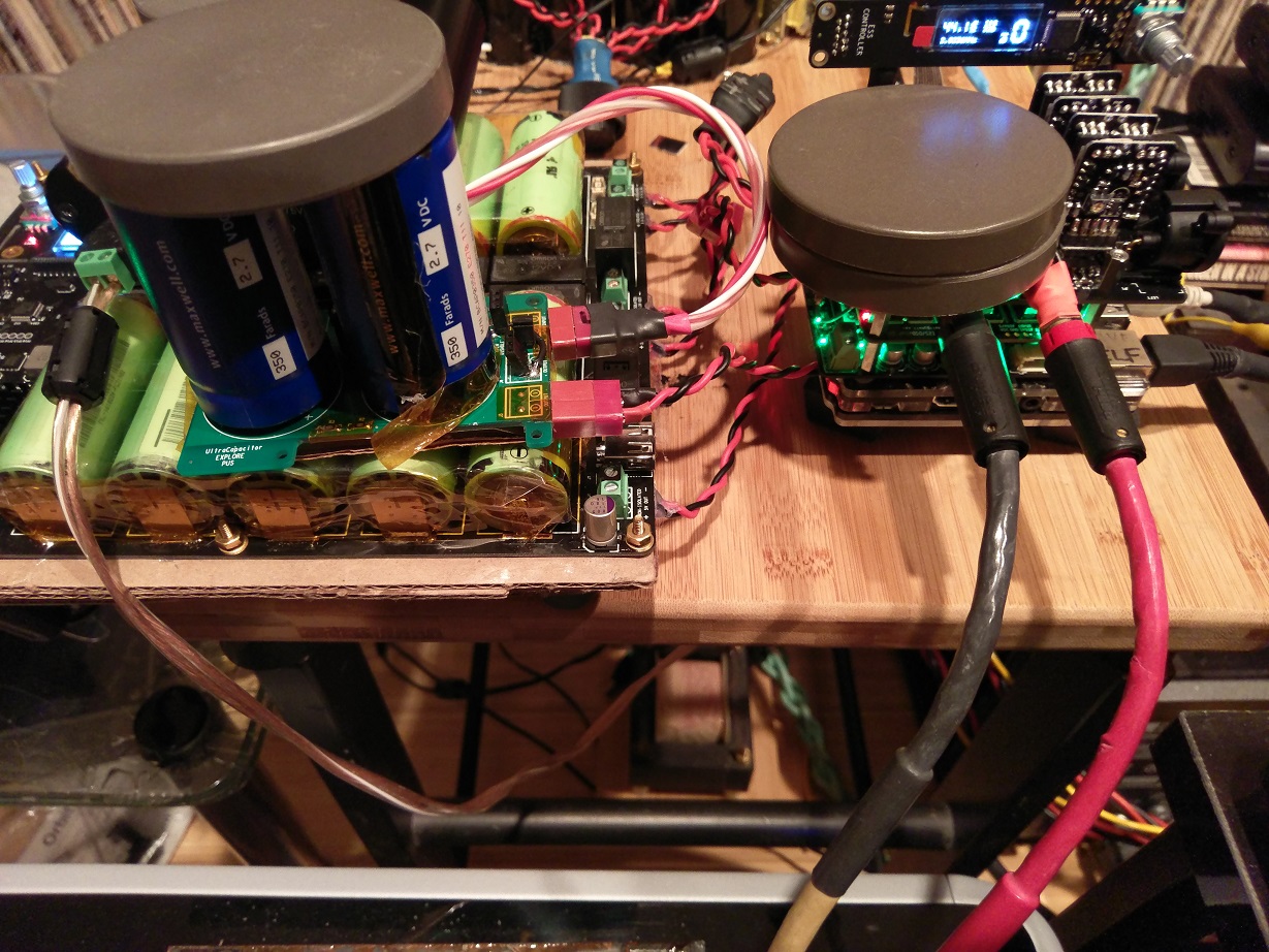

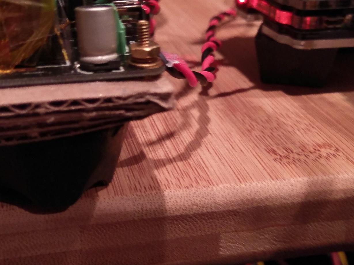

8th, some have discussed various schemes to control vibrations on the RPi->FiFoPi->DAC->output stage stack. I do this too with several techniques. First, the bottom portion of the stack is assembled with long brass screws (4-40 sized because that's the closest US equivalent) and brass spacers, tying it all together into a single coupled unit. More brass spacers fit on this stack, then I use shorter brass screws in the front and the longer brass-screw/spacer combo that holds the ESS Controller in the back.
Then I place the stack on compliant feet (I use some from Herbie's Audio) and place some weights on the stack (also Herbie's). The LiFePO4 supply is also on compliant feet (EAR here). All are on a bamboo board (where my standard AC supplies are mounted) and that is on compliant feed (also EAR) on a light rigid stand (Linn/Naim-ish).
I do this type of thing for all of my setups, RPi or otherwise, although the feet, weights, bases, and stands may be different depending on the application. See attached pictures.
