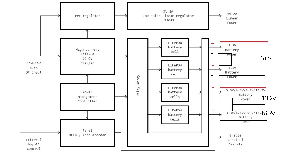

hello ian
question about lifepo4 power, i need one 6.6v and +/- 13.2v, can i connect like this?
