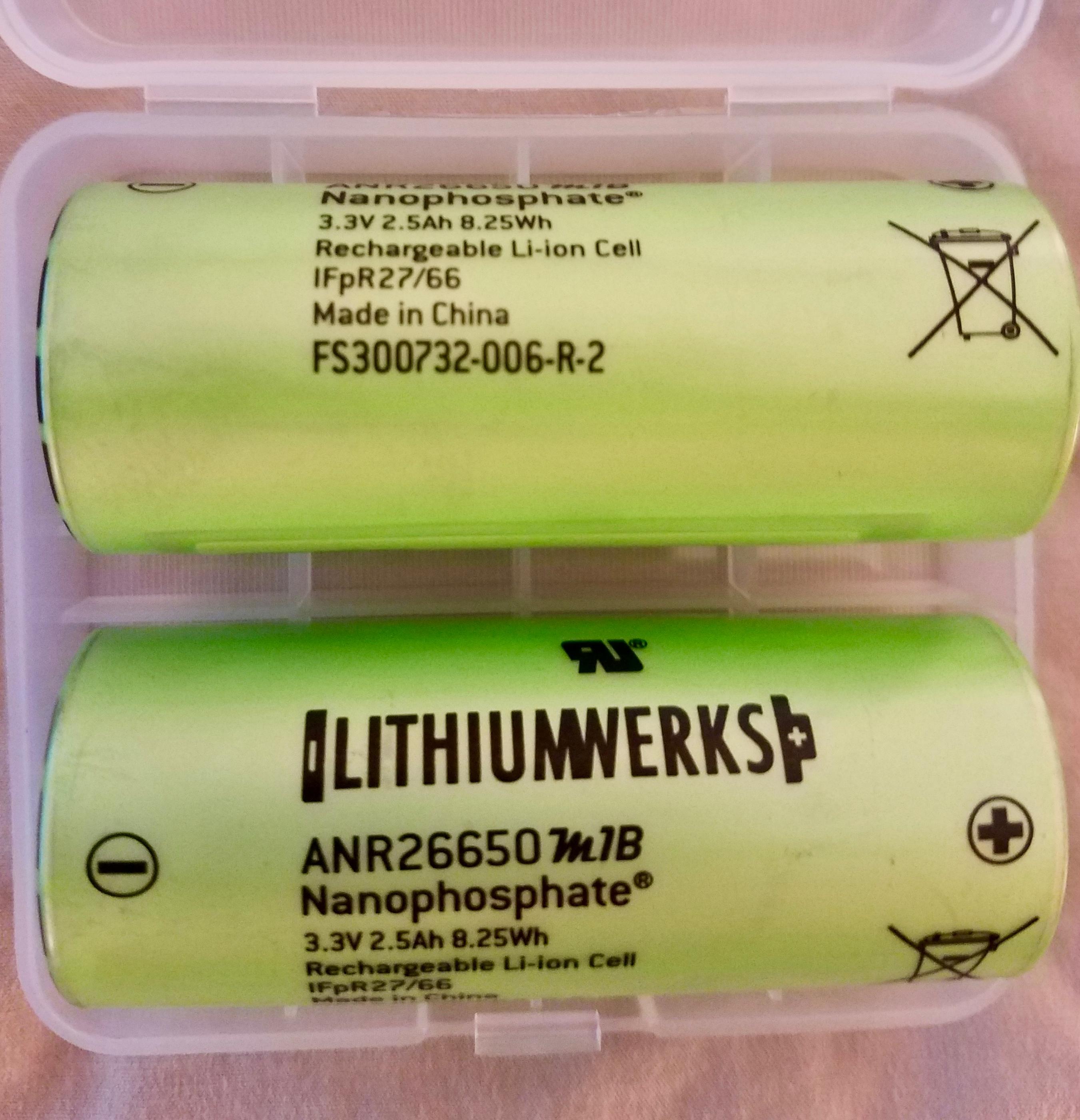

I purchased my 26650 A123 batteries from NKON. It took a little over three weeks for delivery in North America from the Netherlands. They do not do the actual shipping via Fedex for some reason but transfer the batteries to a company in Germany to do that. They are reliable and do respond to emails promptly. If you are not in a hurry ...
At NKON the marking "Nanophosphate® FS300732-005-R-2" is troubling.
New marking ?
nounouchet
I would say no problem there, the pieces I got from Battery Space (aka AA Portable Power) in California have nearly identical markings (-006-R-2) and they are genuine.
More recently I ordered a 2nd set from A123Batteries.com (aka StorTronics) in Michigan and those came with LithiumWerks branding, but are otherwise identical looking and measuring.
LithiumWerks acquired both Valence Technology, and A123 Industrial in Feb/Mar. 2018, so moving forward as stocks are depleted/replaced we will probably see only that branding at some point, depending on where in the world you actually live and/or how they choose to market these cells in any particular area.

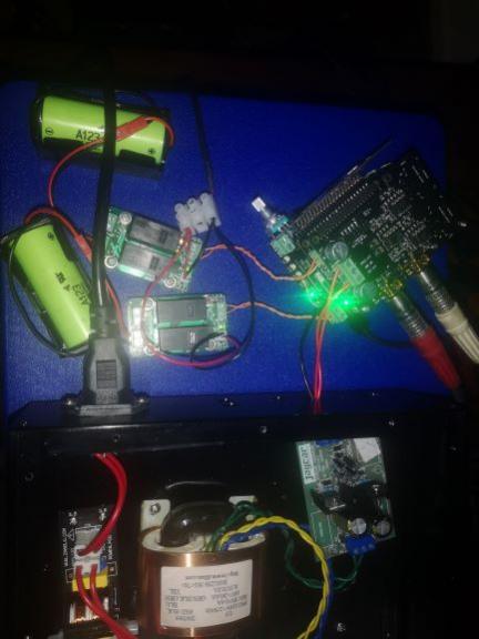

did a quick setup of the fifopi and 9038Q2MPi Dual Mono in sync mode with NDK SDA clock, power supplies for fifiopi and 9038q2mi with the very first battery management board ,lm317,lm337 +/- voltage regulator for output stage.
everything work, and sound very nice. can't wait to setup the battery management mkii later. thanks ian for your hard work

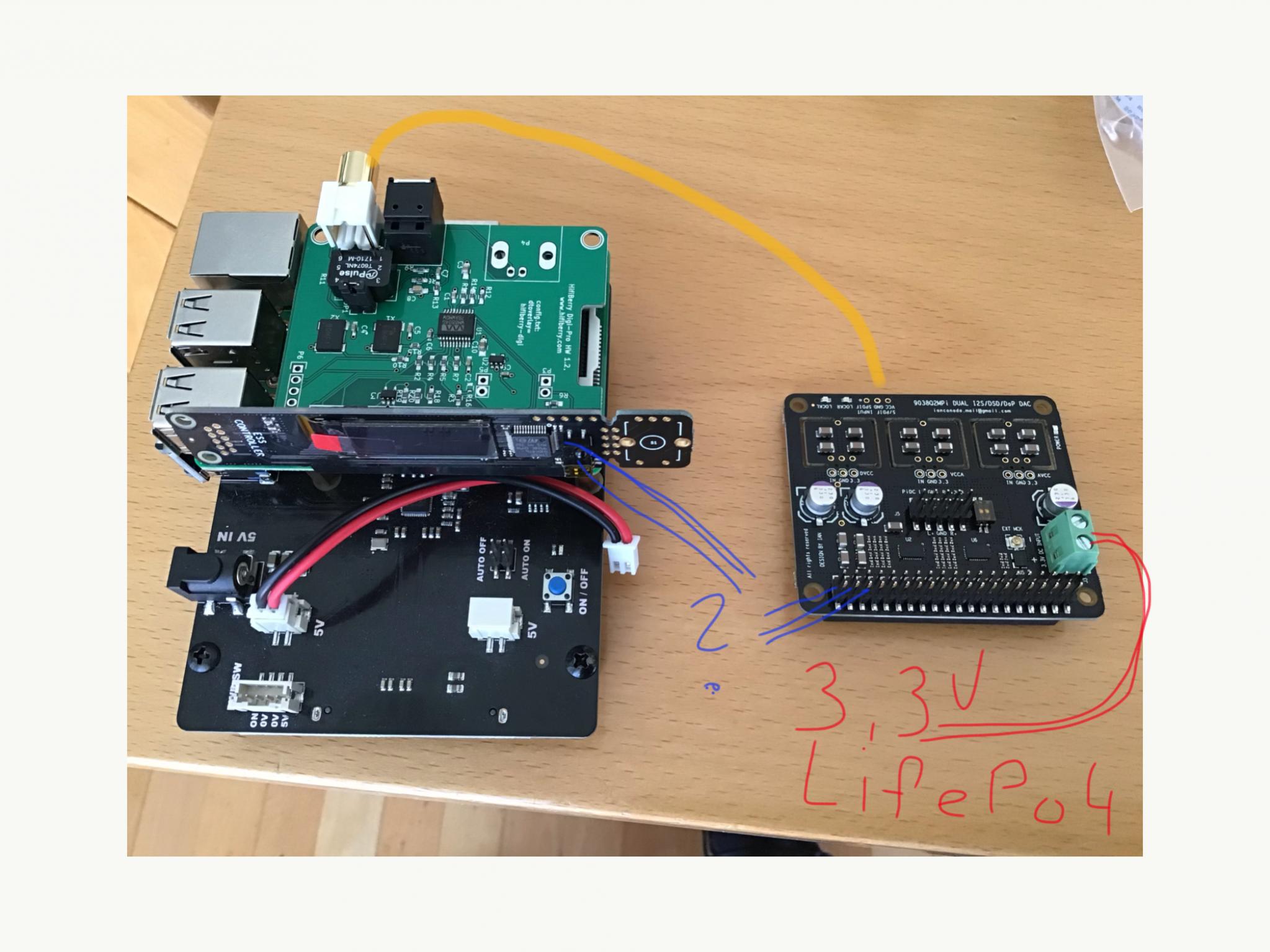

Hello, I have three questions
1. I would like to connect the Dual ES9038 over the HiFiBerry DAC + Pro with spdif (galvanic isolation) power supply is 1x 3.3V. Does the dac still need other connection to the PI?
2nd sound difference: Exchange clock on the dual ES9038 with Crystec CCHD 100mHz, to FifiPi with standard clock?
3. what connection lines do i need! ESS controller is installed on Pi, because of (galvanic isolation), to external dual ES9038

The controller talks to the DAC via i2c so you need to connect the i2c lines from the controller to the DAC which kills your galvanic isolation. Or you can connect the controller to the DAC instead but then the controller could introduce some noise.
Just dump the hifiberry and get the FifoPi and two good clocks for it.
