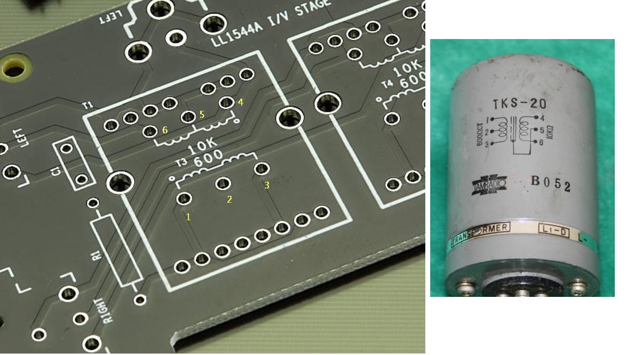

Do
anyone know how to connect it?
i tried but very little sound coming out, the ess controller i already set to 0db.
The tamura does not have a center tap on output so You will not be able to run differential.
You can connect same numbers. Only 5 must not be connected to 5 but to ground on pcb (or left floating)
Probably better to let 2 loose as well, I do not know how it is routed on pcb.
Tamura is very nice stuff!
