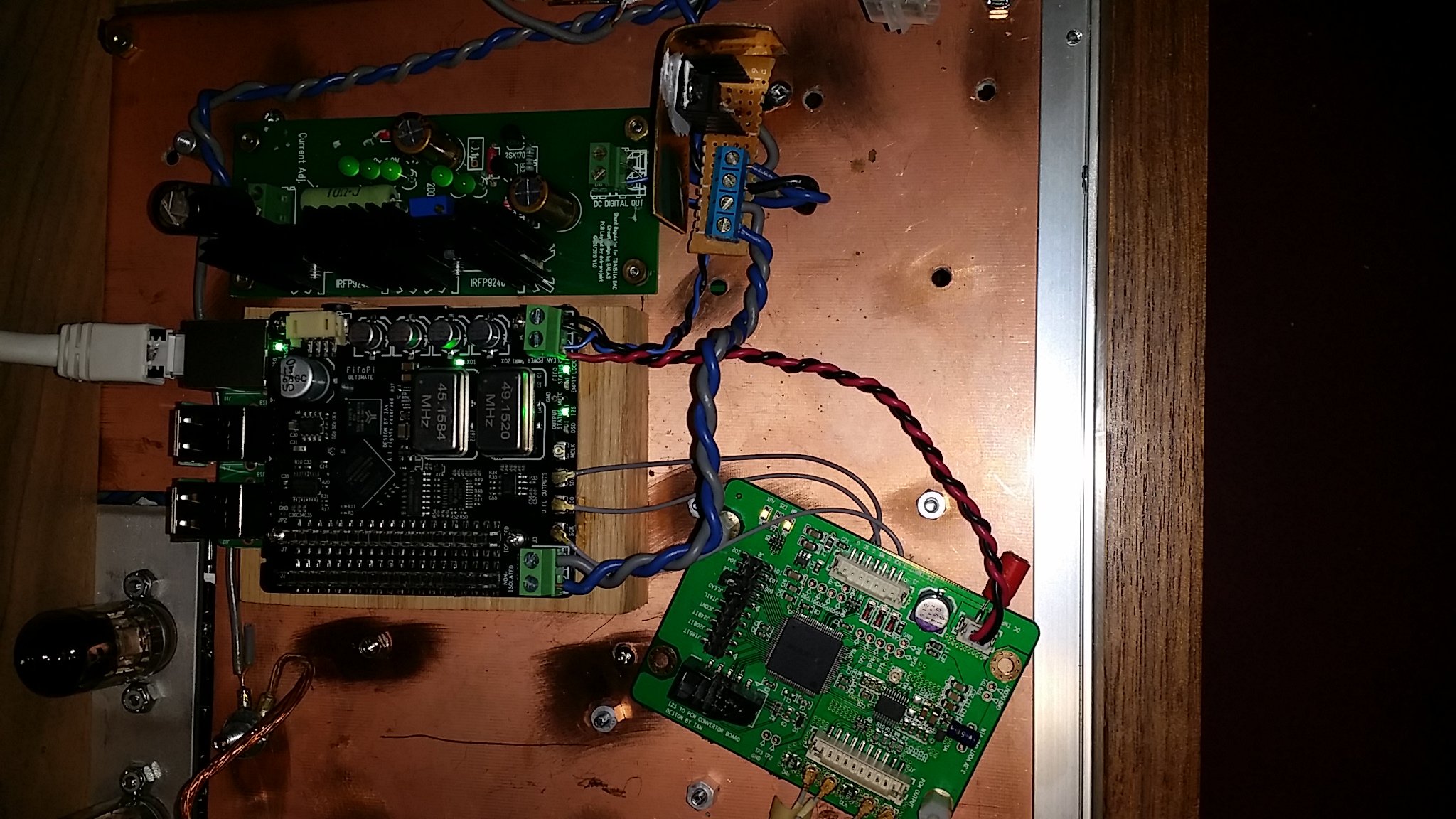

hello all, i received all the boards !!!
i´m going to upgrade the stock clocks on fifopi, i have the ians dual 9038 dac and planing to run in synchronous mode.
the stock clocks are 45.1584/49.1520 MHz.
Should i buy CCHD-957 crystek 45.1584/49.1520 MHz or other frequencies??
what is the best sound quality?
thks,
Nuno
thks,
Nuno

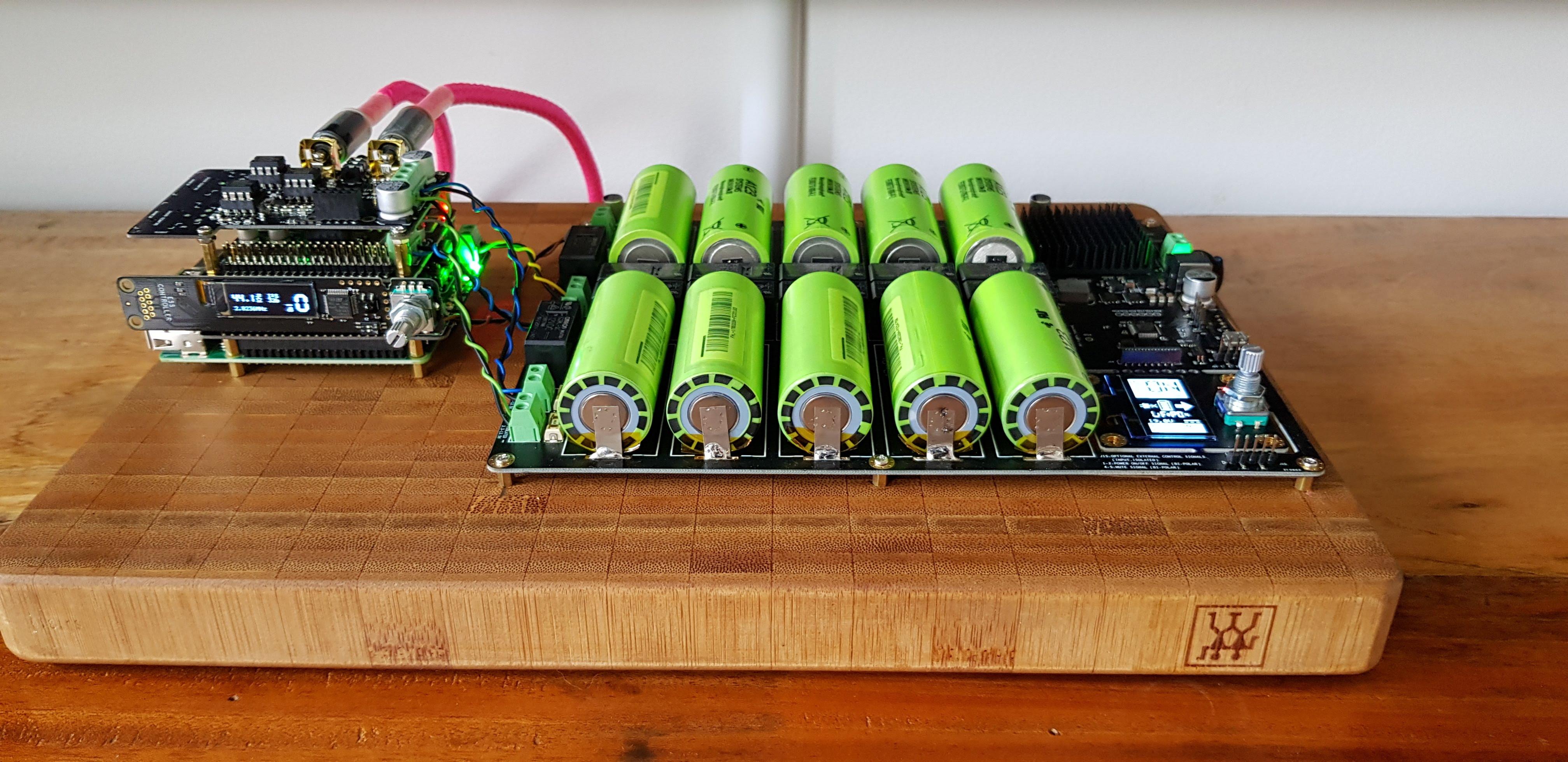

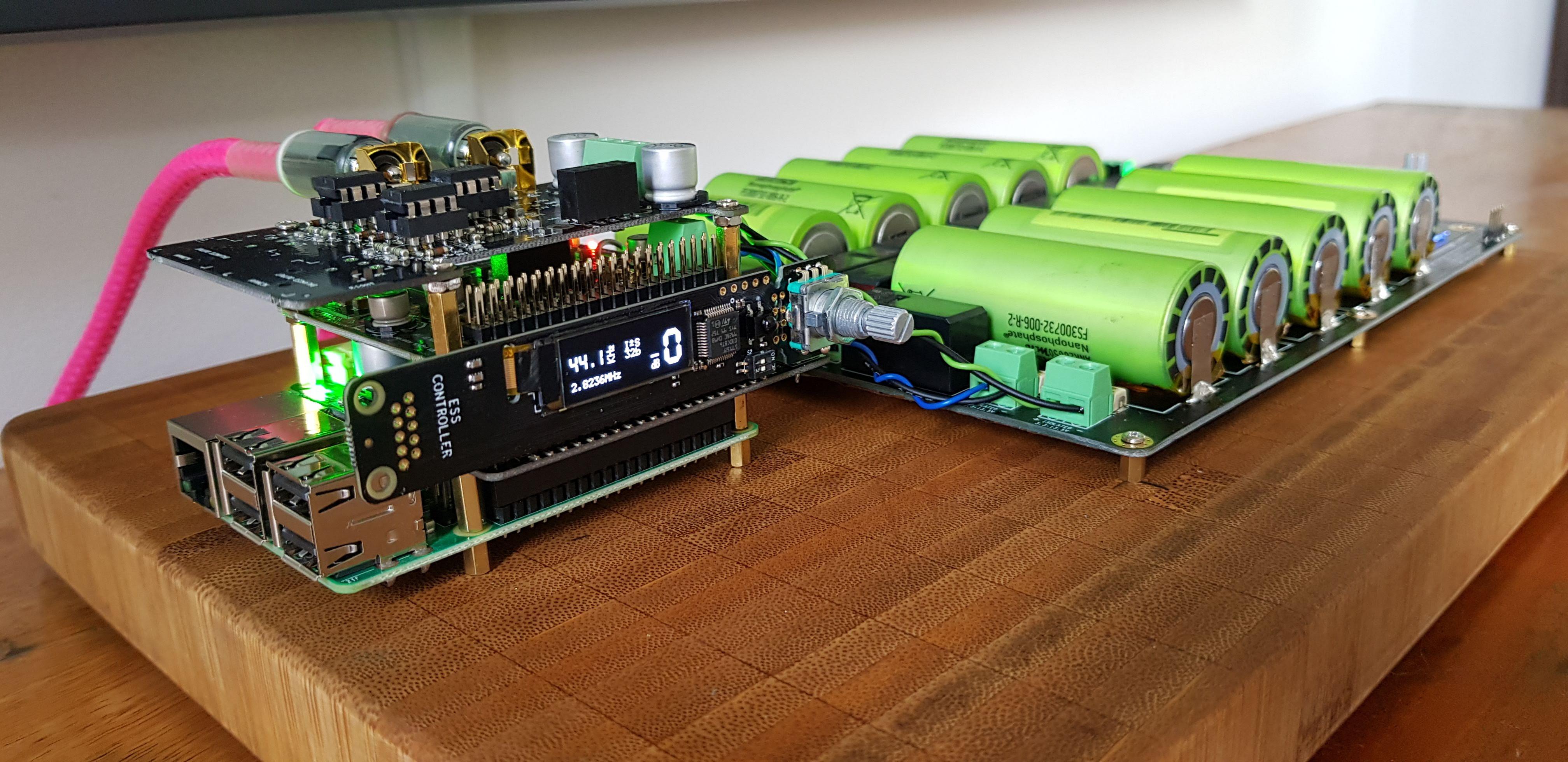

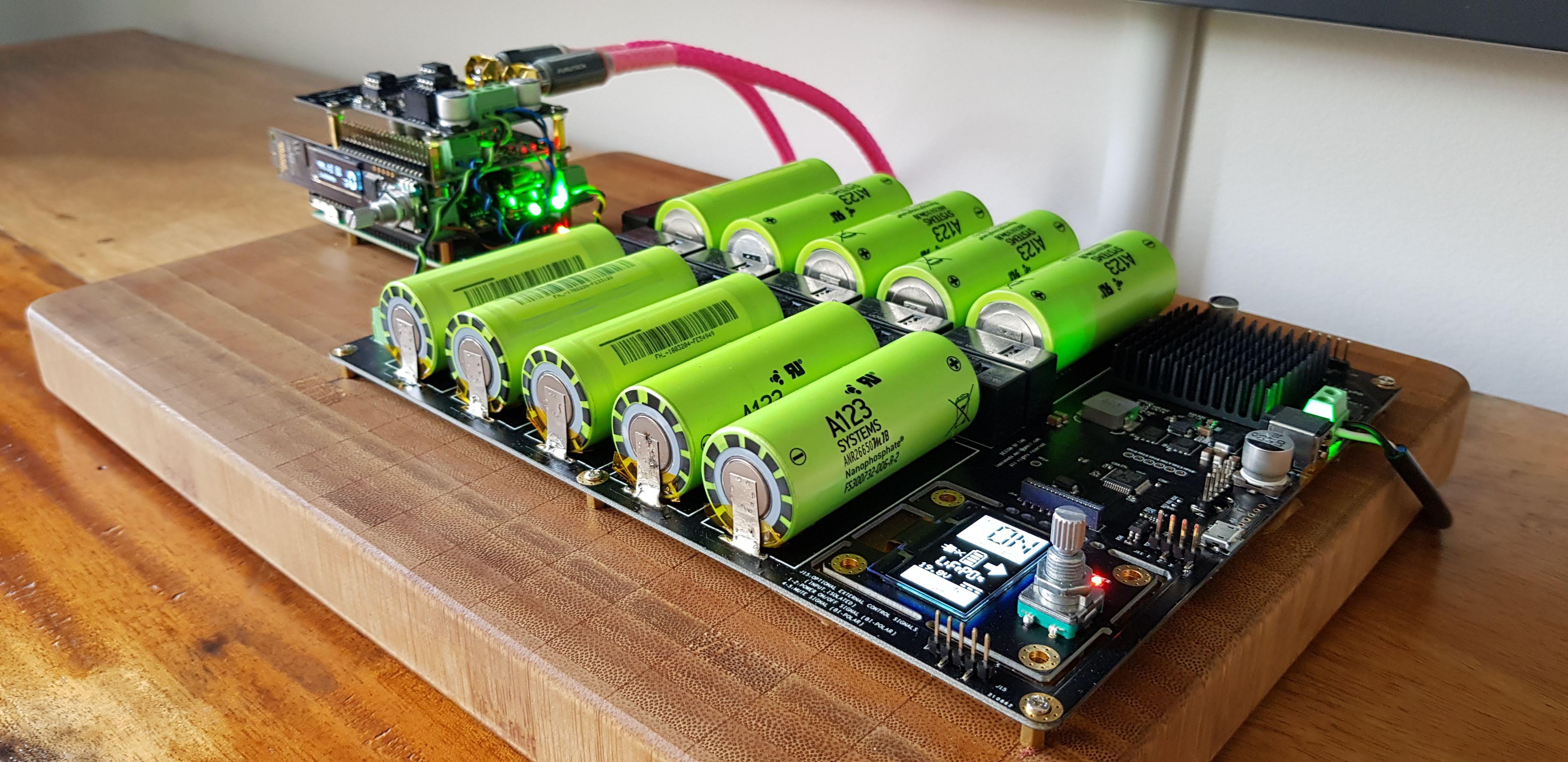

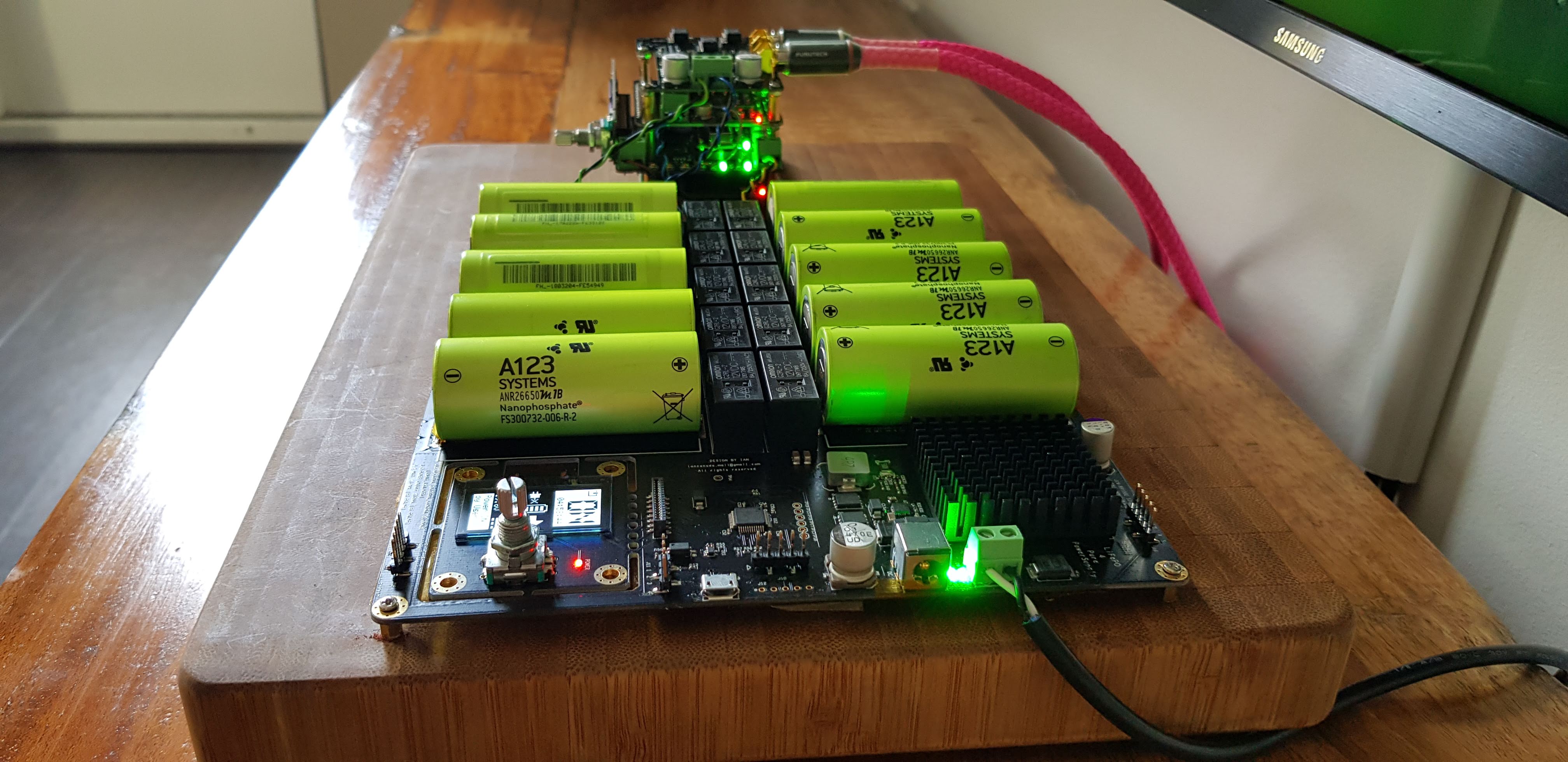

Result
Got my setup running for over a week now and it's an overall BIG update!
I was looking for a setup that could bring more details in the midd audiostage. And it did! Even better, from highest to the lowest tones, everything sounds brighter, tighter and more alive.
My setup:
LifeP04 - Rpi - FifoPi + Crystek CCHD-957 - ESS Controller - ES9038Q2M DAC HAT - STD OPA outputstage + Burr Brown OPA2134PA opamps
Added some pictures just for showing off
My setup:

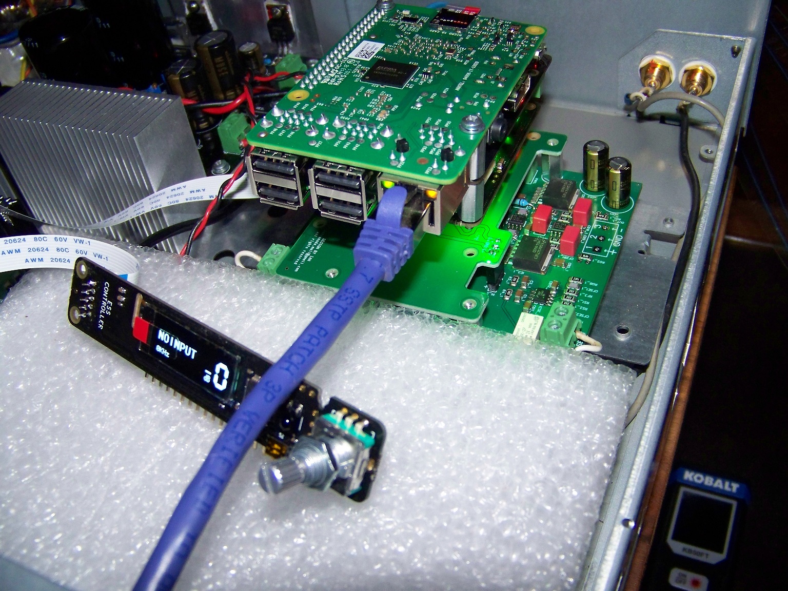

I have lift-off! Beautiful music. I had two different orders with Ian and the 2nd package showed up yesterday. After meticulously getting my PSUs sorted out and the necessary voltages I needed for each, I started stacking everything together. For now, I'm simply using a single 3.3v supply to the DAC, but may decide to break out the 3 sections at a later time. I also decided - for now - to go with the default I/V stage opamps. While running on my bench, they do seem rather warm to the touch though. Is that normal? For now - just to get everything up and running quickly, I'm using a micro-USB for the pi power. Presently I'm using a multi-tap r-core tranny with a couple of regulator boards from DIYINHK for the required 5.0 and 3.3 voltages. I need to order one more for the I/V stage.
After getting everything stacked properly and double checking the polarity of all connections, I booted up the RPi and then the FiFo/DAC/ESS Cntrl/Output PCBs. Next was to configure RoPieee (roon) for a HiFiBerry DAC. No music! Say what? After re-reading the manuals (Great job on the docs. Thanks Ian & Greg), I noticed that I needed to switch #1 on the FiFo to on. I think this is also a configuration option I can change in roon. Once I changed the switch setting, assembled everything and the music flowed. Listening to it now as I type this.
Next step is to replace the clocks and try the OPA1612/22 opamps on the adapters. I guess I'll have to try my hand again at SMD soldering. I also want to try the ultra caps (@Greg - thanks for the link.)
All I can say is thanks to Ian for bringing this project (relatively affordable) to life and making it available to the DIY community. It is very configurable and extendable with minimum amount of hassle. Lots of options for upgrading.
Thanks again. Off to do more listening.
Oh, the Apple remote compatibility is a nice touch and extra. I had one one hand. 🙂

@Maui
Very well built/finished system. Better than mine😀. Congratulations!
If it is possible, try the balanced output. Because my main system is balanced, so my gears are more optimized to balanced output.
Or, try transformer I/V stage, or my later on OPA861 I/V stage. I'm looking forward to your new update.
BTW, I like your hard wood base, the brand is similar to something in our kitchen, .... the knife😀
You took very good pictures, what the lens did you use?
Ian
Thx Ian, it took a lot of patience to line it all up this tight but I am very happy with the result. Next step is to cover it all up with some kind of transparent cover, just to keep dust and kids out. Not sure yet how to do this, bit worried about head building up inside.
I sadly cannot try the balanced output because my amp has no balanced input. The transformer IV stage is waiting for a bit more budget. It will be the next update, but I find the transformers a bit expensive for now. 😱
You're right about the knife brand, makes a nice base don't you think 🙂
About the pictures & lens... I made a few quick pics with my phone (samsung S8). They came out better then I expected 😀
