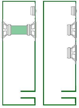

3 choices of basic topology. Pluses & minuses anyone?
Note: T is shown above the M, but could as easily be below. Also no internal partitions shown. Andy's idea of loading the drivers differently will have benefits in the midrange. I'd be trying to figure out how to make these work in a TL (or Voigt Pipe).

I think we will go with the TMM 2.5 like you suggest…
really? how?
-andy
[i am andy, he is Andy. Just to clear that up]
I was under the impression that this would be a vented enclosure...that is what Vifa suggests... I have no problem going with a sealed enclosure but I would like to know why we are going ageist manufacture suggestions...
I like the idea of having the woofers back to back like in the first picture...is their any benefit to doing this...and would I have to bind the speakers together? As shown in the diagram?
All these are questions I have and I was originally thought of a vented enclosure...why is this a bad idea?
note: i also like the config in the second pic...straight line...tmm

Both.
The P17 that will be doing bass & midrange should be in a sealed enclosure. This improves its transient response, but more importantly it keeps the excursion down reducing midrange distortion. (this could also be an aperiodic enclosure)
The other P17 won't have to do midrange so we can make it work a little bit harder and tune it to extend the bass as far down as we can, hence the EBS (extended bass shelf) ported enclosure.
With this scheme we also play into the natural tendency of a room to lift the low bass.
The extra brace (aka cabinet partition) doesn't hurt either.

Slice, you should be warned, that in a .5 way, phase misalignment within a significant range will be prominent during the attenuation of the .5 speaker, as it blends to reinforce it's counterpart. The main woofer will remain at a relatively constant angle, as the .5 unit's angle shfits and the two signals are no longer coherent for as long as the .5 has any significant output, relative to the reference level of both drivers. This affects the subjective 'clarity' of the speaker system in that range.
I saw another recommendation, to mix a sealed and ported enclosure.....this will also result in phase error, as the phase angle of the sealed woofer will shift 180 degrees from the bass output of the ported woofer output eventually, however these will be even much more noticable than the errors that occur during .5 transition if implemented with like alignments for both woofers. The brain is very sensitive to phase distortions such as this in low frequencies, and the early rolloff of the sealed alignment will cause subjective 'muddiness' over much of the low frequency range that the ported enclosure extends too. Besides, careful ported alignment can yield like results as a sealed in midbass/midrange, as long at tuning is nearly 1 octave or greater below the target frequency you deem to be critical. Near 1 octave or greater, after tuning and signal behaviour is identical to a sealed box. The only problems then, are to eliminate the midrange reflections that will emit from the port, by using a suitable wall lining. Actually, the best results would be yielded if you used the sealed mid enclosure,and ported bass woofer, using a 3 way crossover configuration. This would also significantly reduce IM distortions in the midrange, as well as increase power handling, and you would avoid the nasty phase non linearities that you otherwise have to be content with.
-Chris

I shall design a enclosure similar to the revised pictures planet10 has posted….
I will probly go with the design with all drivers on a single baffle…
I would like to design the enclosure itselfe but could you guys help me out with the volumes of the two compartments…as well as port information for the lower compartment…

BB6 indicates a sealed volume of 4 to 5 litres, (hey, I'm an Aussie , we work metric) for the sealed compartment with about 50% wadding fill (F3=96)
and an extended bass chamber of about 30 litres, tuned to 34Hz with a port of 50mm diam by 125mm long (or 60mm x 185 )
Have fun, will send a possible series x-o if you email me
gradds@iprimus.com.au
Please understand that these are only calculated volumes etc, but BB6 seems to be fairly accurate.

What Chris points out illustrates that there are always compromises to be made when designing a loudspeaker.
The 1st problem is really only an issue in the enclosure with the drivers on the front, in the box with the push-push drivers the output in the problem range of the 2nd (back) driver is in the shadow of the speaker box (any issues with this at all could be eliminated by leaving the 0.5 inductor out and letting the back driver run full-out -- you would have a bi-polar then and would have a differenet set of compromises*).
*(this is actually what i plan to do with 4 of my 16 VIFA P17s -- in a TL inspired ny the TLb)
The 2nd issue won't go away as easily.
Andy -- what sort of Q does that little itty-bitty sealed cabinet give?)
Both of these are directly affected by the width of the cabinet, which is what determines the placement of the 0.5 roll-off. This should be in the region of 4560/cabinet width. I like to push this below 350 Hz which means a cabinet width of 13" or more (with BIG round-overs).

It is -- that is why i asked the Q question of Andy. I'd tend to give the sealed woofer a bit more breathing room and get the Q quite low, so that it is way down by the time it's phase starts to interact with the vented woofer (as i posted earlier i'd tend to actually load this baby aperiodically).
Note: this is all theory to me. I have never built a system we are describing. Andy has much more practical experience with these drivers.
