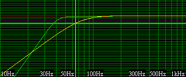

I’ve been playing with winisd and I have come up with this…what do you think…
For the first woofer it will be in a sealed compartment of .4 cubic feet…about 11.3 L
For the second woofer it will be in a vented compartment of 1 cubic feet tuned to 40Hz…about 28 L…
The tweeter doesn’t particularly matter where it goes…
What do you think?
Here is a picture of the frequency response:
Note: lime green=”ported” yellow=”sealed”

The simplest option
Is an MTM about 40L tuned to 38Hz with a vent about 60mm diam x 100mm
no partitions or anything, simple 2 way series x-o recommended.
could go bigger and tune lower, I don't think I would go much larger than 50L though.

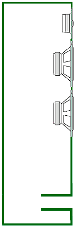

::what ya think of this::
I agree with bostarob that both woofers should be in a 2 cubic foot about 50L +- tuned to 38-40Hz with a port of 3 inches in diameter and about 3 ½-4” inches in length… I think this would be the best for this given situation for simplicity sake.
I think this would be the best bet…
I will start designing this speaker enclosure as soon as I get the feed back from you guys… as for the baffle setup I think I will go with…starting from the top… Tweeter, Woofer, and Woofer… do you think a baffle of ¾” is good?

Like this…

I would recommend...
1" baffle, rest can be 3/4" with a shelf brace or 2 at irregular intervals, and maybe some surface braces in between.
You must brace well and break up the sides and back into different size panels to spread out any resonances.
also try to round the front edges at least 1" radius if you can (more is better)
