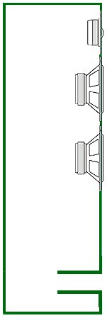

::here is my design::
The enclosure will be as such….
It will be:
40in tall
10in wide
14in deep
This comes to be 2.37 cu. Ft.
I will be adding bracing as well as a 3in in diameter port at 7in long to tune the enclosure to 30hz
After all is done I will have about 2 cu ft. + or –
In other words…close enough for government work…
I think this is enough info to start a XO design…or is it?
The enclosure will look something like this…
thanks,
Slice

put down $30 on loudspeaker design cookbook. Please.
-andy
You'll learn more from it than you ever could from us.
-andy
bostarob said:You'll learn more from it than you ever could from us.
Hey, i resent that...
but it is a very dense collection of information that is essentially loudspeaker building 101 a prerequisite course, and you can take it with you when you have to head off to the "library".
dave
Re: ::here is my design::
This is the concept for the XO. Impedance compensation may be required. Andy will be able to make suggestions wrt L1 & C1. L2's value is a starting point. L1 needs to have very low DCR suggesting a copper foil inductor.
dave
slicemaster101 said:40in tall x 10in wide x 14in deep/3in in diameter port at 7in long
dave
I think it would be very good for the young lad....
..... if he went to my web site, read up on series x-o's, downloaded my 1st order spreadsheet and had a go at it himslef, then posts his suggested values for L1 and C1, he will almost certainly need some L-pad resistors to trim the sensitivity of the tweeter.
I am more than willing to help by verifying his values !!!!

ok i'll give it a try...
to tell you the truth i have no idea where to start with XO but i will read the articals on your web site this weekend... i have finals this week and i dont have the time to read them till then...
NOTE: where did you get that program for laying out speaker designs planet10.... what is it called?
thanks,
Slice

Dave, I did not mean that we do not know the things in the cookbook, I meant that we have got our own lives, while a book's sole purpose is to be read. By no means did I want to belittle your, or anybody elses knowledge...
The crossover design and speaker layout is what I would do, If I were making that speaker. Simplicity at its best, very nice.
Slice, I think you should go with this design, it's a good one!
Agreed, there is no substitute for learning. If the subject of crossovers is alien to you, as it once was to me, you should read the book I suggested.
-andy
-andy
