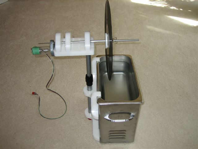

I finally got my ultrasonic cleaner completed. Works great records come out cleaner than ever and are much quieter and i can hear much more detail. Using reverse osmosis water with 2 tbl spoons of AIVS 2nd step cleaning solution ,this is just alcohol and pure water.
The unit has been cut on a cnc machine out of 3/4 in UHMC plastic , don't need 3/4 in. just what we had available. It is made to accept one of these motors http://www.servocity.com/html/3-12v_gear_motors.html just waiting to determine what speed is required. I am rotating at 1 rpm every 5 min but that is too slow and the cleaning solution is drying before one rotation is complete ,cause i was cleaning at 25c this speeds up the drying process. This leaves a little white residue even after cleaning on a record cleaner. I think replacing the water with distilled and increasing the speed of the rotation of the record to prevent drying will cure the problem.

Turbine,
Looks very professional.
Do you have a rubber buffer between the Tub and the top two clamps.
I modded mine. Enlarged the slots on the underside of the clamps to accept a layer of rubber to ensure that the tub vibrations were not impeded by the clamp since on my ultrasonic unit the tub appears to be mounted on a silicone type gasket onto the unit frame.

No Ianmac , i never thought of putting rubber between the top mount and the cleaner , but that is a good idea. Most of the weight sits on the telescoping tube which sits on the table . The end of this tube has a rubber foot on it to prevent the tube from scatching the table.
This design is great cause it turns 90 deg. for storage and also raises and lowers for loading records. I should be able to clean 12 records at once but so far only done 2 at a time.
I have found that my distilled water gets dirty after about 4 or 5 records so i am thinking of a filter system to keep the water clean.

Here is a pic of the mount I made for my Ultrasonic Cleaner.

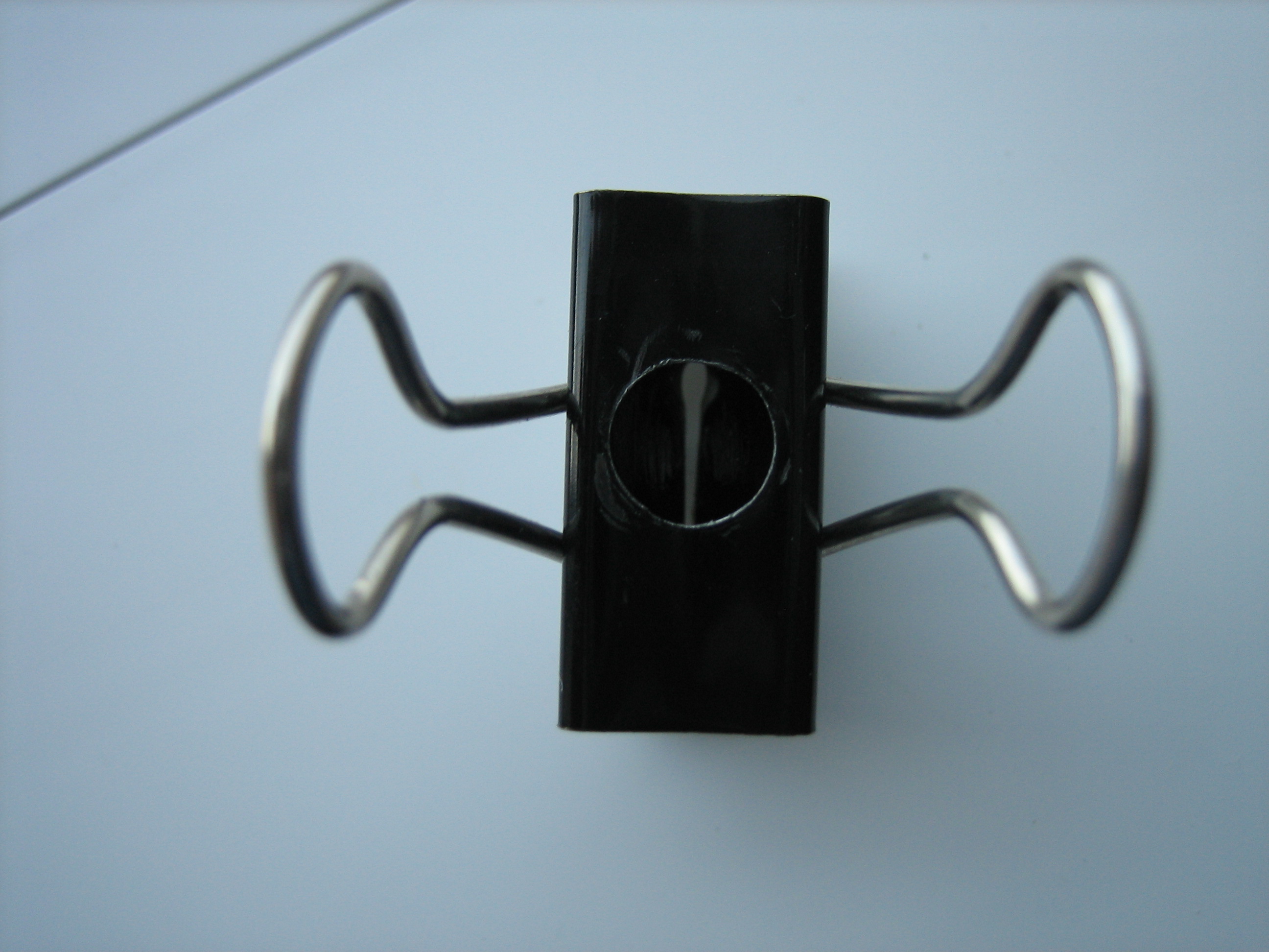

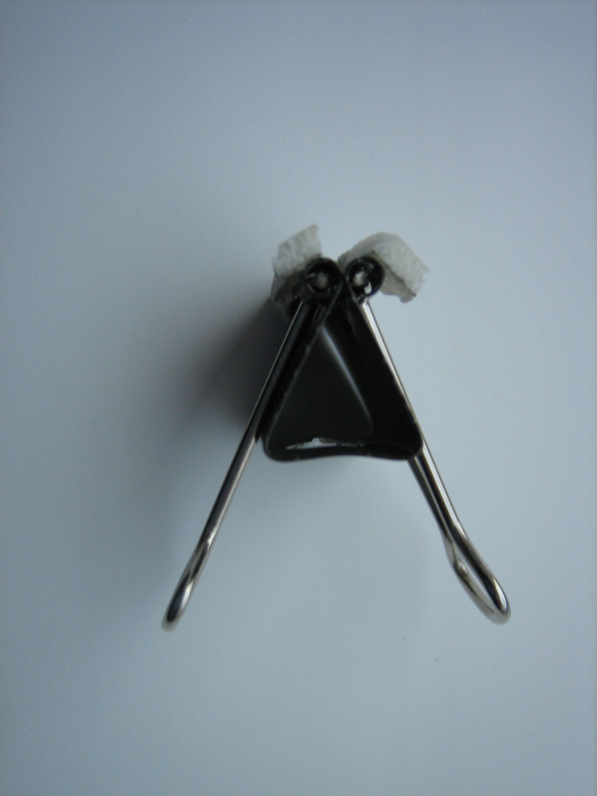

Turbine, can you provide more details about the quick release clamp to hold the lp with?

ecir38- My quick release clamp is just a paper clamp with a hole drilled in it the correct size for the record cleaner shaft and a little foam tape stuck on to the side that contacts the record. Simple, cheap and effective.
