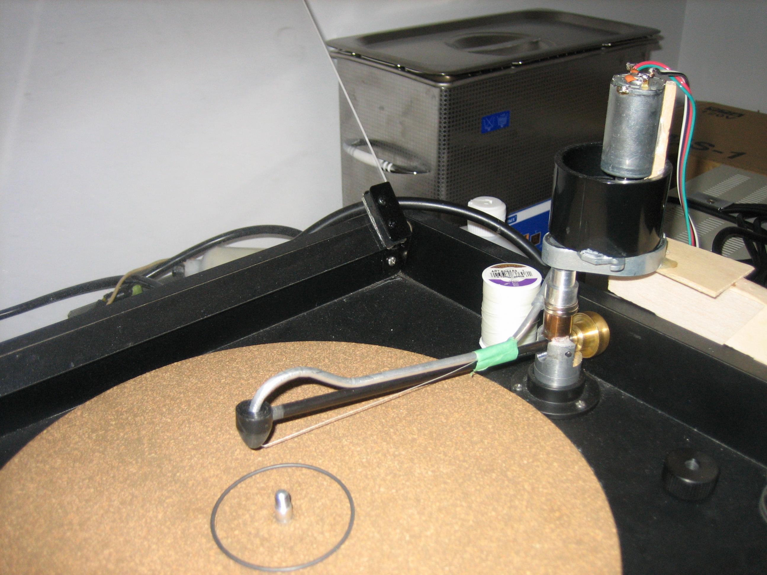

Thanks for the pics, I am looking at a similiar footprint. Looking at giving a 120v 6 rpm microwave turntable motor I have a go to see if it has adequate torgue. If that motor works I would probably change to a 3 rpm one.

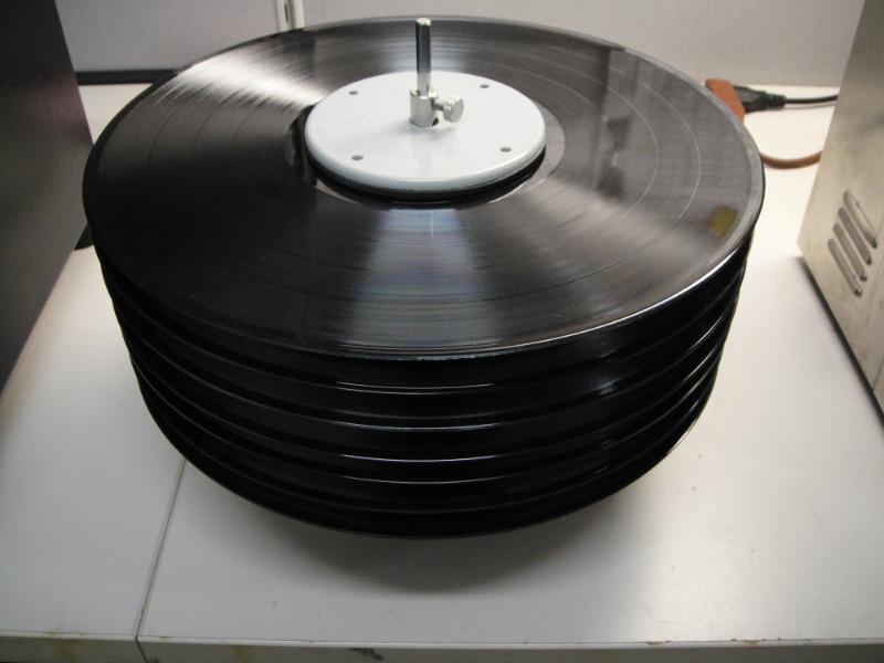

Width of spacers to accomidate 8 lp's?
Height of spindal above top of ulrasonic machine to?

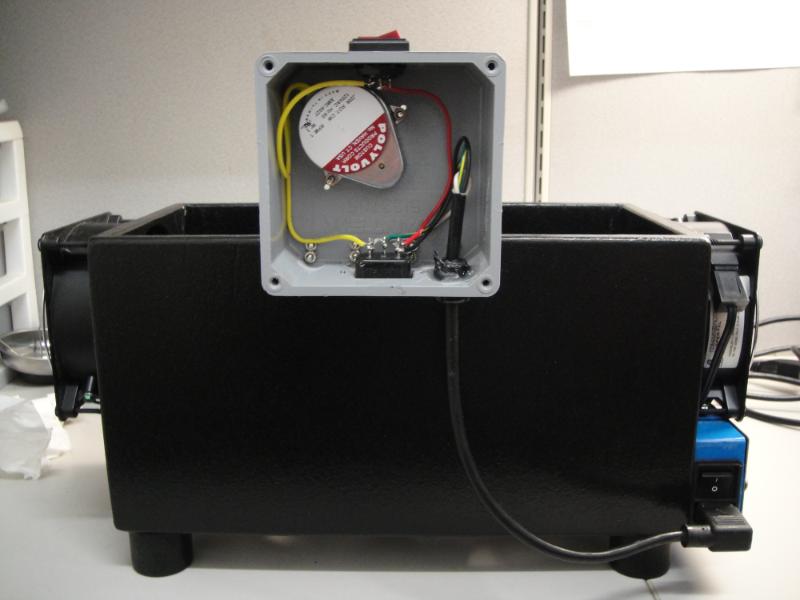

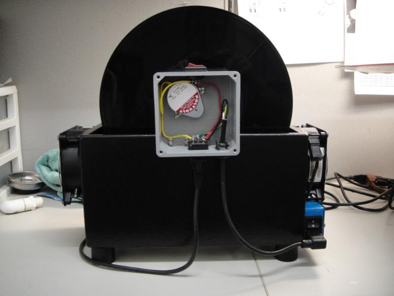

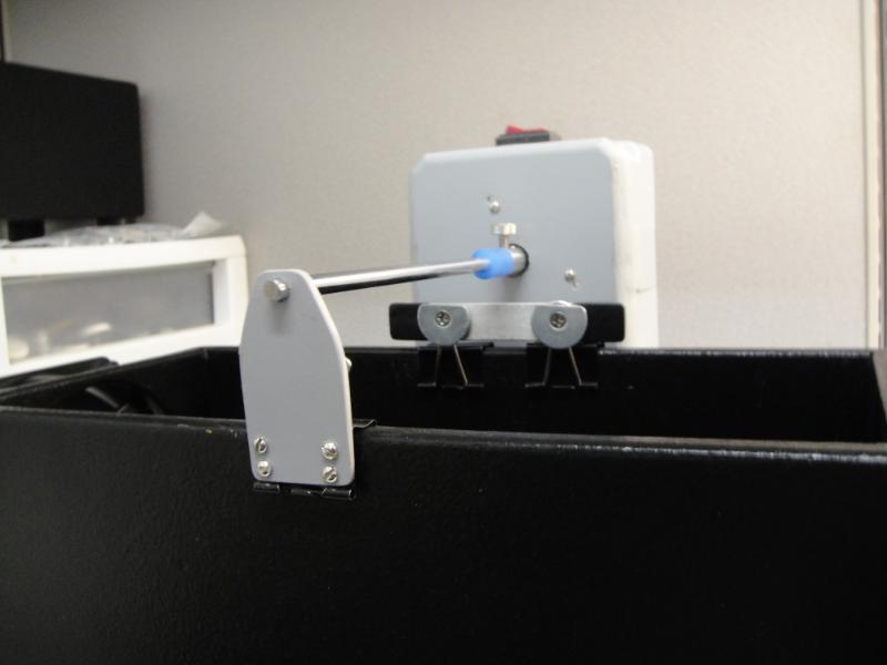

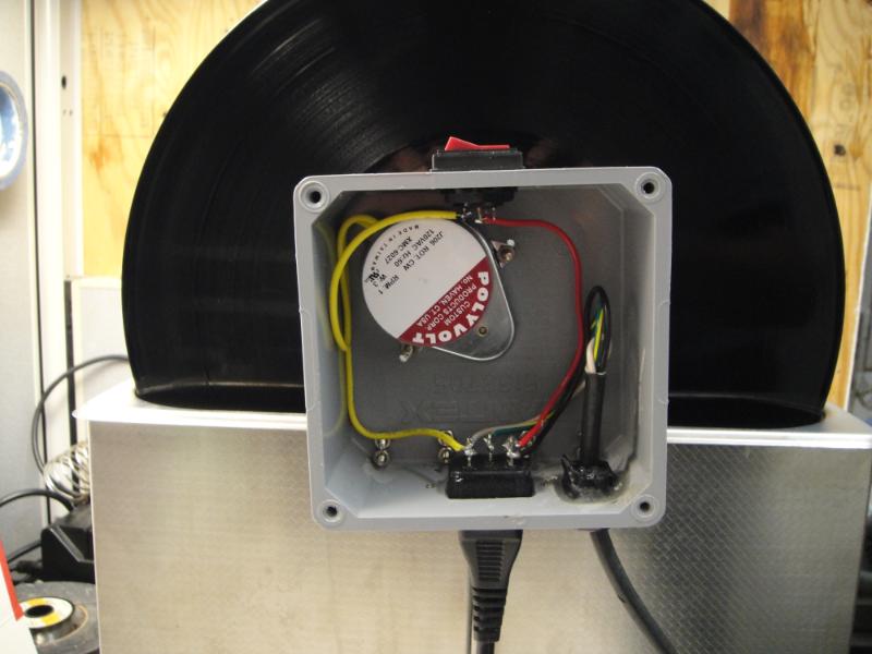

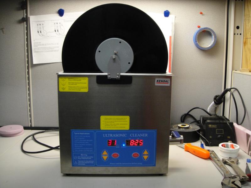

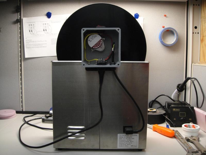

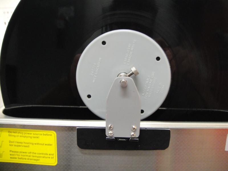

Junction box is used as a stand to load albums.
120v 1 rpm motor.
Added whip to JB so only one cord is needed.

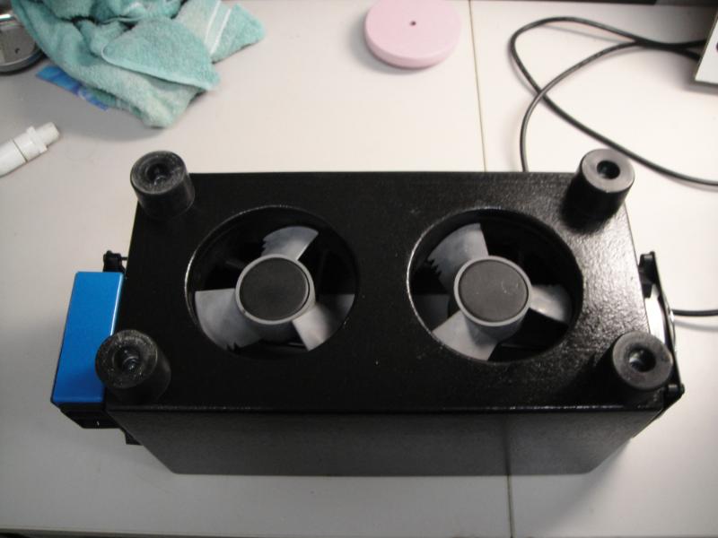

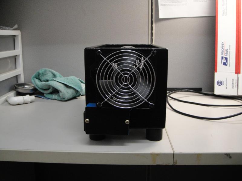

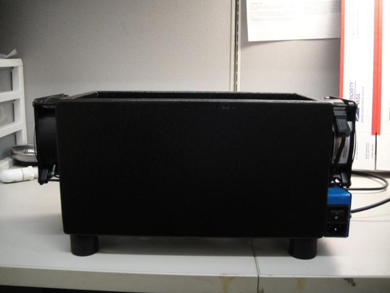

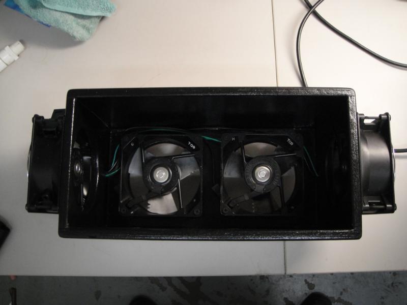

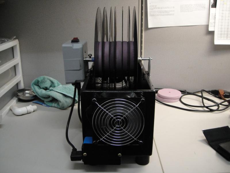

Made box to dry albums. Width is the same as tank, length is slightly longer. Fans are 120v equipment rack fans. Drying time is around five minutes.
120v 1 rpm motor.

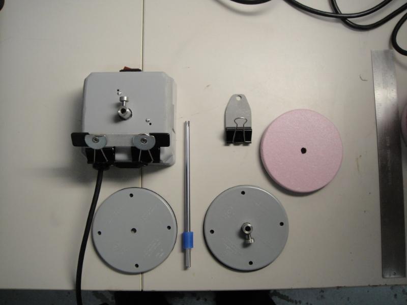

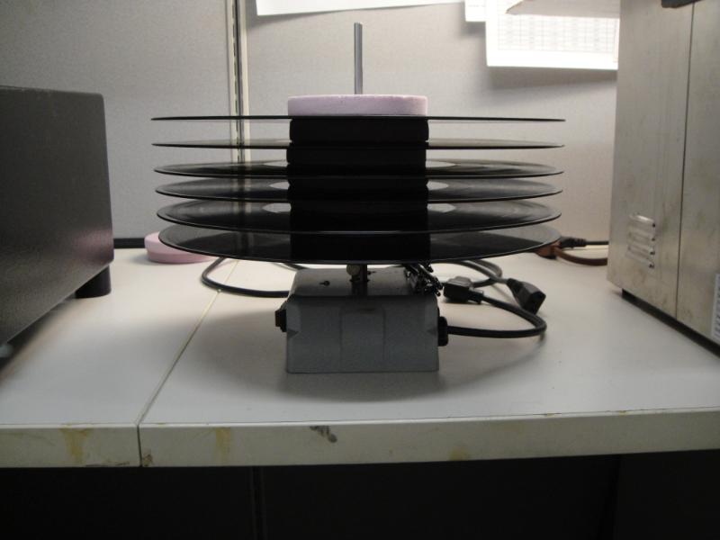

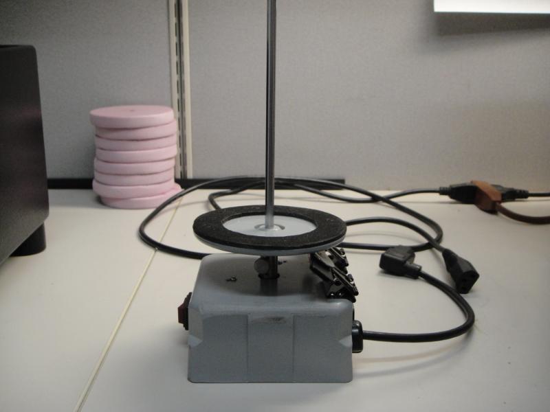

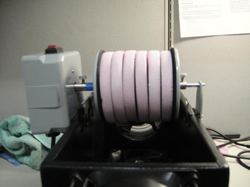

Top and bottom view of dryer. 1" x 1" rubber feet. Blue shallow electrical box with combo swith and plug on side.
Breakdown of assembly. Pink spacer is 1/2" insulation board.

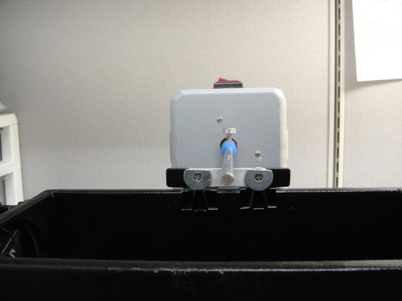

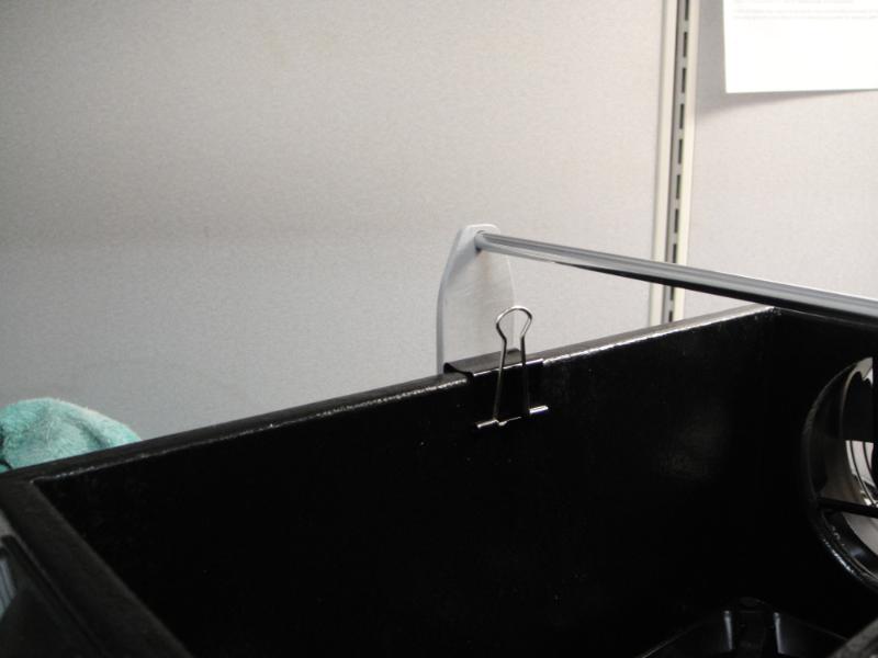

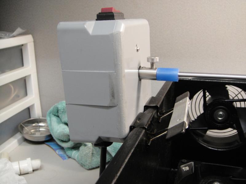

Office clamps make for quick removal for UL cleaner to dryer. Four screw in each office camp.

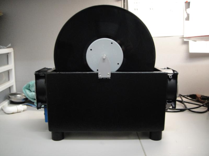

Dryer was made with 1/2" birch plywood. A light coat of fiberglass resin was applied before painting. For office clamps to work on UL cleaner, spacers were used on the exterior where clamps go so to keep the clamps square when clamped.
This has been a long awaited project which has proved to be well worth the wait. Thanks to all who have contributed and hope to see some more built.

Really a great efford there Brad! And a very good design as well.
Are you happy with the cleaning result? Please tell us what your experience are.

Hey Lars, I can't say as of now that it cleans better than any other cleaning machines. Will do some testing of friends lp's that have already been cleaned with nitty gritty's and VPI's pretty soon and will report my findings.
My finding so far show some lp's had dramatic differance and others not so much. As we know cleaning won't change a damaged album.
The max my setup can handle is 7 albums. I only did one run with that amount and it felt like the UL action was decreased by doing a finger test (UL action on my finger with one album compared to seven was quite differant). I can say that after cleaning 7 albums at a time there was quite a bit of sediment when settled. Will try 5 albums tomorrow to see if there is a differance. Did you experience similiar whereas more albums cuts down on the UL action?
