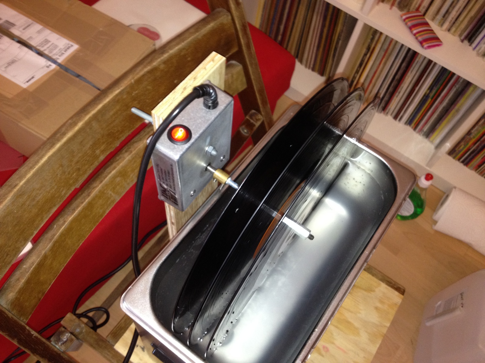

I made myself a record cleaner
So, while waiting for the bath to arrive [at which point I can figure out the dimensions needed for everything by trial and error], I got a few bits and pieces: - a 6mm threaded rod for an axle [turns out that is too thin for a record hole - but I can always pad out the part where the records are to go to the correct thickness.
- various bits of wood, to build a support for the axle - some nylon hose joints, conveniently the right size for the rod, to use as bearings (It's not going to be bearing a huge weight, so that should do fine ... and if it doesn't I can fit something better in the future) The only problem now is I'm wondering, how do I drive the thing around?
I was thinking of creating a large outside gear wheel by taking 3 or 4 bargain-bin, very scratched, records and gluing them together, then skimming the edge to make a nice large, flat wheel. Then I'd drive that using a motor with a rubber bush on it. Similar to how the original poster did it, but not as cool looking as I don't happen to have access to lots of nice acrylic 😉 How have others solved the drive problem?

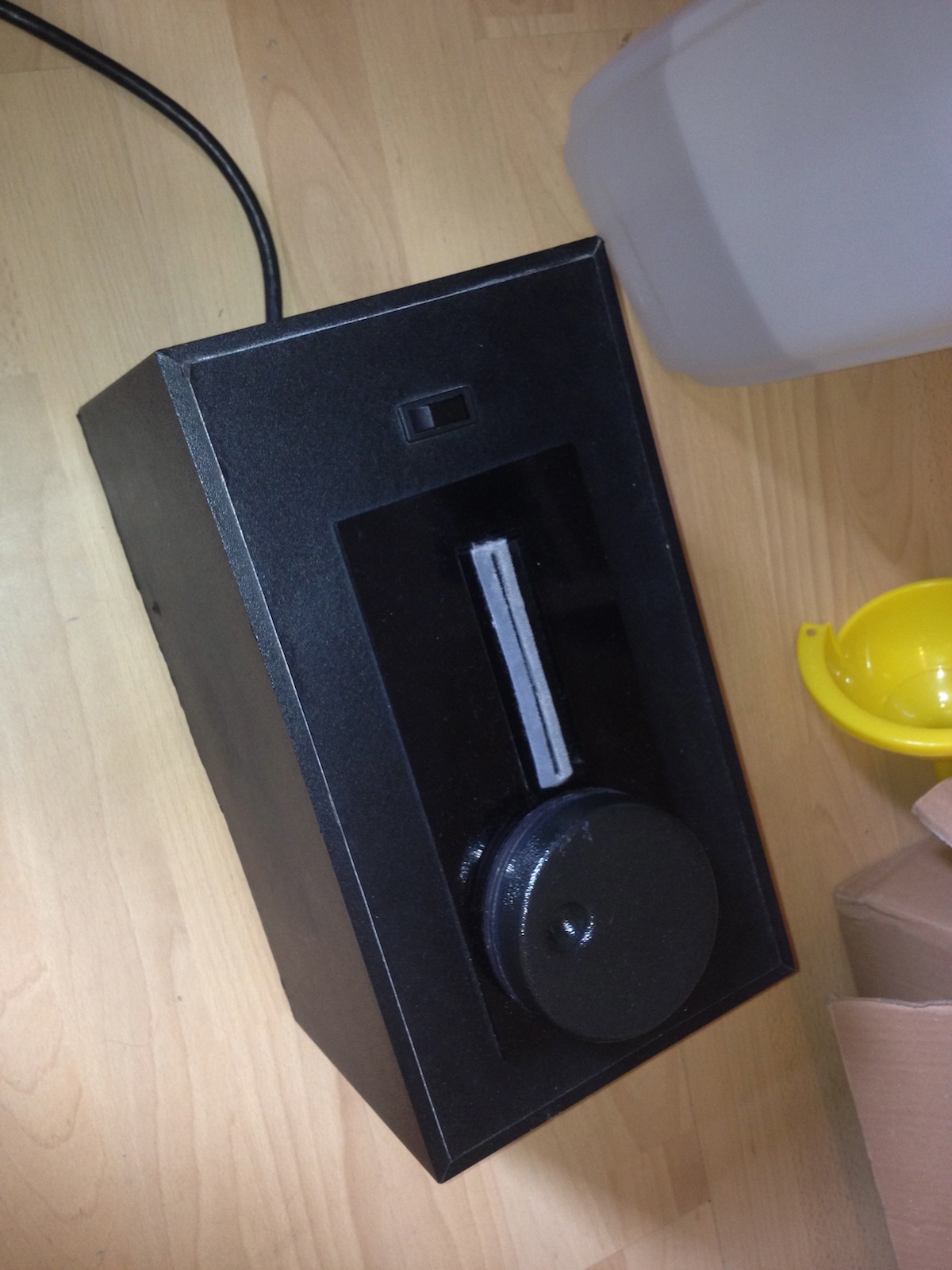

Very important: suck the water out after the cleaning! I bought a old american Nitty Gritty cleaner from ebay but there are better machines out there for this job. Again time intensive to import this from a foreign country..
See attachments for the prototype and Nitty Gritty cleaner.

Ishmail - Thank you for your reply. Your points make good sense. I've complete my DIY US bath cleaner and hope to post some photos soon.
One key differentiation I've made is to use a time cycled power adapter to rotate the record every 3 minutes -- effectively allowing each 1/4 of the record to remain still in the bath on the modified rotisserie. The total cleaning time is then 12 minutes per record (have not tried multiple records at once). I've also been using the AudioDesk surfactant in my bath and manually filtering the water using a DIY system incorporating some fine filtering sponges (aquarium style).
Oh, and did I mention that the telescopic structure that suspends the rotisserie motor was fashioned out of the support base of an old EA RockBand video game drum set?
I know - strange, but it works 🙂

My version
And, yes...that is the simple telescopic base of a RockBand drum set. I cut the plastic piping to fit the required length, installed a rotisserie motor to the top, repurposed all sorts of things from closets/garage and several hardware store trips.
For example, the discs that help hold the record in place were fashioned from furniture floor sliders, drilled, affixed with dashboard iPhone grip pads for - well - gripping power.
The motor plugs into this: Amazon.com: ART-DNe - Adjustable Cycle Timer: Home Improvement
