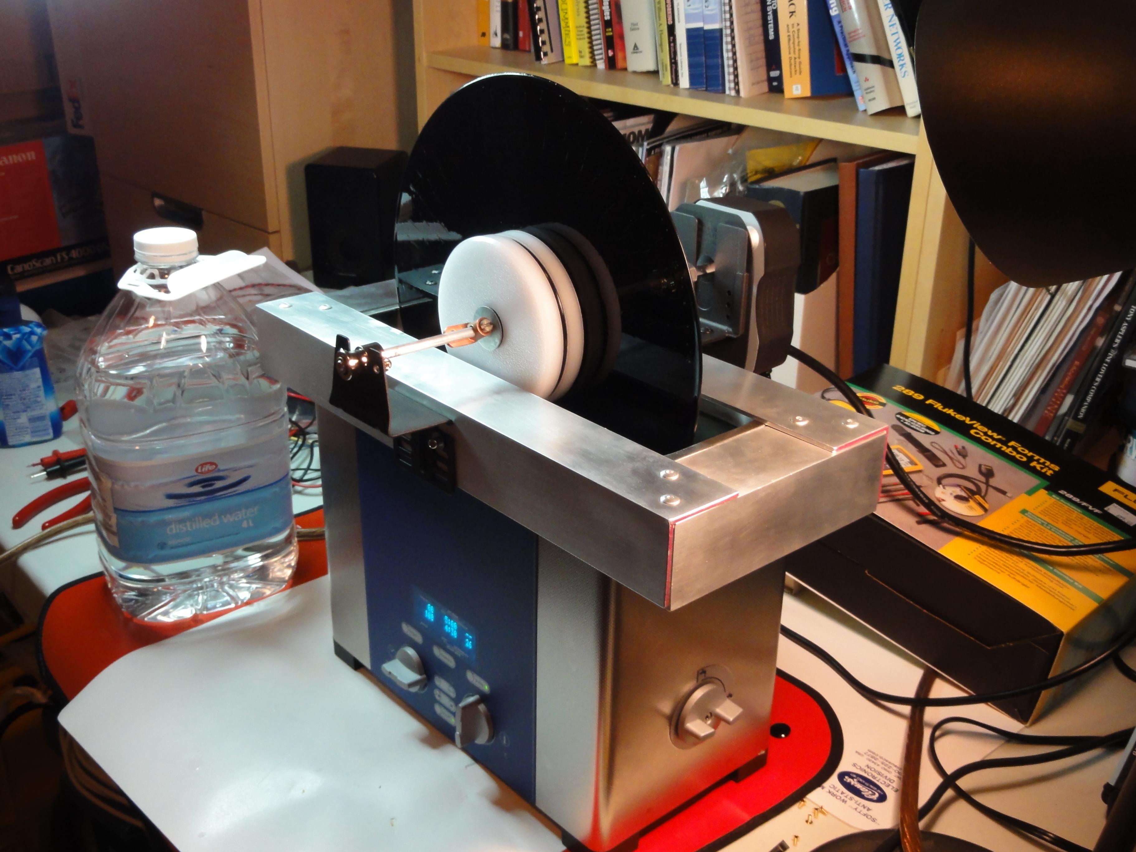

My version using the German made Elmasonic P60H
Great posts everyone! Gotta love DIY!
Decided to try my own version using a state of the art German made Elmasonic P60H with both 37 and 80 KHz modes, sweep mode, pulse mode, and an accurate thermostatically controlled heater. Sure it costs more than the cheap 40KHz machines but when i look at what the Audio Desk costs, this is still only a fraction of the cost. Purchased from Tovatech in the US 973-913-9735
Using the Vinyl Stack solution found on Ebay to separate records and protect the labels. Very well made product but fits on a 1/4" spindle only so I am using 1/4" aluminum rod for spindle.
Using a rotisserie to rotate the records < 2RPM.
Made the top frame from 2" aluminum angle brackets.
Holds up to 4 records at a time.
Using distilled water and a few drops of PhotoFlo and JetDry.
Just starting to use it so results are inconclusive so far. However, visually records come out looking cleaner than new and cleaner than after my VPI HW-17F.
Will post more results as i progress.
