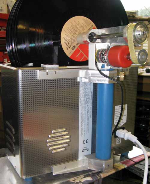

This shows the rear non works view.You can see I have attached my unit to the cleaner using two of the original screws on the base and a clamp type fitting on the top.
The mechanism is telescopic . The blue plastic tube is the fixed outer and the Aluminiun bar holding the motor unit slides inside it.

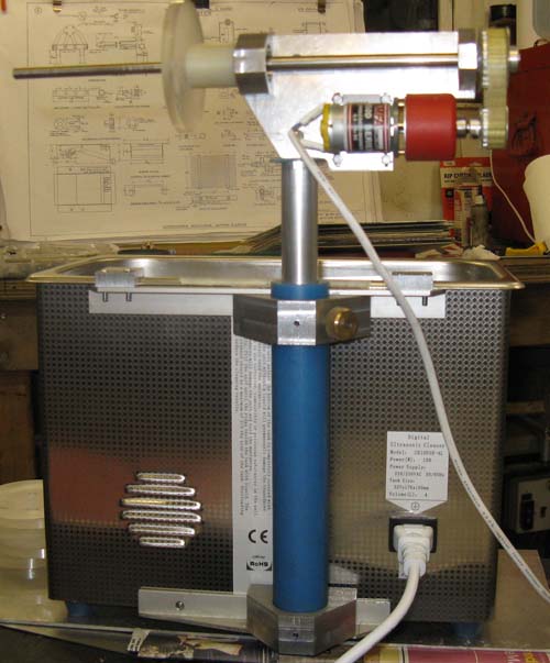

This shot shows the works. I have used a rear ballrace and a front ballrace for the spindle to avoid making support for the front and to give me the flexibility I think I need. The motor is a standard product from Farnell as are the 2 pulleys and belt.
I have the motor running at 1.5 rpm with the pulleys getting me close to 1 rpm. Supply is 5Vat 200ma.

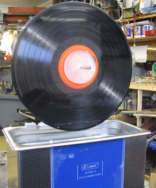

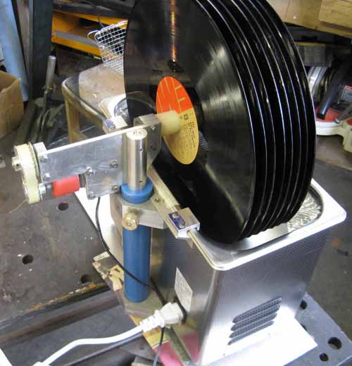

This shows the parked for storage position. The drive unit can be completely removed by lifting it out of the fixed blue tube and the cleaner used for other purposes.
