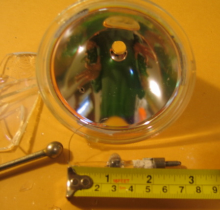

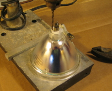

120 watt which is the same as the 150 and 200 UHP drill from rear to remove Lamp element
Oh Yeah,,, in case you spuds haven't figured it our yet ,, the Little metal Balled thing on the Lower Left is the Backside of a regular Glass cutter that you can use to smash the Blast shield Glass in front of the lamp. I left it there in the Picture just so people can see what it looks Like if they have to go to a hardware store to buy one. the front glass is not coming out without cracking and sending chards all over the Place so you might as well plan on covering it with a towel ,, smashing it and then digging out the peices. Save yourself the frustration. If someone has been successfull in removing the Glass intact please explain the procedure because I would like to know how the hell you did it.

<<<<Why drill?, apply water and wait a moment.
Front class should come out easy, apply water and wait a moment..
Better without front glass, but if bulb explode...<<<<<
HMMM??? I tried it on another UHP Lamp a while ago and left the damb thing submerged in a cup of water for about a week. Nothing! It was as Hard after a week underwater as it was as the day I put it in. I have also tried acetone and Mineral oil to dissolve the adhesive on the front glass as well. Nothing!!
That's why I say break the damb Glass to begin with and save your selve the frustration and having tiny chards all over the Place.
If you can show me a intact Piece of Glass from the front of this type of sealed UHP Lamp that was removed with water I will eat the thing.

Since the front glass is atached with a special silicone, you can youse some silicone remover fluid....
but take care of your reflector plating, maybe the remover will destroy the surface of your reflector...
a small trick to remove the front glas is to make a small cut / window with a dremel at the side of the front glass, so you can go wit ha very smallscrewriver straigt between the front glass and the reflector...
thats worked for my in 80% of all lamps...
the trick with the water works fine for te cement @ the backside..
it will not melt out or something, but if you do the wather trick you can get the cement out with a small screwdriver....

I was able to pick out the crumbly white lamp cement with a sharp metal pick in just a few minutes work.
HMMM ?? you learn something New every day I will check into silicone remover. As far as the cerment on the rear of the Lamp I will stick buy my story . Water has no efect on it. a small drill set to breach the cement and to go just before the lamp works.
