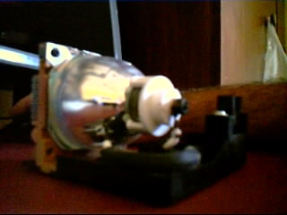

No the exploded lamps weren't caused by cement on the lamp. I was very careful to avoid this having read of the problems this can cause. Also i was very careful not to touch the lamp with bare fingers.
I've now tried four lamps from YWH with the following outcome:
1st lamp - worked for a few hours then became very dim. Lamp still works but burn chamber is blackened and the light output is only usable in a totally darkened room.
2nd lamp - worked for a couple of minutes, then shattered.
3rd lamp - worked for a couple of minutes, then shattered.
4th lamp - wouldn't start properly and projector switches off lamp after a minute or so. I sent this lamp back to YWH for testing and he found it worked OK on another ballast.
The lamps that shattered did so within a couple of minutes of being turned on. Didn't cause any damage to the projector but the last one also cracked the lamp reflector.
I picked up a genuine used Philips lamp on ebay and that works no problem. The last message i got from YWH said that there doesn't seem to be a replacement lamp that's compatible with my projector. I assume this may also apply to other Phillips projectors. I was just trying to see if anyone had had any success with a Phillips Projector without having to make major modifications.

@ gloil
I have about 6 models of the philips hopper ....
just 1 version works with a jyd lamp.... the others all got incompatible ballasts...
i had a black - Lamp too after a few hours with a jyd 150W AC.... i measured only 72V @ 1.2A ... that are about 82 W...
It also was underpowered..... with a jYS i got a Very hard noise out of the Lamp NT. I measured about 2.2 A and about 20V...... so i stopped the test... maybe it will explode....
Normaly it should be on 80 - 100V @ 1.5 A
so i think of a ballast mod if i get the time..
