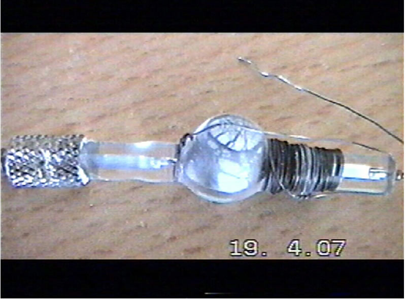

I wonder if anybody can help me, I have an NEC Multisync MT1040 projector that needs a replacement lamp, according to the replacement lamp pdf the lamp I need is a JYs-SE 180w AC, can anybody confirm that this is the correct Lamp. The Original Lamp is a 180W NSH Life: 2000 hour. Unfortunately, its impossible to work out the arc length as you can see in the picture.

Hi AGM!
NSH! you can choose cheaper jys/dc, or perfect new SHP

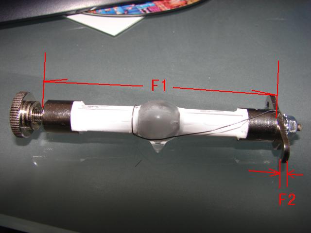

Hi there,
I have just bought a CTX ezpro 550 projector. I ordered a replacement bulb before I received the projector, when it arrived I realised that I have the wrong bulbs. Could you tell me which bulb I should be using?
Here is a picture of the dead one.
Hi there,
Its the CTX 550M. I forgot to add the M in the previous post. I thought it was the 550 with 400w halogens when i bought it. Thats why I got the wrong bulbs.
The metal bar removes from the lamp. The F1 dimension is 76mm.
