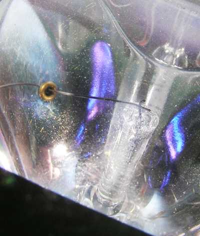

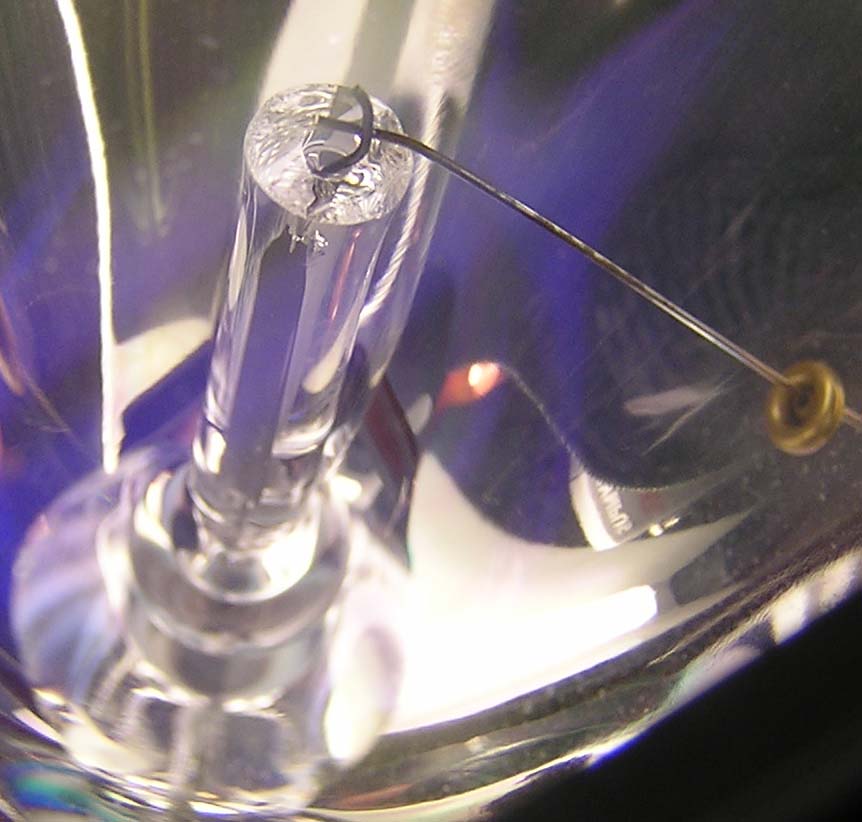

lamp for Eiki XNB4 broken?
Hi Folks, dear guru YWH,
I got a Eiki beamer XNB4. I think the lamp needs to be replaced, but i´m not sure, as it´s not broken, not dusty or exploded. The beamer just stopped working from one day to the other.
http://www.projectorcentral.com/EIKI-LC-XNB4.htm
I noticed that the wire that comes out of the glass of the lamp is not directly connected anymore, but rather "crossed" (is this still working?)
What kind of replacement lamp do i need? It says UHP 200W, the lamp replacement number is 610 293 2751, which will give you lots of incredible expensive replacements (500$!)
<B>All UHP lamps I see at 18wheeler have a <u>litte glass bulb in the middle</u>, but mine does is just a straight glass without any bulb!!</B>

Hi loudeye !
your UHP lamp has a <u>litte glass bulb in the middle too, you can pull it out to take a pic.
you need JYD/AC.
you need JYD/AC.
Ok, thank you! I see that there is also a blub in it, it´s just deep inside! How stupid of me.
So replacing the old with a JYd-SE lamp (AC) from 18wheeler will be the best?
Or do you think I can do anything other? Does the fact that the wire looks broken mean that the whole lamp is not working anymore or is this just normal?
Hi loudeye !
there is litte glass bulb in the too!
you can ask 18wheeler to get JYd-SE lamp (AC) 200W
or you can try to contact the broken wire again,
