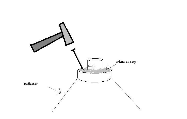

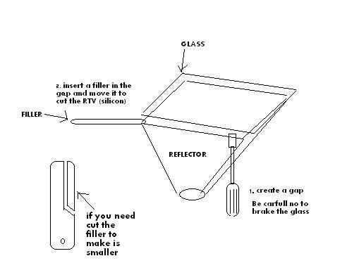

Did you lamp have the white epoxy holding the lamp into place?
yes I had the white epoxy
but first you need to pull out the glass form the reflector (see the pic)
filler=is a tool that adjust car engine valves (very thin and flexible metal) use a 0.035mm-0.06mm filler, you need some one to help you create a gap so you can insert and move the filler.
you can remove the epoxy but it will take time.
try gently use hammer and nail to remove the epoxy (like sculptor)
the lamp need to be on rubber or someting soft (mouse pad).
and you can drill small holes then try to brake the epoxy.

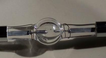

Do you know what is the difference between the DC lamp on DC ballast and the AC lamp on AC ballast(color temp?, life?arc size?...)
can you get the DC ballast?
can you get the DC lamp?

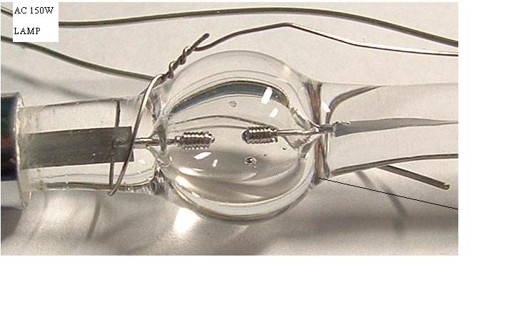

BTW I think that this AC lamp on the original hitachi AC ballast is about 5000K 🙁 (not 7000k), but I do not have time to test it right now.
if some one is intrested here pic of my AC lamp.

I have found an easy way of getting the fire cement of the back of the lamp around the centre screw I used a model makers 12 volt drill with a small burr like a dentist drill bit, the cement was hard on the surface and softer under it came out without damaging the reflector even though it is badly cracked
I could not get the glass of the front, could not get anything between the reflector and the glass so I sawed the corner off with a diamond tile saw I will put most of the glass back!
my origanal bulb was the same as yours two small electrodes so I guess it must be AC
anthp
"the cement was hard on the surface and softer under"
No, my cement was hard on the surface and hard under
and yes I needed to use drill actually 220v drill and 2 drills bits, the drills bits ruined after that and when I drilled I put on the cement and the drill bits some water this made the cement a bit softer and the drill bit cooler:hot:.
:smash:
"I could not get the glass of the front,...
could not get anything between the reflector and the glass..."
No do I... 😱
It was hard but the filler trick worked!
it is so thin (0.03mm less then A4 paper) , flex ( there was no room for it I needed to work with it in 90 degrees)
and because it very thin it's also sharp.
This is UV/IR glass and if the lamp explode or something it will keep the projector safe.

I can get it ,
AC or DC?how about the electrodes of your old lamp, one biger, other is small?or they have same size?
DC:
attachment.php
AC:
attachment.php
