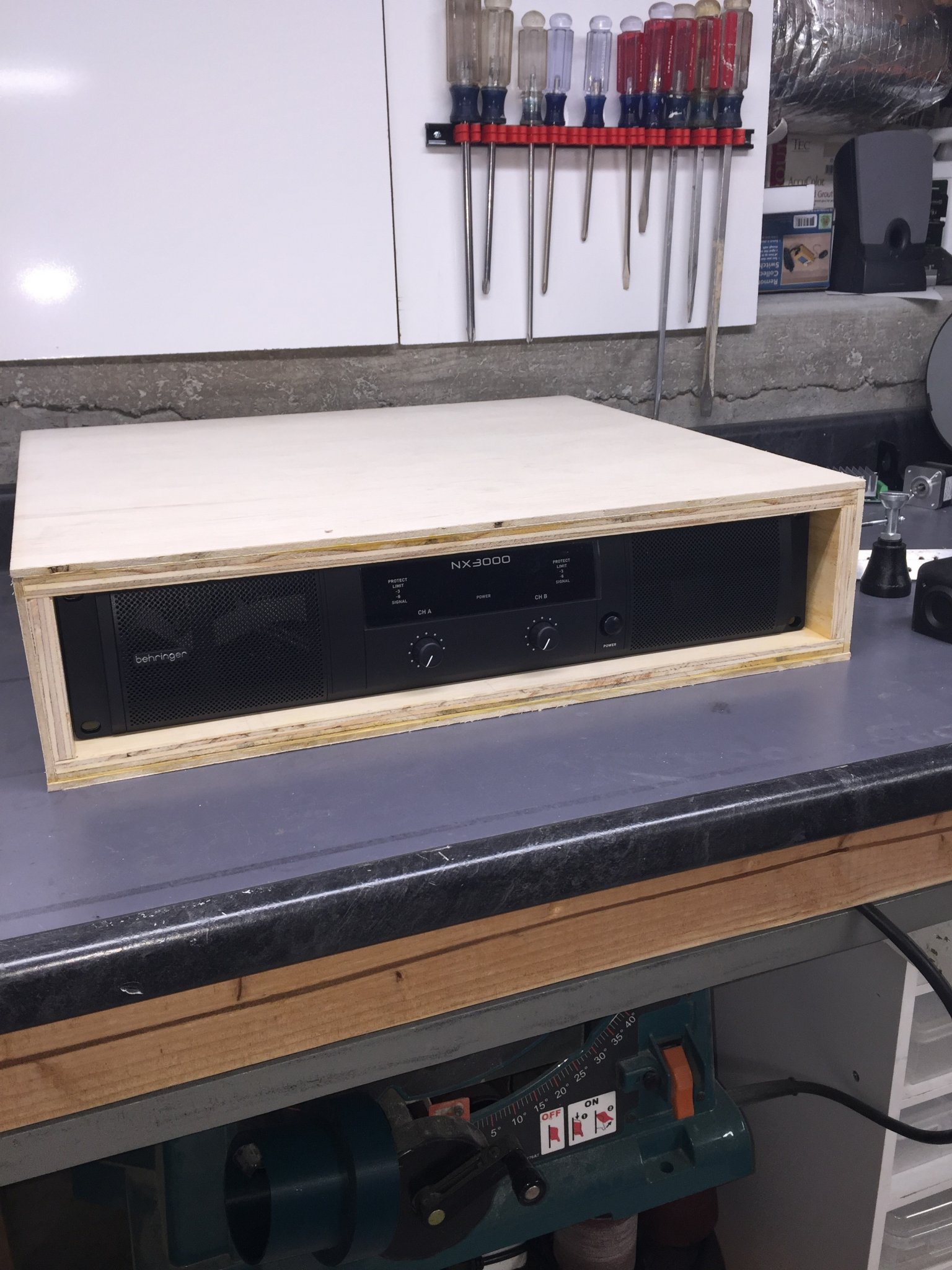

Picked up an NX3000. 7.7 lbs.
The new box weighs 5.3 lbs. Amp in box is 13 lbs.
The old BOX weighed 15.3 lbs. I tried to weigh the rmx 1450 using the kitchen scale in the basement, the scale ran off into the corner of the basement to hide.
Online says it weighs 40 lbs. Old total amp/box weight 55.3 lbs.
I'll be giving the NX3000 a try for a while once the box is done.
As a side note, because the NX is so shallow, I can mount a rear panel with an IEC AC jack, two AC outlets, and a 10 inch long cord that powers the NX. That way, the umbilical to the mixer will be the AC cord and signal wires, perhaps 6 foot long with nylon net sleeving. I can also put another small panel in with two neutriks per channel for speakers, also two 1/4 jacks per channel, gives me setup flexibility.

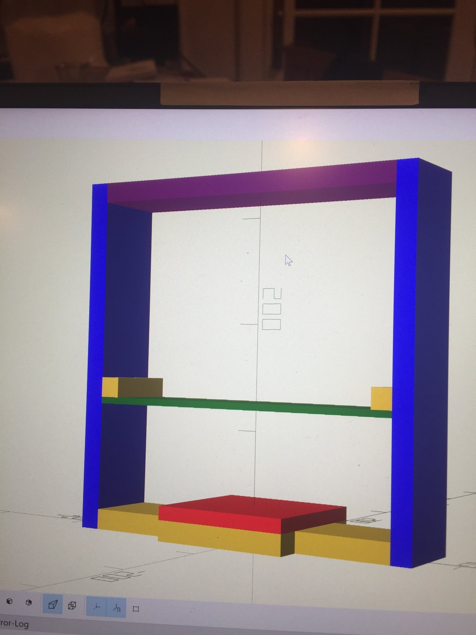

Did a quick drawing of the test setup for measuring the stiffness of the panels I will make.
The red is my small kitchen scale. The green is the test sample. It will be held up to the yellow side bars using simple clamps on the blue side supports. I suspect clamping to the yellow rail could introduce friction and compromise the measure.
When the machinist jack is placed on the scale, and turned until the jack touches the sample, then I can remove the side clamps. At this time, I reset the scale to zero. With the indicator supported from the top (purple), the indicator is set to zero on contact with the sample.
Then all I have to do is jack up until I measure 1 lb, take an indicator reading.
The beauty of it is, all the forces are between the bottom piece, the side pieces of the lower window, and the sample. Since the lower window is force driven by the jack, any deflection below the sample is unimportant to the measurement.
The only thing i would have to worry about would be any distortion of the upper window from the force. So I can put a support piece behind the sample horizontally to help lock the sides horizontally.
I can also simply put a board on the top of the side bars, and see if the reading changes as I push on the sample on the underside of the side bars.

Finished up two rack boxes, a 2 RU and a 3 RU. Put the beringer 3000 and a power distro unit in the 3RU, had a gig yesterday.
Carrying the amp was just so sweet, gravity was so well behaved.
Bought some powercon connectors, going to make a power distro to go in the back of the case, that way I can put cable sets together to make setup much easier. Probably 2 powercon outs and a duplex outlet, powercon to the mixer, duplex for other powered equipment so I can control the power ground loop.
Next, the mixer case, then on to the speaker case testing and design.
John
Forgot to mention,.. used that gloppy black cabinet paint stuff, goes on with an open sponge roller, leaves a cool texture.
Worked out quite well, now the cases don't look like they were from the 80's with that grey carpet. (well, they actually are from the 80's....)
