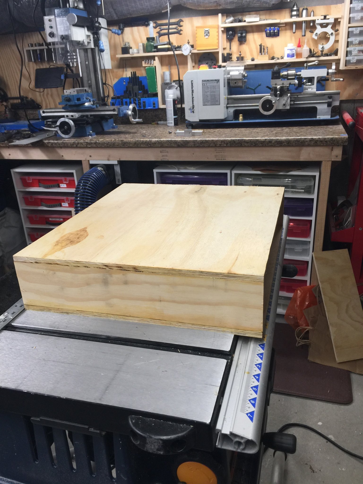

Started making the amp box, a 2 RU by 18 inch deep one.
First, a 1/2 inch ply box with sides, top and bottom. 18 inches deep, and internal dimension 19 1/8th by 3 5/8th. Not sure how thick the carbon fiber cloth will be, so left room in case I fold it into the box.

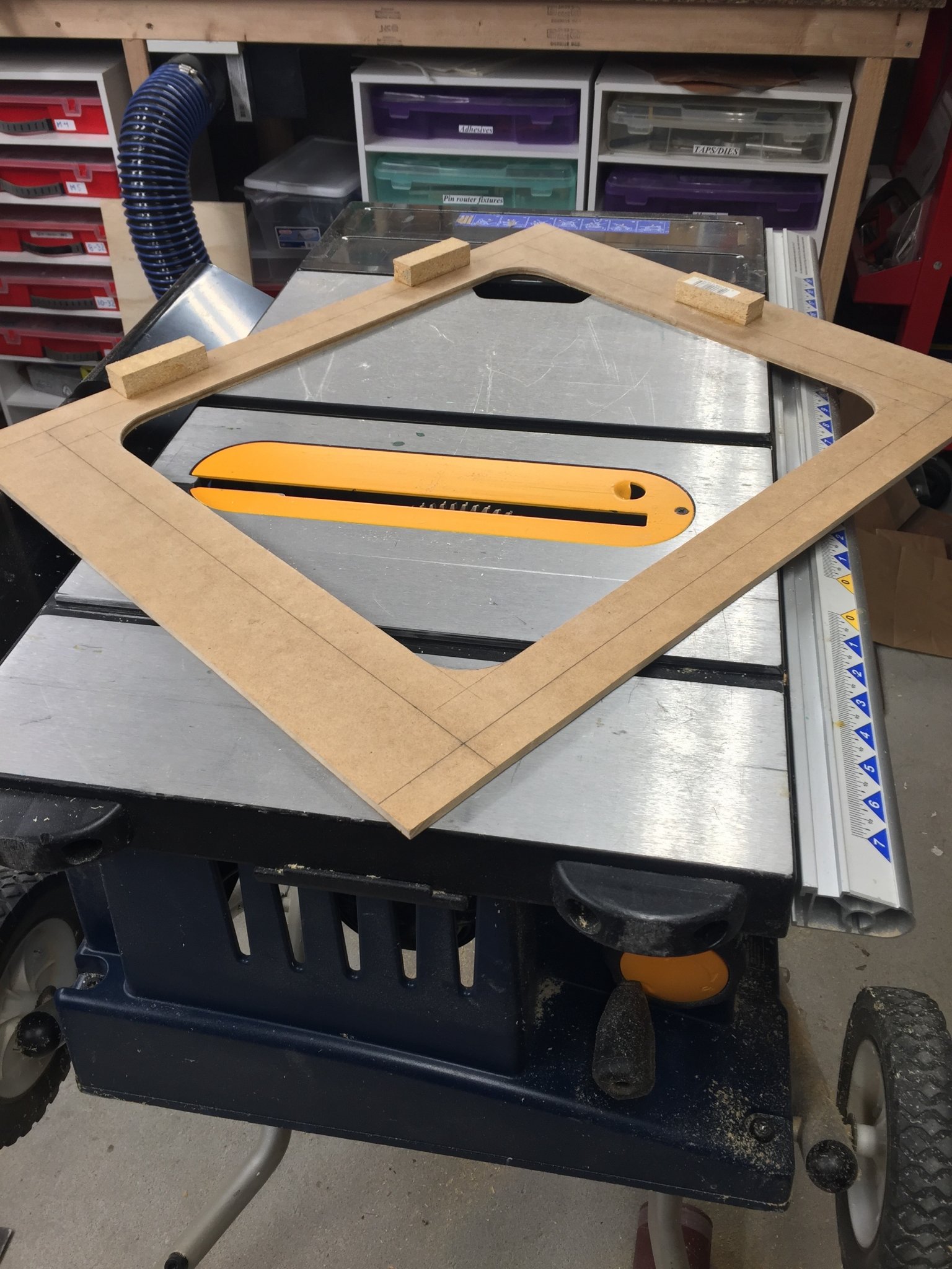

Next, a 5/16 MDF router template. I locate it on the box with three dogs, two in front and one on a side in the middle.

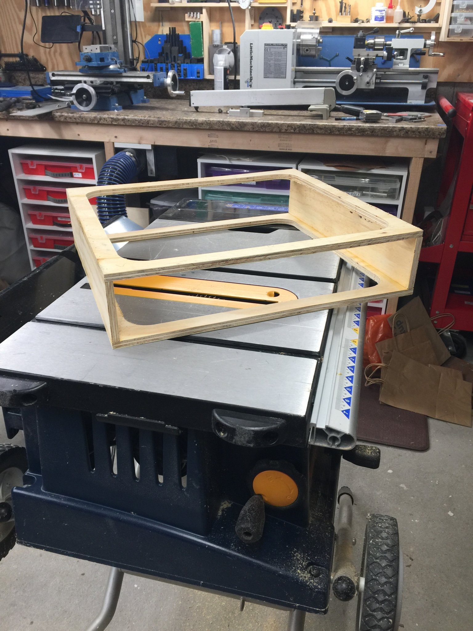

Here is the box with routed top and bottom.

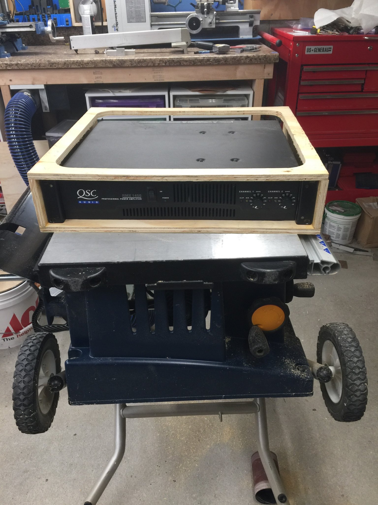

Here is a test fit of the amp. Note that I left the sides full, no cutout. I will be adding supports to the back sides as the amp has brackets for side mount there, will add strength. Note that the amp is not supported along the sides, as the hole is larger than the amp. I will probably glue a 1/2 inch ply by 1 inch wide support on the top and bottom so they touch the amp from front to back.
This box is just the half inch inner, I will be adding a layer of 1/4 inch all around then the carbon.
Box started at over 7 lbs, so far it's 2.44 lbs. I think it will be 3.5 lbs in the end prior to clothcoat.
