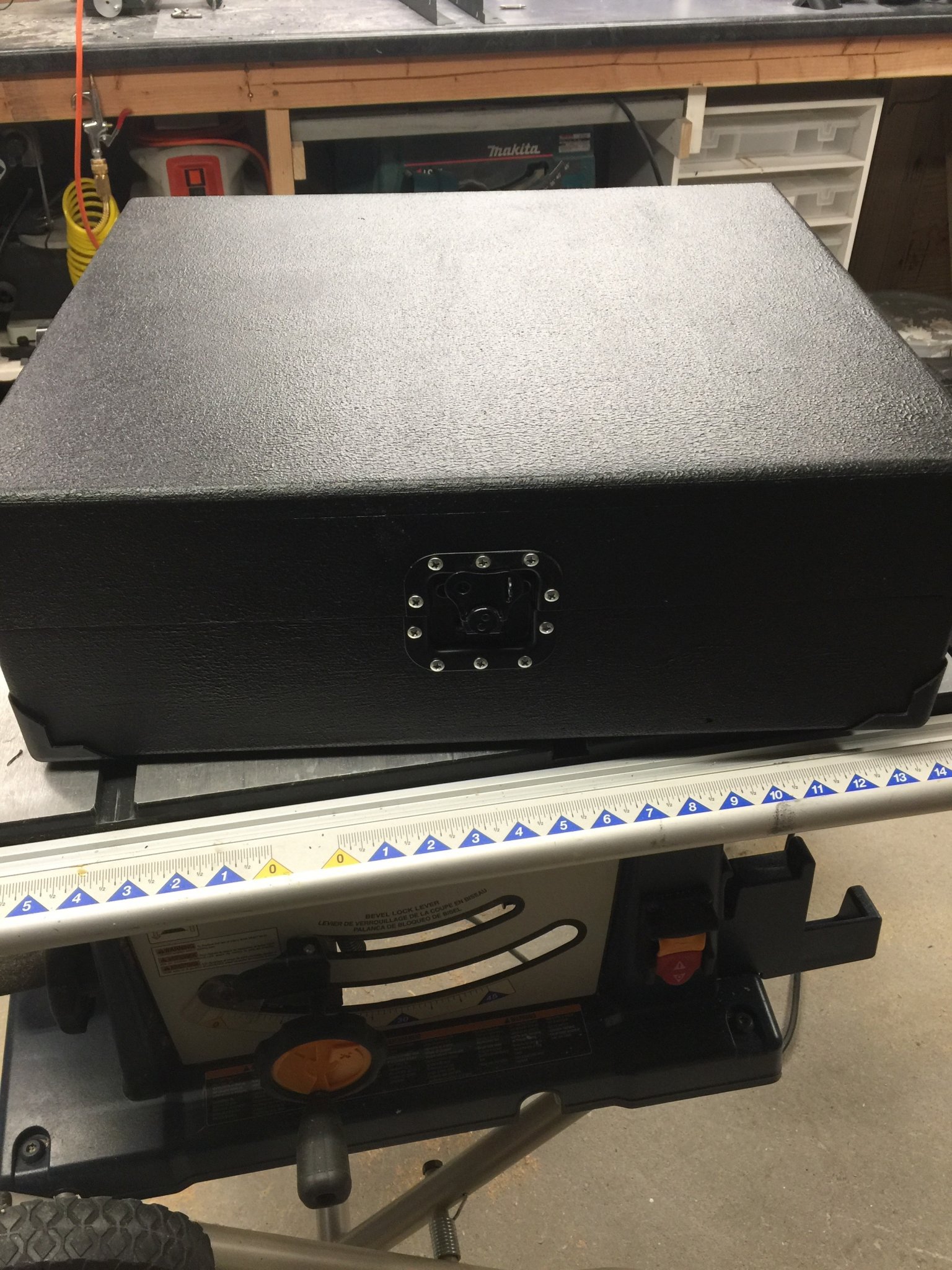

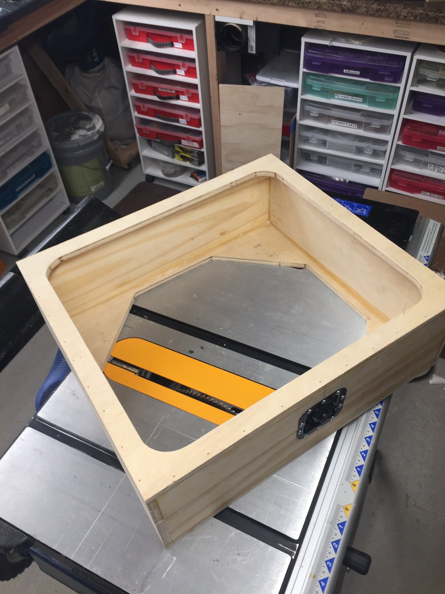

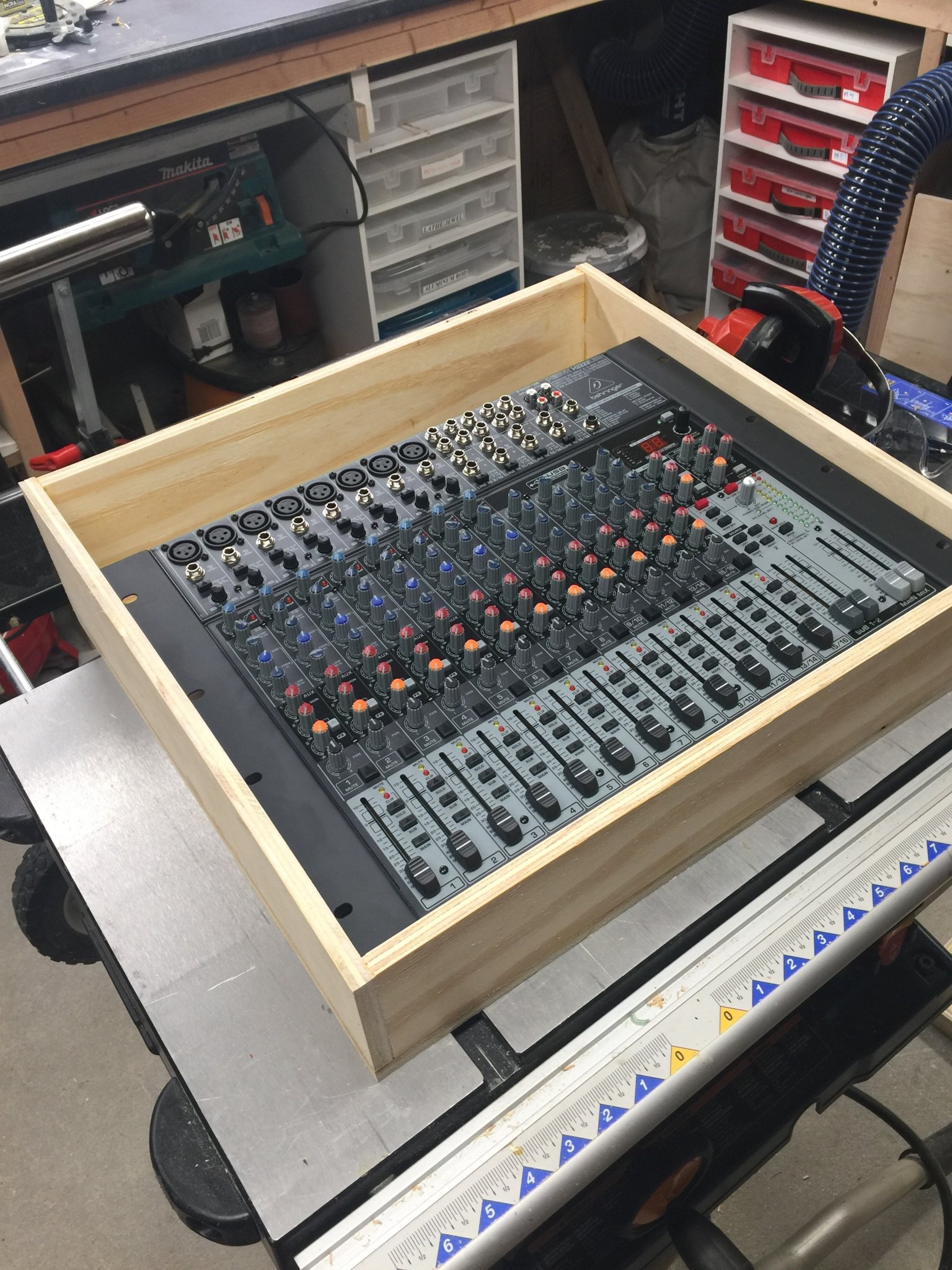

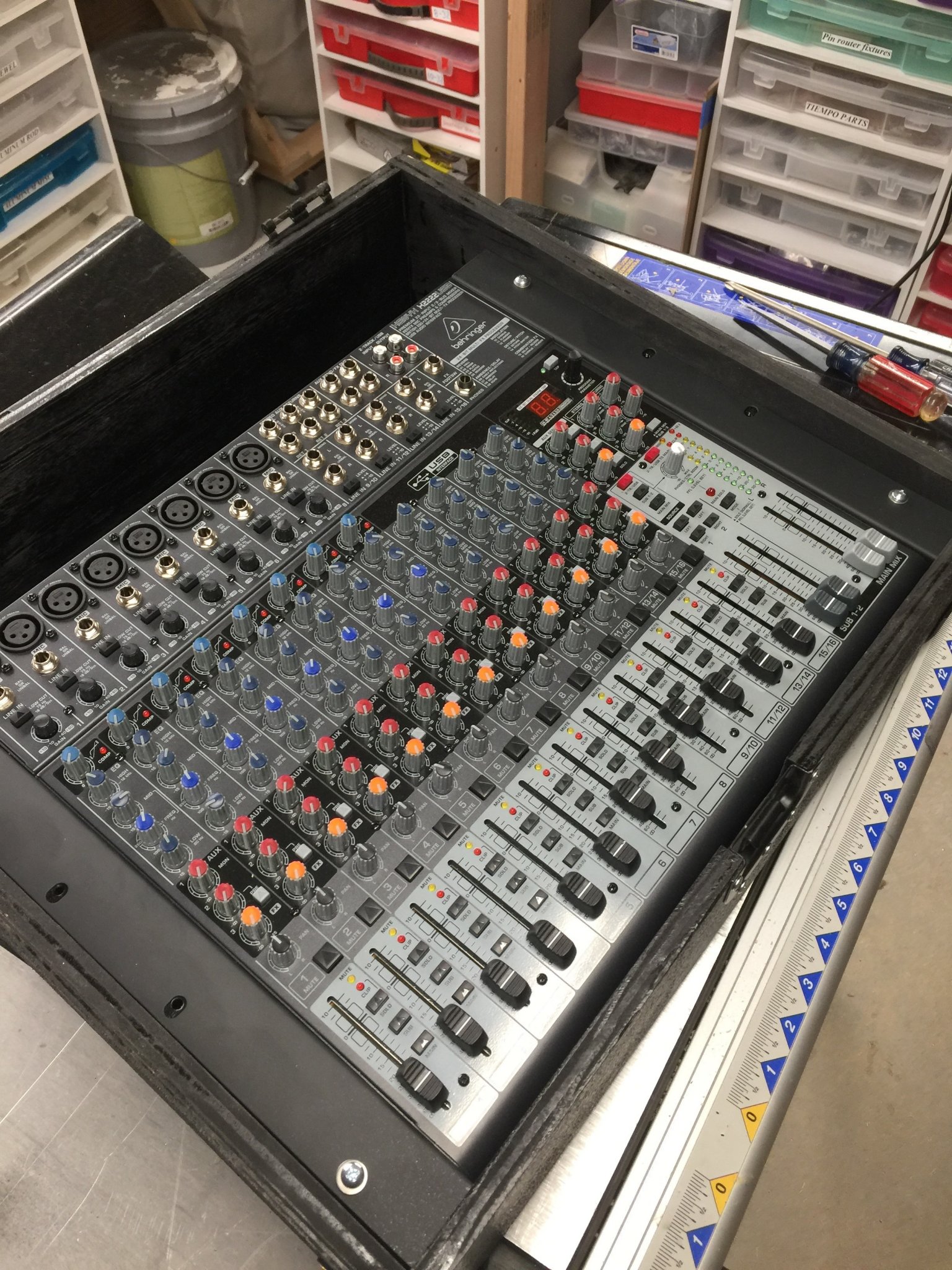

Some new work.
first pic shows the routing of the bottom and the top. I left material for the bumpers on the bottom of the mixer, the intent is to have it resting on the bumpers, while also locked by the rails on the sides. The top, I removed more for weight.
Second pic is the fit of the mixer in the bottom of the case. Note there is room in the back that is where I plan on putting the box for the powercon connection and the stereo feed to the amp using an XLR connector. On the left, I plan on some kind of relief to allow the 100 foot snake to nest, some kind of brass thingy to lock the snake and prevent pullout. Will give details when I figure it out. It will be a lathe thing, good to roughly 1 thousandth of an inch accuracy (only because I can...or hope I can).
Third is the mixer locked to the side rails. I glossy black painted the inside, and did the speaker paint textured thing on the outside.
Fourth is the case closed. This is the front, a locking mechanism. On the back I used detachable hinges.
If you look closely, the locking part is setup so there is nothing higher than the front edge. I will make a pair of brass pins to locate the side edges, the sides do bow a tad relative top and bottom, and I don't like that.
I will now work on the back powercon and output box. My plan is one cable, power and stereo signal, to the amp chassis.

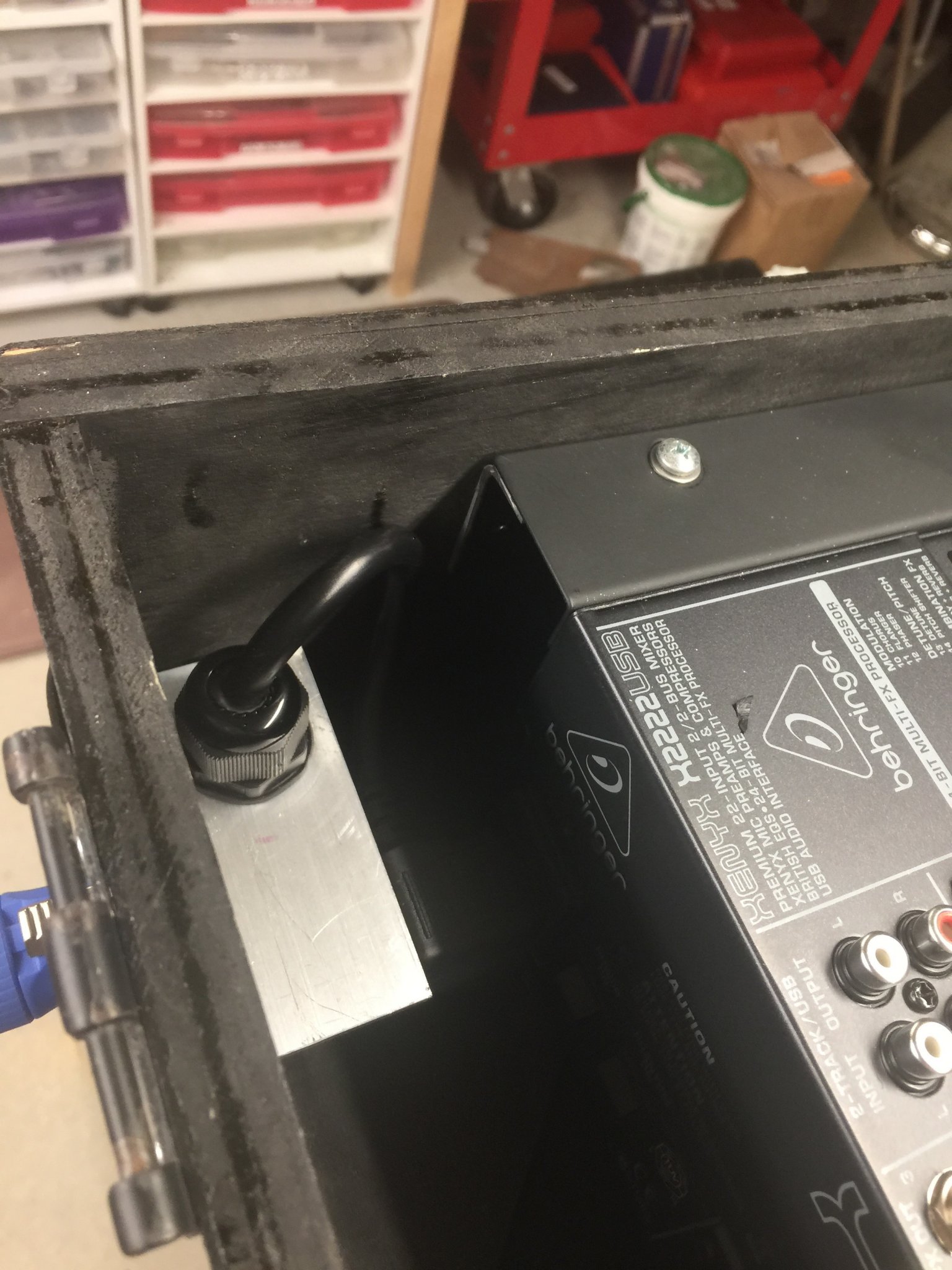

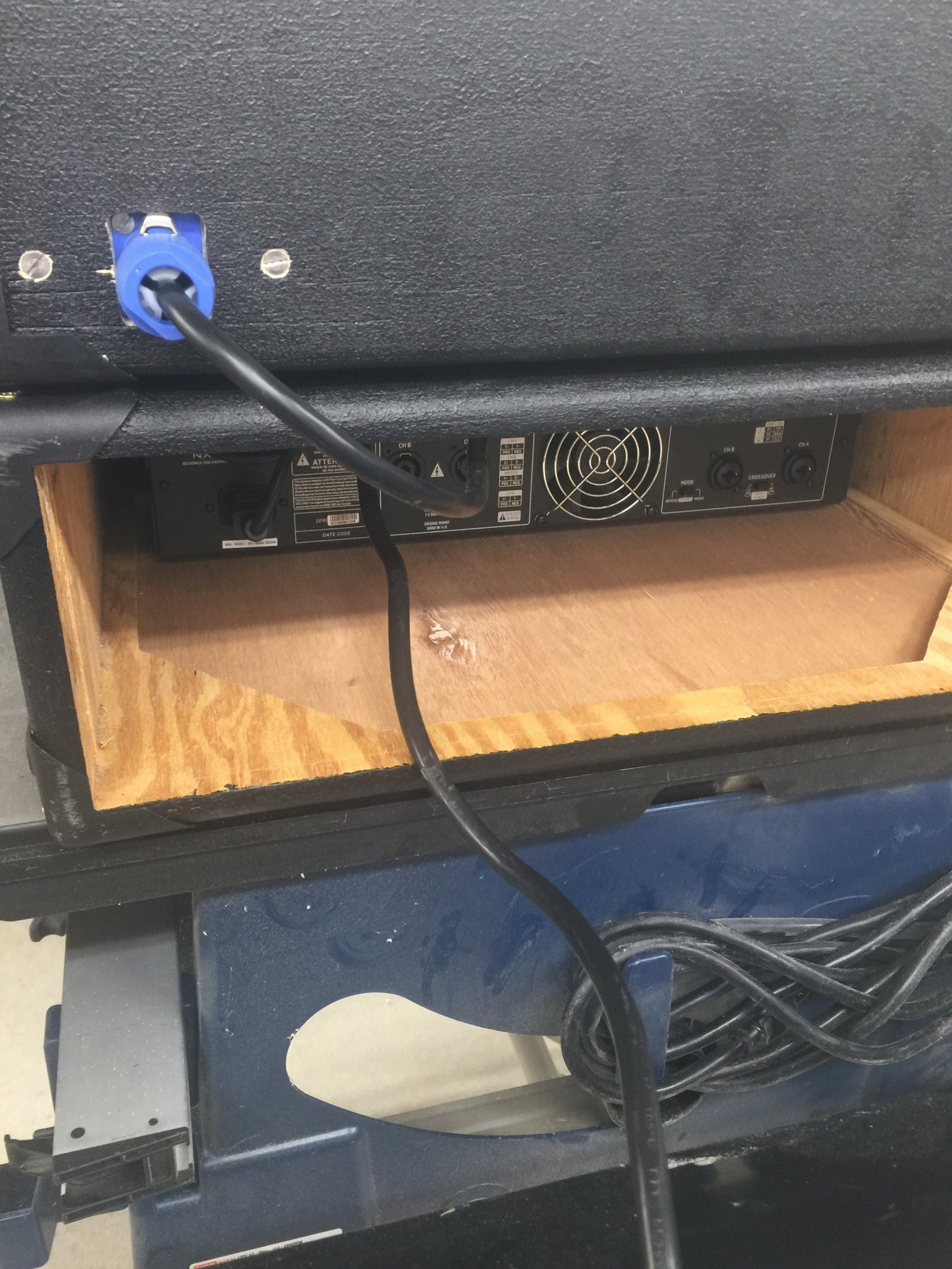

Finally added the powercon feed to the back of the mixer case.
Purchased a pair of IEC cords, one right hand, one left. Wasn't sure which would work better.
Purchased cable glands to work as strain relief for the cable in the case.
Cut the cable with about 8 inches length from the female.
Made an aluminum bracket and mounted the powercon and the gland. That would have been a real problem if f I didn't have a boring attachment for my mill. Used a unibit to get out to about .8 inch dia, but had to bore to final dimension for the powercon, roughly .930 dia. I took 5 mils per pass as I have a mini-mill, only 500 watts drive and it's not as sturdy as a bridgeport. Also funny is, I chucked the unibit into an R8 collet as the jacobs has a few mils runout. Kept the X/Y position to within .0002 inches, then ran the boring tool. I noted that the unibit didn't keep the hole round despite using the R8. The first boring pass at 3 mils cut was really noisy because it was interrupted, but subsequent 5 mil passes were quiet as can be. Honestly, I don't know how I built anything in the past, my current workshop is such a pleasure to use.
First is the mixer/amp stacked. AC feed is just long enough, the second cord is the power strip cord.
Second is showing the bracket with the line cord coming out of the gland.
This power cord is exactly long enough to stack the two, power is about 15 seconds to connect. I will just keep it in the amp case, as it's a pain to reach in and plug it into the power strip. Should I want to put the mixer on a stand, I will make another power/line feed cable set, probably 6 to 8 feet long. But most of my gigs are set and forget, I rarely find myself tracking performers.
Next I will do a small aluminum plate to add 3 xlr panel males. One right, one left, both for balanced outs... and the third will be a stereo xlr, unbalanced to feed the amp case. Given I am controlling the power/signal loop area, there will be no hum unbalanced. My goal is to take roughly 30 seconds to have a complete system setup, with another minute or so to connect the speakers. The majority of setup time will be hoofing the speakers and stands. For that, I just play the victim (gravity wise) and have others do the heavy lifting..
