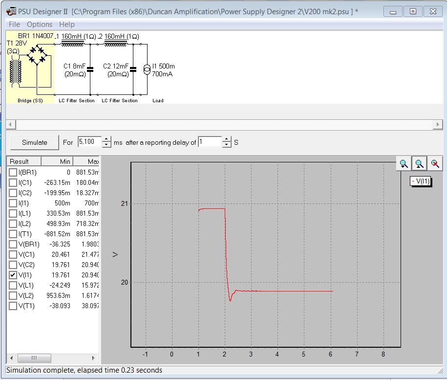

I already had 4 of the LL1694/1.5A version. If you model the PSU in PSUD2 software then you can simulate the peak current draw. The inductance will be lower for the 2A version, personally I wouldn't go there unless necessary.
Here's my latest PSU (parts bin special):
Got tips for modelling in PSUD2 if you need.
Mike

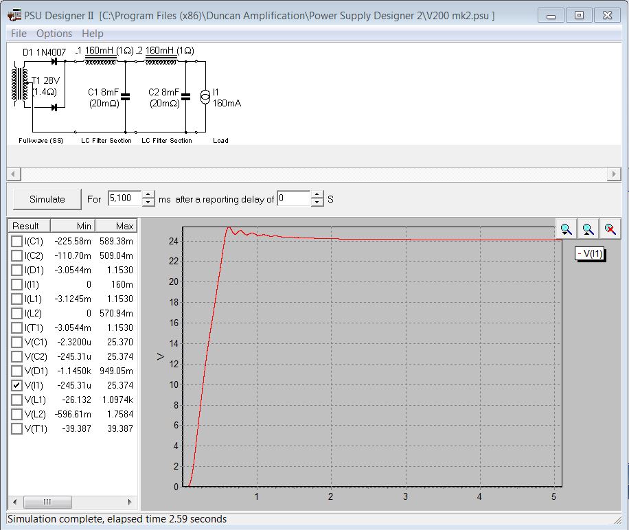

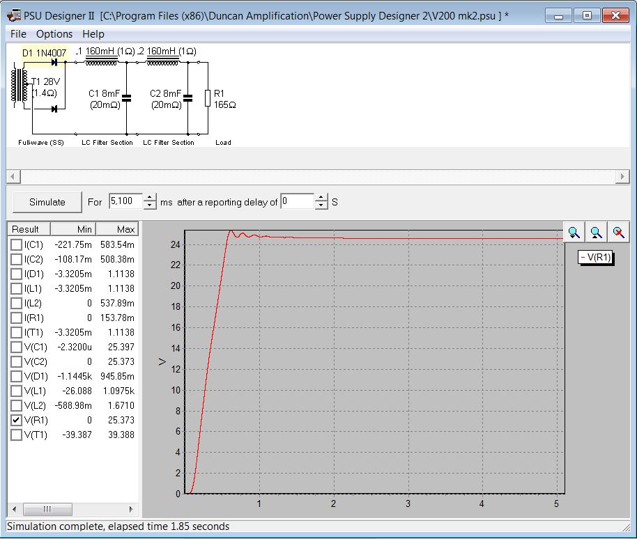

Built the "parts bin" PSU shown above. With resistive loads on the output, voltages match simulation exactly.
It needs at least 160mA current draw to behave like a proper LCLC supply.
I'm "currently" (ha ha) running two 330R 25W resistors permanently across the final cap to ensure this is (nearly) met even without a load. Also to discharge the caps upon power down.
Constant current load:
Resistive load:
Listening tests soon!
