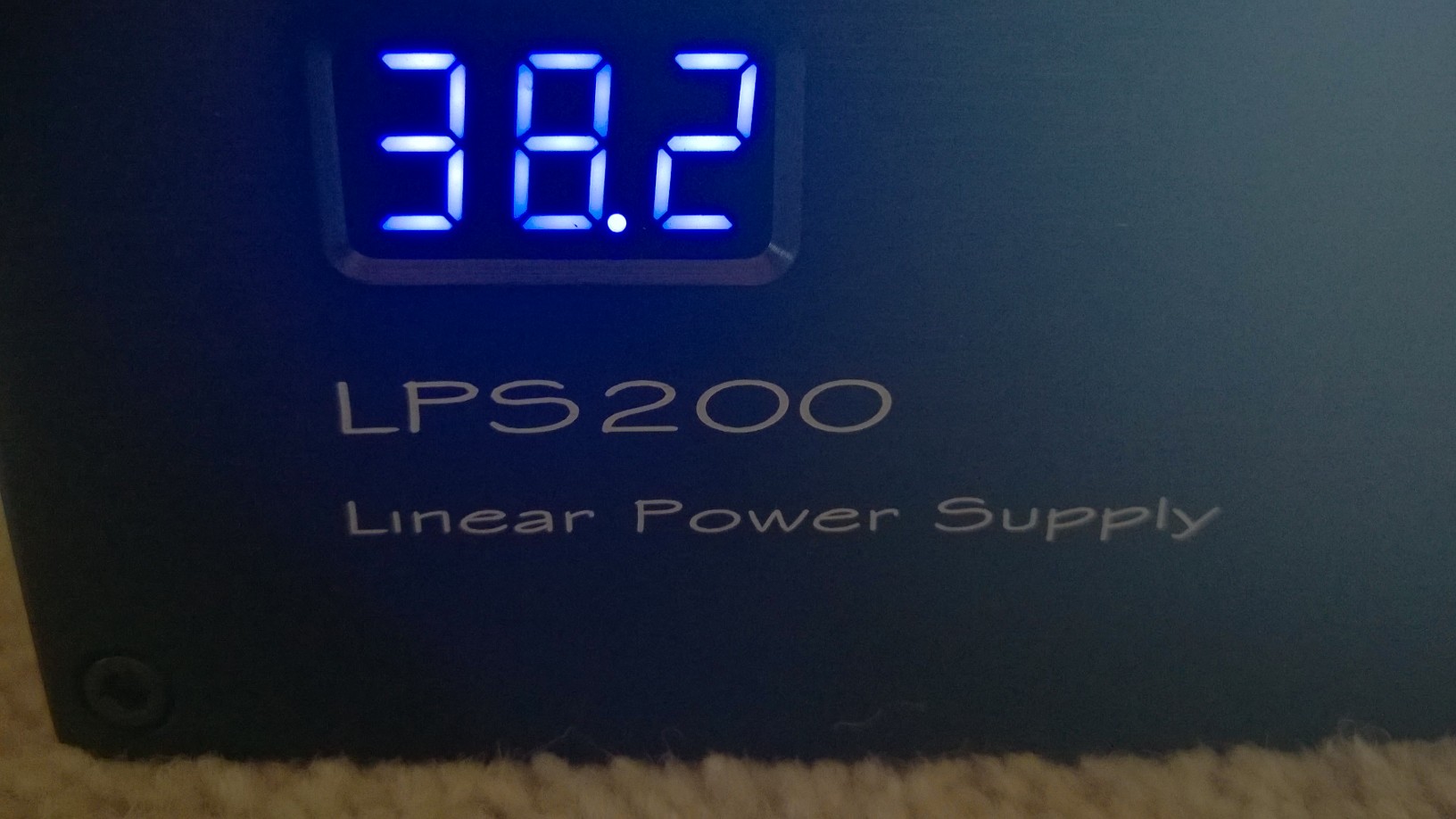

Just a warning for anyone ordering the LPS200 power supply:
With 240V/50Hz input, it outputs 38.1V unloaded and 37.7V loaded. This exceeds the 35V rating of the amplifier capacitors...
So make sure you check this with ICAIRN before ordering.

Here's proof of the overvoltage problem with the LPS200 PSU, with a 240V mains voltage:

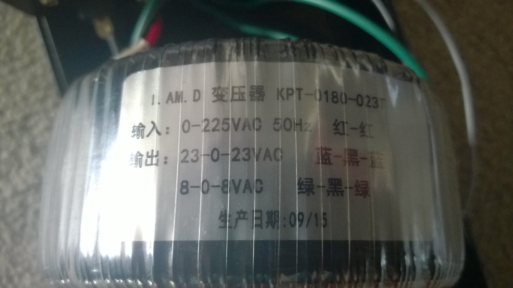

Here's why. Note that the transformer is different to that shown on ICAIRN Audio's product page. On the product page it shows a 20V-0-20V transformer.
Also note this transformer is rated for 225V on the primary. It hums.

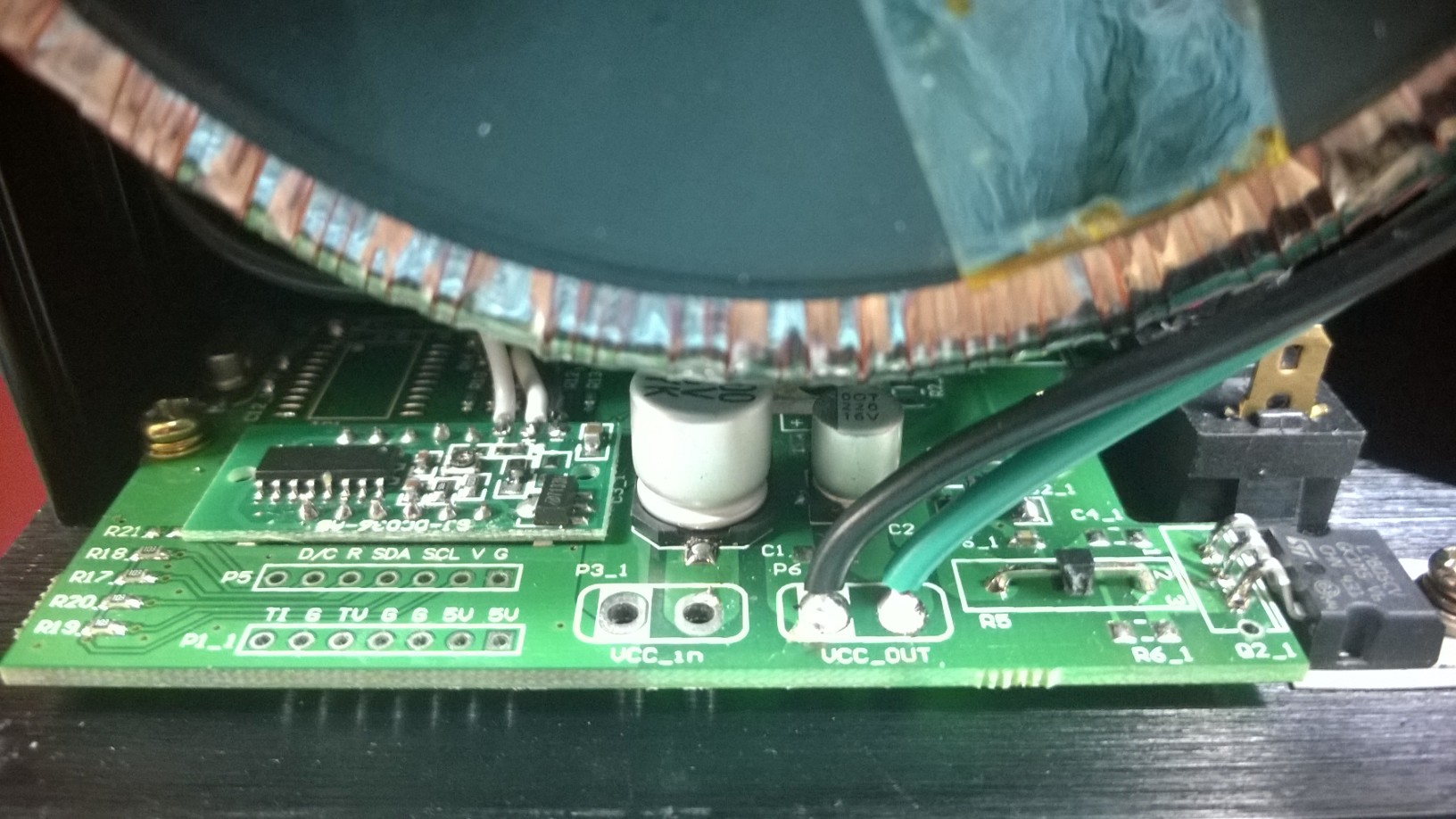

Front panel of the PSU. You have to connect an auxiliary supply here, 16VDC max.
Fortunately the Connexelectronic SMPS300R has a 13VDC aux supply.

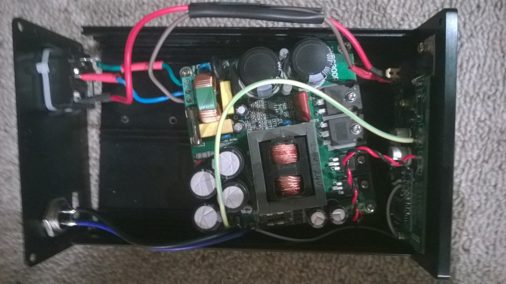

There's a good reason why I have skewed the PCB like this.
Unfortunately the Connexelectronic PCB's don't have enough room on the edges to locate in the PCB slots in the case.
And the mounting holes are unfortunately placed.
Skewing it like this allows use of the PCB slots (to locate two corners), and the other two corners are held down using the 2 standoffs from the (now redundant) LPS rectifier PCB.

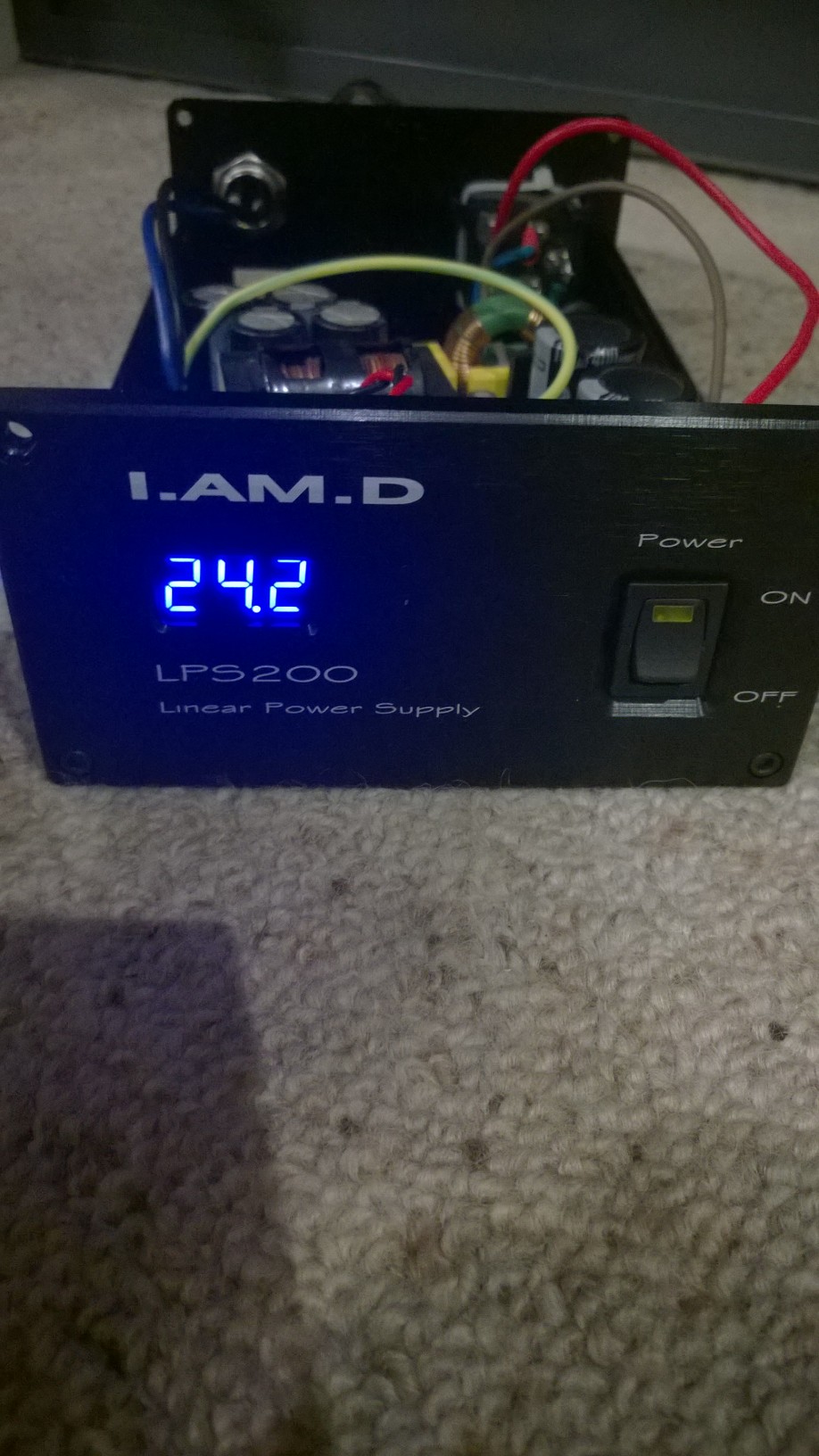

Final shot. 24V and change, exactly as promised by Connexelectronic. Dead quiet.
Nice to have a product that delivers as promised 🙄
