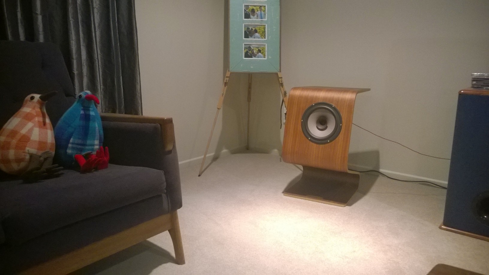

I was running my "little" OB's (Seas Fa22RCZ) H1597-08 FA22RCZ
from a V200 fed with 18V from a TPS7A4700 Evaluation Module - TPS7A4700EVM-094 - TI Tool Folder (1 amp). Worked well!
