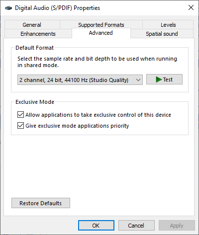

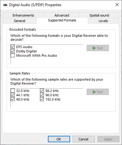

Hi everyone,
Is it normal with the D802 that it is dead-silent with nothing playing back, but if you play an audio file even of pure silence, you get some hiss coming through your speakers?
I was able to minimize the hiss by setting these settings in Windows, but i'm hoping i can cut most of the rest of it out.
It's inaudible during medium or loud music, but during silent or near silent parts it's bugging me a lot!
attached files are windows audio settings for minimizing the hiss sound... a few settings were more noisy than default (just 44.1 and 48khz selected, and set to 16 bit 44100khz)

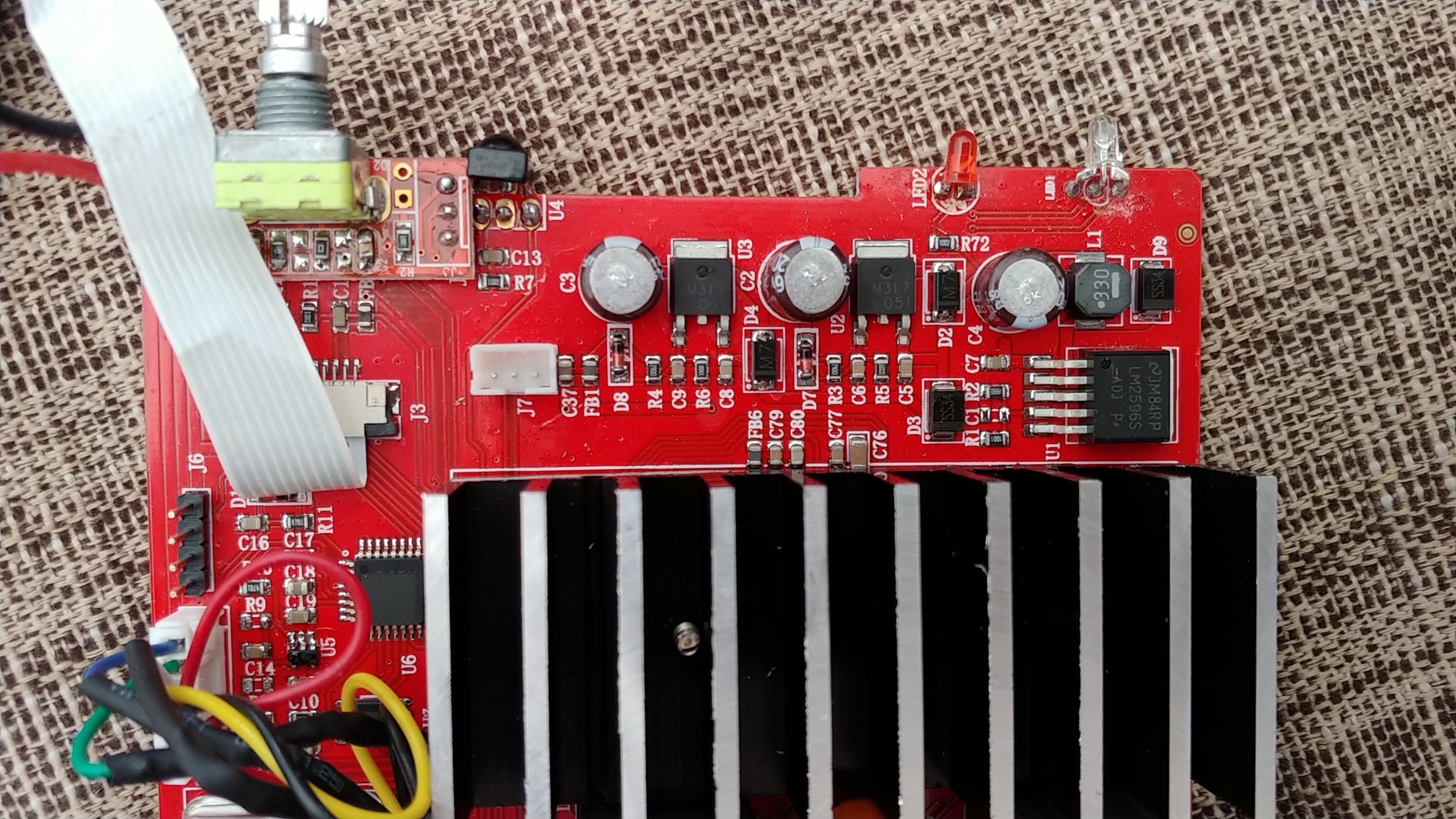

Has anyone installed this mode on the FX-D802C Pro model? I have the Pro and get the pop because of the automute so would love to disable this. It's especially bad for the speaker level input I use to my sub.
Unfortunately the Pro model uses a slightly different PCB and the I2C pads aren't there, see attached pic. I've hunted all over the board and can't find any pads with the I2C labels for GND, SDA, SDL, or 3.3V. J6 does have a GND as tested with my multimeter, but is showing 4.7V on 2 other pins so I'm not sure if that could be I2C or not. It's only 4 pins.
Keen to know if anyone else has had any luck disabling the automute or stopping the pop on the Pro model?

The hiss could be as a result of embedded Windows mixer dithering. Did you have the same hiss during playback with WASAPI Exclusive in Foobar2000 or smth?
Is it normal with the D802 that it is dead-silent with nothing playing back, but if you play an audio file even of pure silence, you get some hiss coming through your speakers ?
Yes it is "normal": It has a bad (real) S/N ratio, because of the 150khz switching regulator (no noise reduction optimization) and a bad PCB design (no separated ground planes...).
