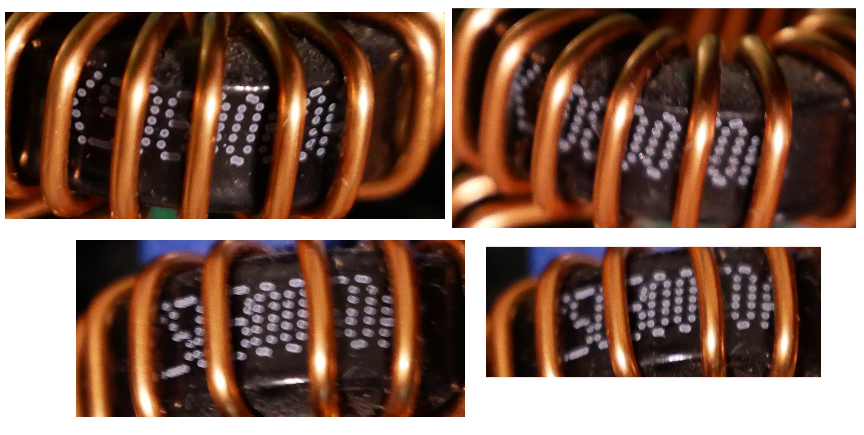

Hugh Jazz, could you please take a better picture of those black core marking? I wondered if there really sendust instead of micrometals #2.
Not much better - but as good as I could get. The wires wouldn't budge so I can't get more dots to show. It seems there are 9 characters. K5080050A ?

?????????23.62MM ??13.39 ??8.38MM KS090-060A-???

T94-2??MICROMETALS ?????????? ?24*??12*?8-???

PS: T94-2 requires 35 turns and only less gauge wire could fit in.

You need 10uH or, Ok, 7uH, 22 is too much. I'm not sure if 2.5RMB for winded coils ok and there is really good-linear #2 material core, rather chinese "analog"(original as you see 6.5RMB for bare core). However, I think it is possible if chinese material #2 is good enough. To make sure I would like to measure THD+N, either buy Micrometals #2 for $1 and wind the coils by yourself.
BTW, I prefer gapped ferrite core for some reason or reasons. Not sure if you'll able install there yet but you can try Sagami or some good Chinese copies of that as well. I know and working with Senija and Miden both ready for my customization and can send from 2-5 samples(Miden only).

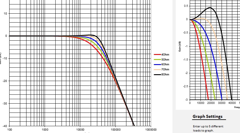

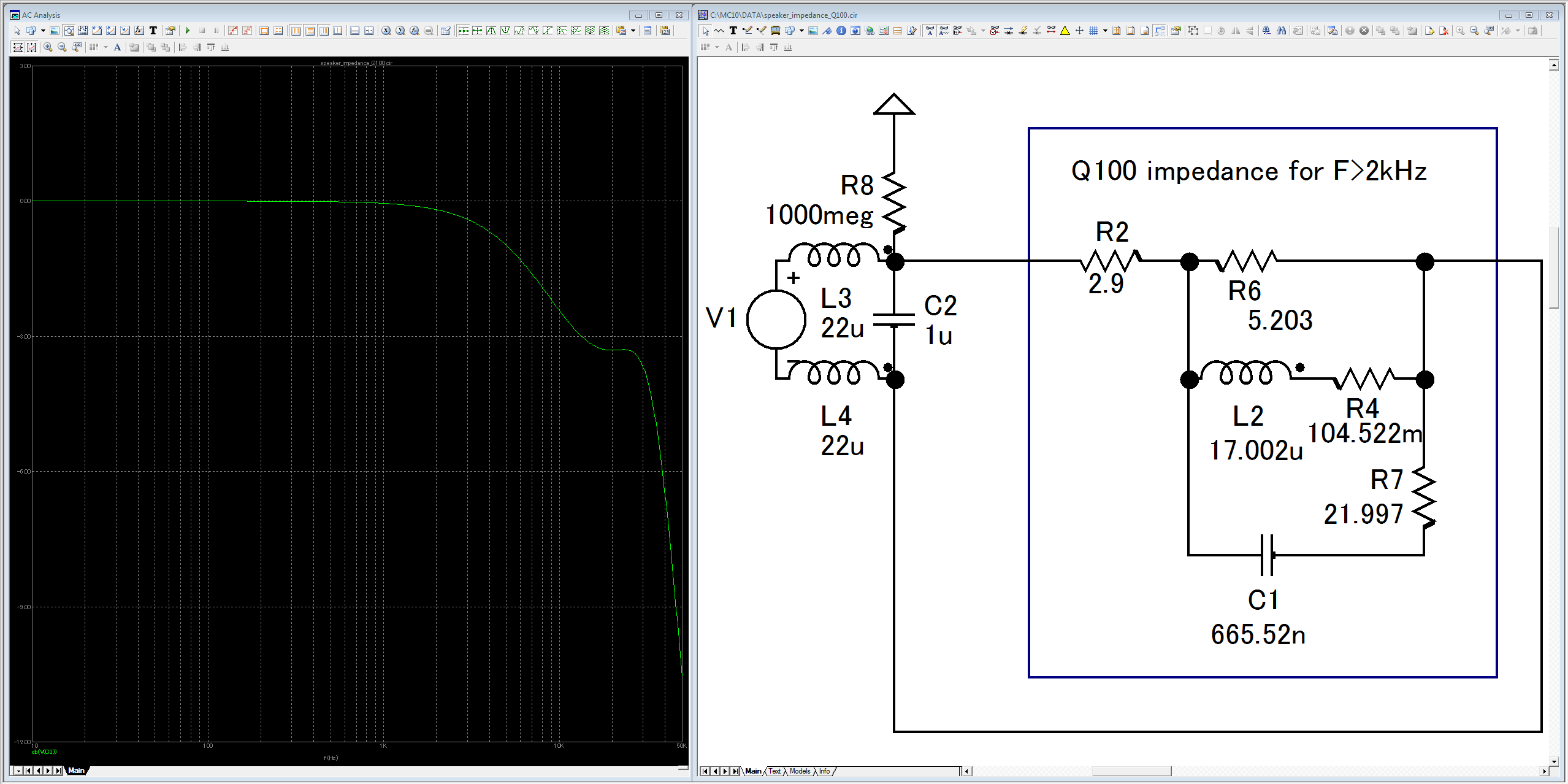

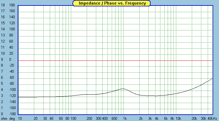

I have lots of amps, and several class D and class T to compare. Filters set for 4ohm speakers can sound a little too sharp with Q100 but it does depend on the amp - some Tripaths are a little warmer than some TPA3xxx so... The tweeter is not the sweetest sounding thing I've heard so sharp can sound harsh - the speakers are 4 ohm but in the treble range, which the class D filter affects, the tweeter is around 6 ohm @40KHz and it has a series resistor too so I work at 6 to 7 ohm for the amp. I started off by putting this into Texas Instruments filter design tool to get values/plots and then tried out a couple. For differential AD, 22uH works with between 0.47u and 1u to suit the speaker/taste. For common BD, 22uH with 1 to 1.5uF works for me. People with different hearing sensitivity/range, rooms reflections, DACs, different coil designs, materials, capacitors, etc. will find different filters work for them. Probably 15uH is a better starting point if you want to experiment. Try and see eh. The filter design of the TAS5614 datasheet is hybrid BD designed for 4 ohm - it will create a lift in the high treble which I don't like. However, the V200 has not followed this and seems to have a differential AD with 0.47uF caps and, at the moment, unknown value coils - does anyone know what value they are?
Zaph's test:
Zaph's test:

Do you know what value the inductors are in V200? In the meantime, if you feel like, try to sim the D802 - inductors are 220uH and caps are 1uF - in BD common mode I believe? Your sim is also missing the tweeters series resistor and capacitor in the crossover - 0.68R and 3.9uF IIRC. This is what the TI calculator predicts, and certainly it does not sound like the treble is at all rolled off.
