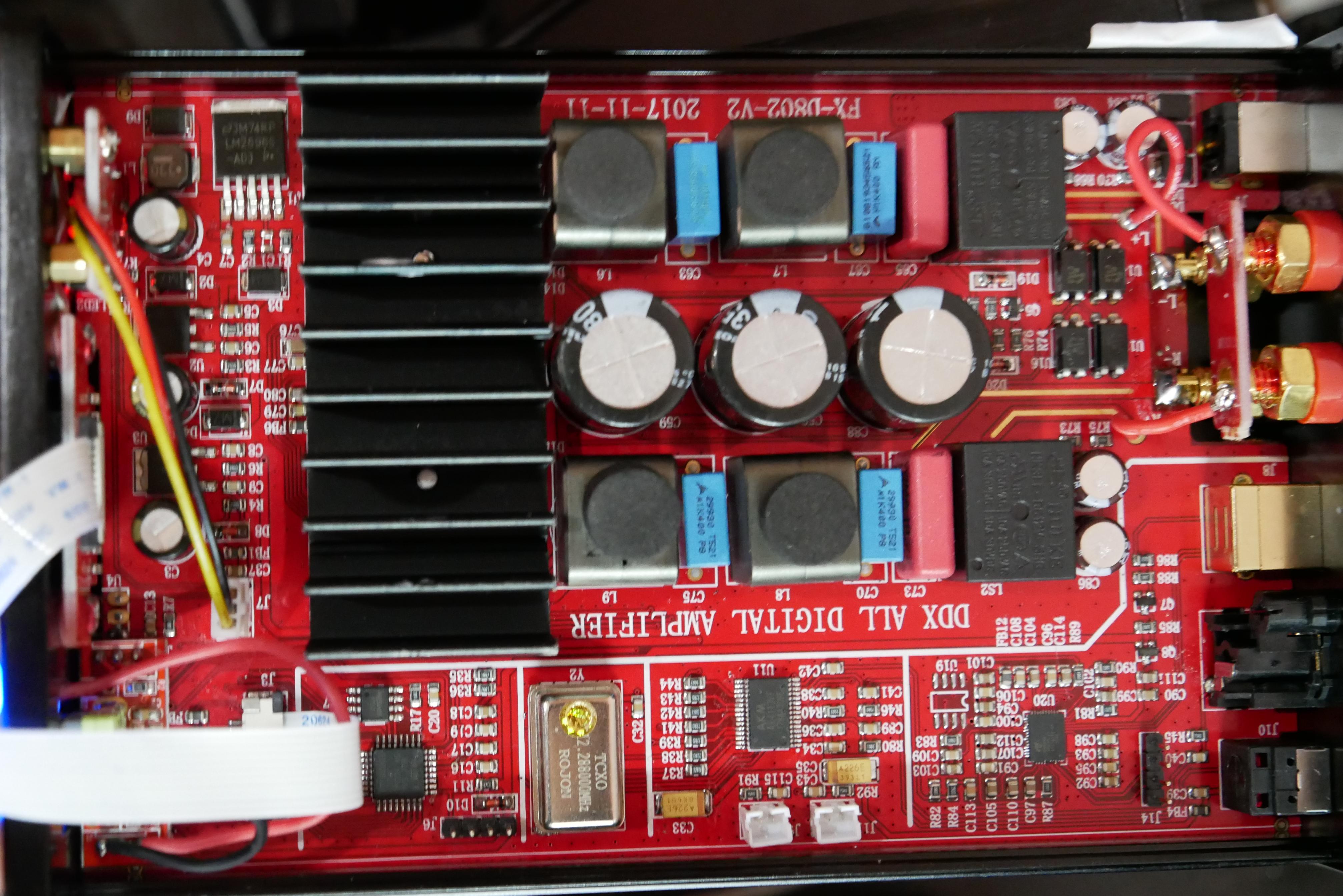

I have made my first mods to the D802 🙂 I replaced the xo with a Rojon tcxo and removed the front button connector (red, black, yellow wires) so I can fit a taller cap there in due course. The wire is a little tight but acceptable.
I have also spent a little time listening and HiFi mode defeats all the chosen eq settings, incl "flat". So I guess this is the pass through mode. It sounds more dynamic with better vocals than "flat" anyway.
The claimed phase noise of the Rojon. Decent if true. I will spend some time now working (yes really) and listening 🙂

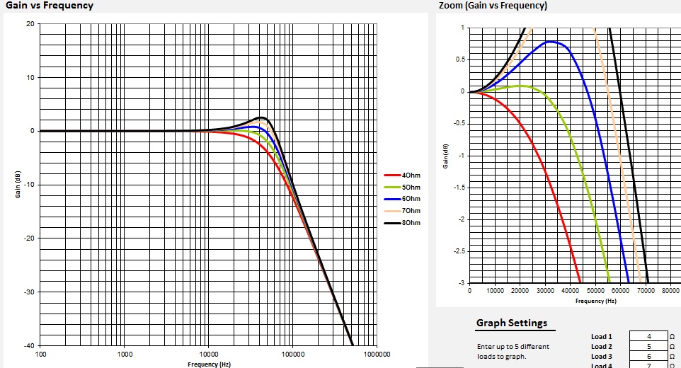

Hugh Jazz, but what could be wrong with such trivial simulation yet where are only linear components? Are you kidding me? )) I guarantee you'll get around -3db at 20kHz if will go with 22uH coils and 1uF capacitor in full-bridge(or 44uH - 1uF in Half-bridge) if load impedance 4-6ohm, it is like 2+2=4 😉 I could agree if someone may like such roll-off but it is another story.
The error appears to be at least 2 things - the speaker has a crossover with 3.9uF and 0.68R in series with the tweeter so the sim's resistance looks too low, (one might argue that the woofer and its inductor should also be in the sim, along with back emf and the like, but ... no need for this I suppose) and the output filter should be common mode with 2x 1uF caps to ground and differential with 0.22uF across the speaker. Then we'll see if your sim differs from Ti's result with the same.

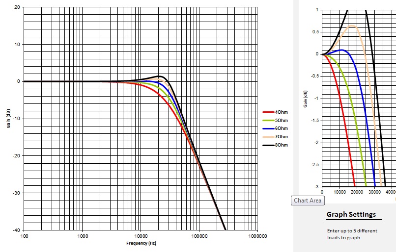

The plot in post 527 above is from Texas Instruments filter calculator and shows a filter apparently designed for six ohms. This is the same filter that is in the D802 and the same filter that I described above - 22uH with 1uf common filter caps and a 0.22uF differential filter cap. When the impedance of the Q100 tweeter is added to its crossover it is roughly six ohms. From the maths and measurements, the D802 and Q100 are a pretty good match and it sounds that way too. So, it seemed to me that you had not done the sim correctly because it showed a significant roll off which would be easy to hear. In fact, I'm simply repeating what I said in post 511 - that 22uH plus a common mode filter of 1uF is a good match for Q100.
The V200's filter is unknown to me at this stage. Guessing it is 10uH and 0.47uF differential, it is suitable for 5 ohm tweeters according to the Ti calculator. Screenshot attached. I'm assuming the reason the sound is somewhat dull is that the spdif receiver is the high jitter CS8416. That has an xo so perhaps upgrading the xo to something with low phase noise might help. As I said before, it looks like the inductors are only a small part of the problem.

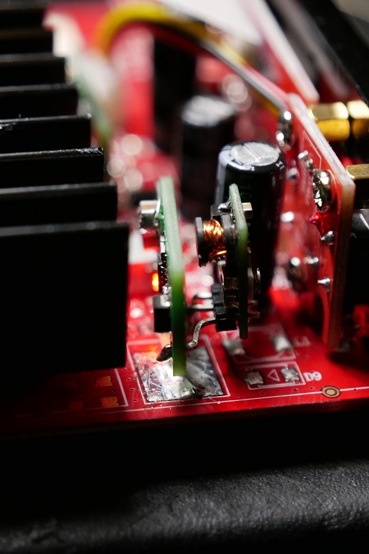

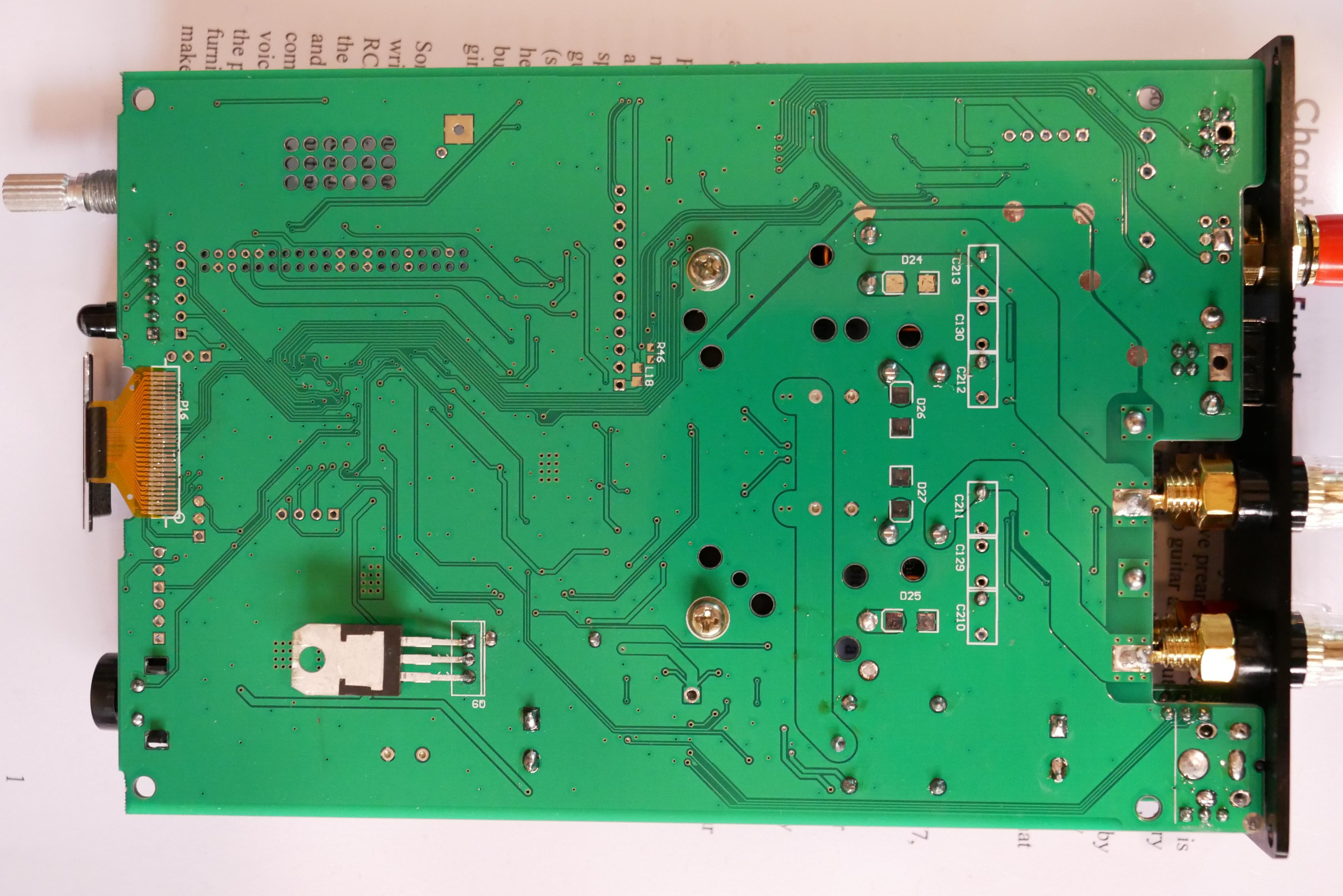

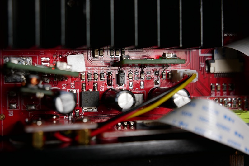

I changed the 12v and 3.3V regulators, added a 47uH inductor for the 3.3V, and replaced caps in the D802 - and am very impressed with the sound now - that Rojon tcxo is good but it needed better power. I also got rid of the blue LEDs behind the volume dial - tacky. A minor re-route of the red/yellow/black button wires too.
The LM2596 and its bits are gone and instead there is a 550kHz switcher set to 12.8V that is fitted with an LT3045 set to 12V with fast start up and Cset of 22uF. I removed the diode (D3) that feeds 12V to the 3.3V reg and fitted a 47uH inductor. The 3.3V LM317 and its bits were removed and replaced with another LT3045. I'm using a linear power supply for the amp. The three 470uF caps were replaced with 1000uF Pansonic FR 16V, Rubycon 1200uF ZLH 6.3V and 1500uF 6.3V ZLJ.
Not much else worth doing to this amp now but it does sound really good. I'm impressed and very pleased 🙂
