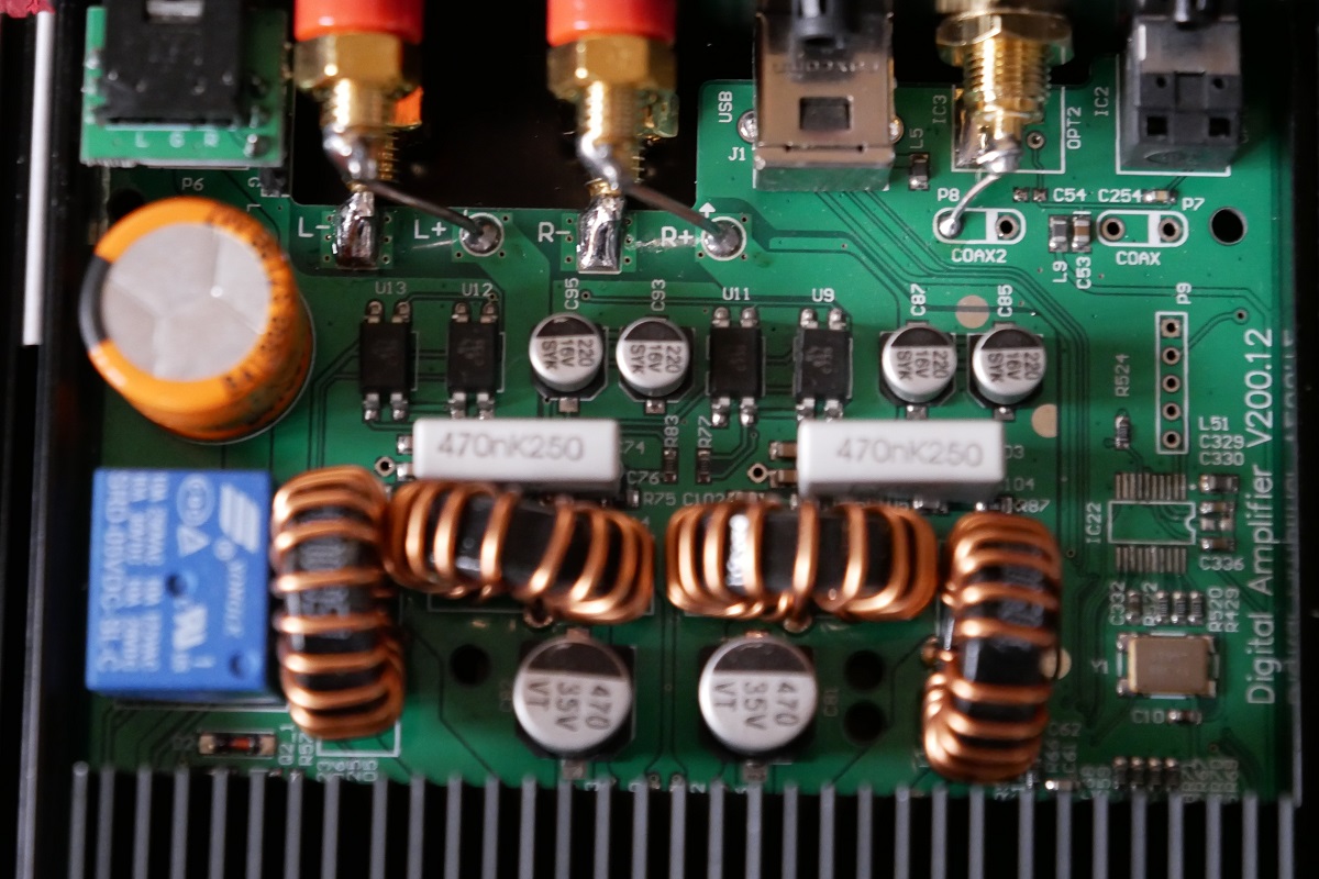

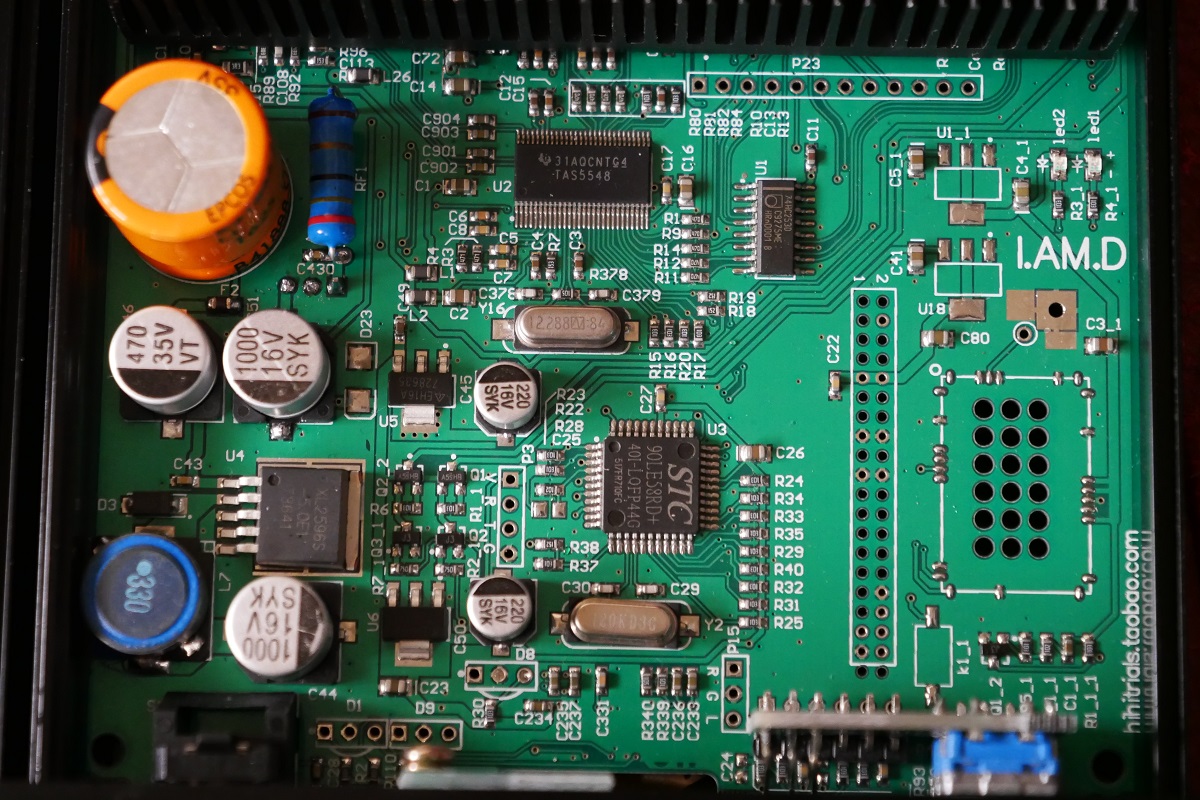

I got a V200 (Version 12) and D802 (Version 2 11/11/2017) and plan to upgrade the D802 first since it will the easiest do I think - regulators, tcxo, maybe add a bluetooth and an output for a subwoofer.
Does anyone know what caps C85 and C86 do in the D802? They are 16V 220uF - middle of pic 3. There's another pair like that on the left too.
Here's some pics. At the moment, the D802 v2 has a better soundstage than the V200 v12 but the the V200 looks like it has more potential for improvement.

Hugh Jazz, could not believe but I see again sendust ring cores in class D amp which suppose to be called HiFi? Tell me that I'm wrong due to unclear picture and core material is not sendust, please! I used sendust cores ONLY with subwoofers class D and only with lots of loop gain of fb taken after thse coils. If there really sendust, it is number one contender for a tweak for sure ))
marking makes difference but I never have seen black coated core material#2 which is good for linearity, black coated core with white marking always chinese sendust or korean sendust in the best case.
It seems from the pics I took that they are wired as super e caps (in series, neg to neg) with 2x 1K resistors to ground. This would provide a high pass of 2K with a corner frequency of 0.7Hz. So, a dummy load, on one pole of the relay? Or...? It seems likely - I guess diodes U14-U17 are there to protect the amp's outputs on the other pole which connects to the speaker terminals...Does anyone know what caps C85 and C86 do in the D802? They are 16V 220uF - middle of pic 3. There's another pair like that on the left too.
Hugh Jazz, could you please take a better picture of those black core marking? I wondered if there really sendust instead of micrometals #2.
Sure, next time I open it up... I have a few things to investigate for the V200 v12 - there are so many empty pin outs but with the smd components there, ready for an IC. For example, the pin outs for the ADC (U22) match the PCM1803 which other versions have. Anyway, let you know about the coils when I get the chance to open it again 🙂

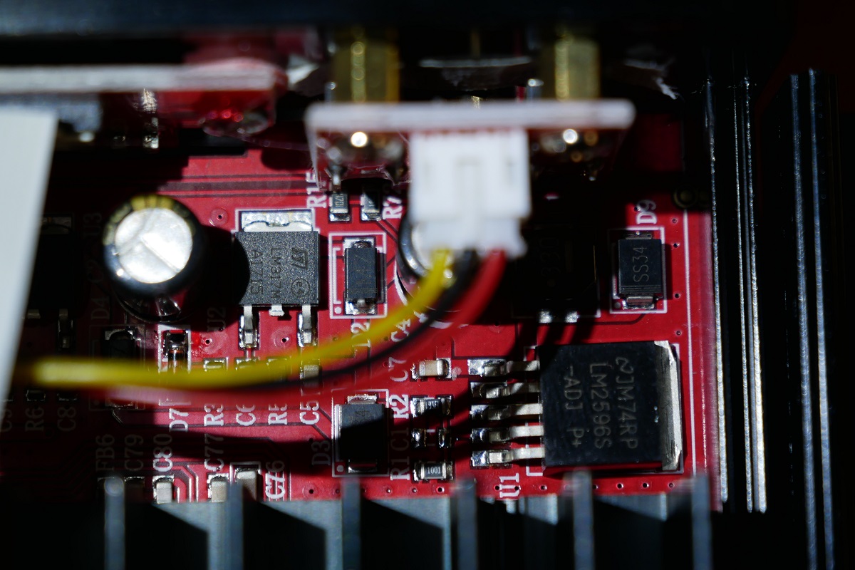

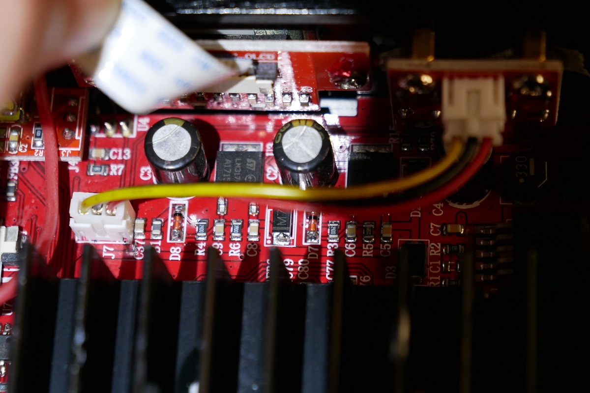

I need to open up the D802 again too - didn't get good enough pics of power routing. My earlier thought that each regulator fed the next lower voltage one seems to be wrong. It seems the LM2596 is 12V for the relays and it feeds two LM317, one for 5V and another for 3.3V. This has me thinking what is the 5V for? The CM6642? And can I re-wire them to get the benefit of combined ripple rejection? We shall see...
Hugh Jazz - I don't have a D802 yet, but from carefully flipping back and forth between pictures and following traces I'm pretty sure the 3.3V and 5V regulators are both fed separately from the LM2596. This is also supported by measurements Paulkouhan from homecinema took at the inputs of the LM317s - 11.5V for the 5V regulator and 10.8V for the 3.3V. The latter is lower due to a diode inline with the input. For protection I think?
It appears the 5V is used only for the board's mystery controller which I think is an STM8S005K6 or similar (ask me how I figured this out). The STA326 (digital section), AK4113, VIA1630A and the clock all seem to use 3.3V. Unfortunately I don't have any detailed pictures of a board that uses a CM6642.
Thanks ! I found that thread here <<Tweak fx802>> - 30079404 - sur le forum <<Amplis et Preamplis>> - 1056 - du site Homecinema-fr.com
His suggested tweaks are somewhat similar to my plan... 🙂 I plan to modify the LM2596 for a higher voltage and disconnect its output inductor so I can feed the output of the LM2596 through a better LCLC filter and into an LT3045 which should remove over 70dB of the switching noise to provide a much cleaner 12V. I notice that the implementation of the LM2596 in V2 is changed over V1 (adj vs fixed and better layout it seems) so I'll check to make sure its layout has been done to stop noise contamination. Jean-paul says 100mV for LM2596 https://www.diyaudio.com/forums/cla...d802-optimisation-tpa3116-33.html#post4798922 and that seems about right - it can be reduced with better output filtering, but even so, with 70dB reduction, a factor of about 3000, it should be 30uV or so. Then replace the LM317 with TPS7a or LT3045 and they should be able to hit their noise floor if the LM2596 is not contaminating ground. If it is, then I may need to fit one that has its own PCB.

The LM2596 is the weakest point. I replaced if for a ready built SMPS module and that was a large difference.
Yep, for sure, and it has just 33uH after it in the D802 - Webench says a 470uH 800mR inductor with a 1000uF 1000mR cap will significantly reduce noise to levels more like a 7812. I've seen someone else do this on a similar STA326 amp using a 1mH inductor IIRC ... can't find that post though. My main concern is whether the LM will be messing up the ground. I gather the best test for this is to have a signal lock in the amp but no volume in the source with the amp volume fully cranked up. This way the auto mute doesn't mask the background noise.
