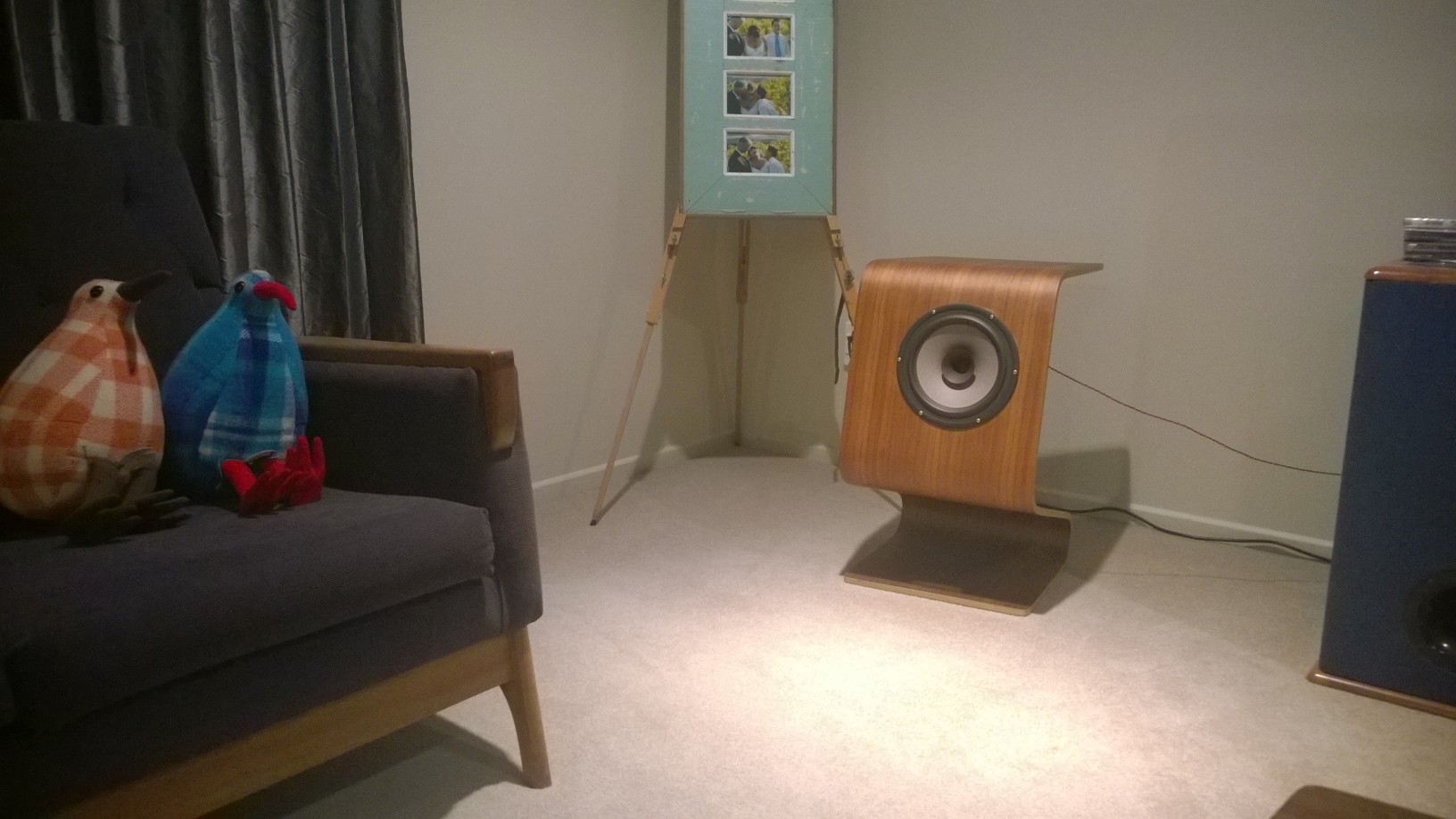

Thanks! No thread yet on the speakers. However they're really simple and sound GREAT!

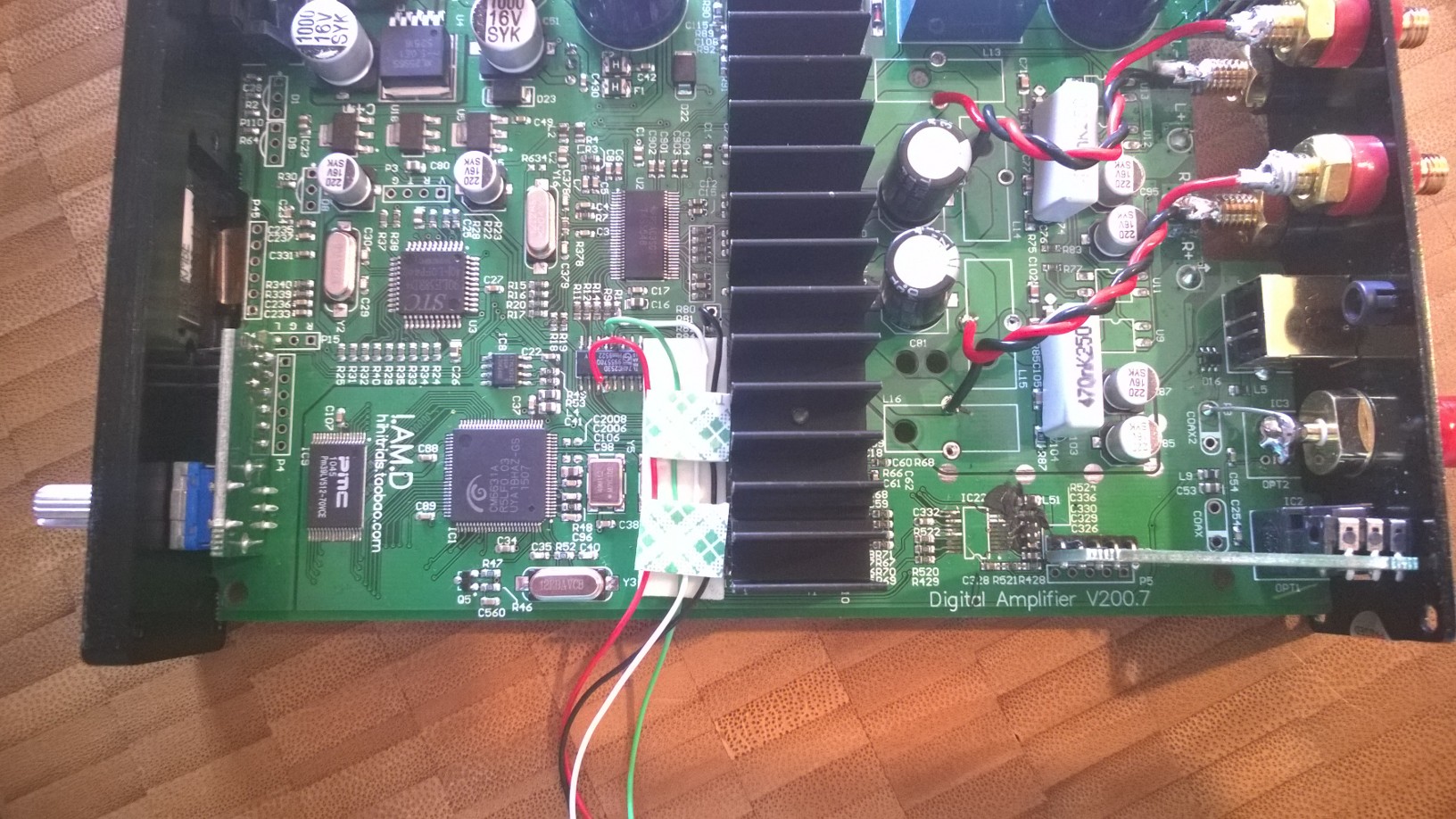

Using a MiniDSP 2x8 as equaliser/crossover. Hacked into the I2S and feeding this to an I.AM.D V200.7.
EQ accounts for the baffle rolloff and suppresses a resonance at 7.5kHz.
I've posted earlier about sourcing the baffles, they're a repro bent ply coffee table
Highly recommended. My big OB's are still in storage (dual 15" + dual Audax PR170M0 + Beyma CP21/F) because these little OB's do everything so nicely and inconspicuously. Imaging is unreal and they are just so natural it's uncanny.
Supported below 50Hz with a sub but you can get away without it. I should sell these...

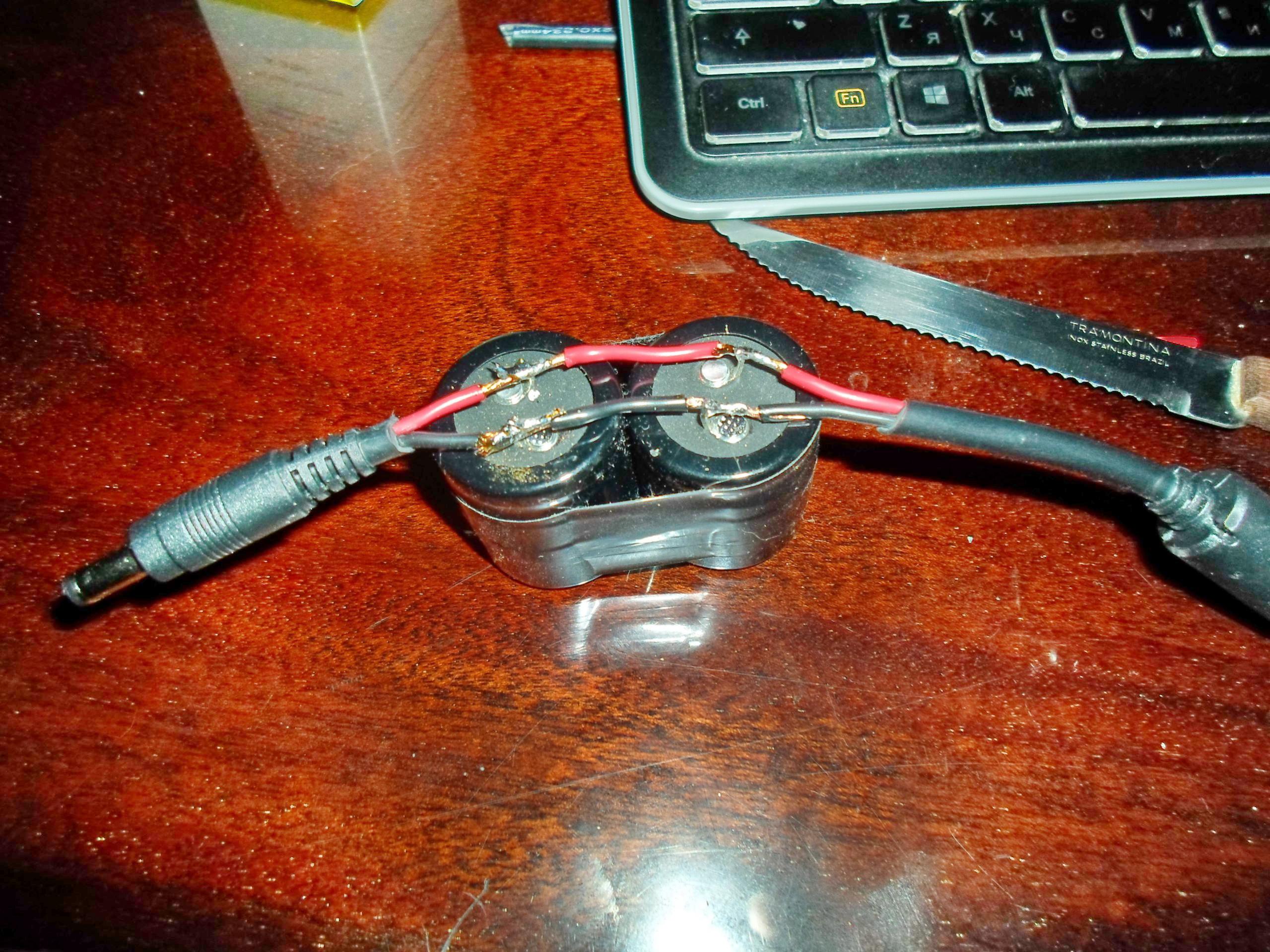

Ok, the latest upgrade!
to upgrade your power supply for Fx Audio d802 or any other amplifier.
get these two capacitors NOVER 50V 10000uF 85 degrees

Good work Eugene! If you want to go further, try this: http://www.diyaudio.com/forums/clas...d802-optimisation-tpa3116-11.html#post4530915

i2s on the v200 in the 74hc253
