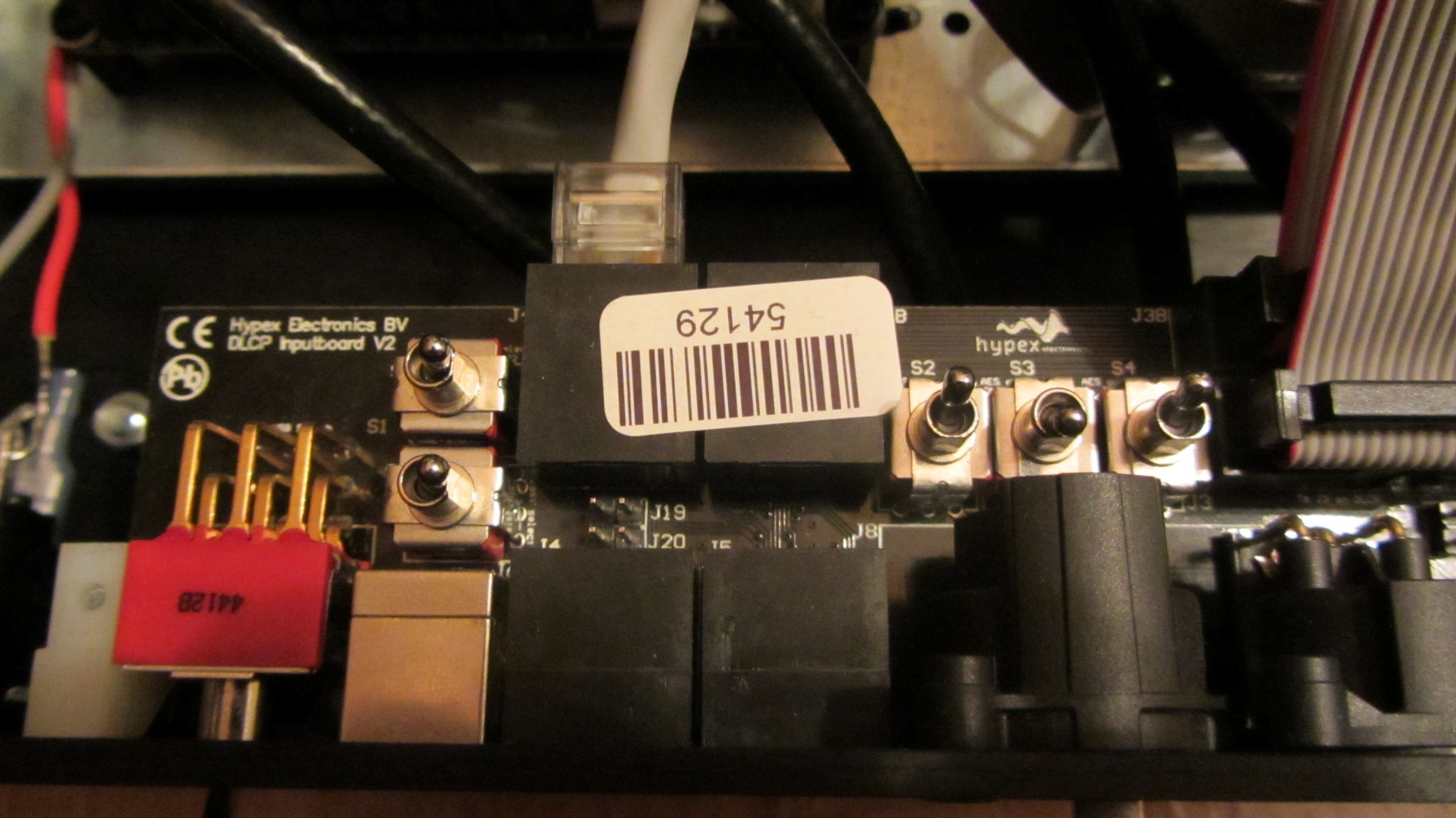

No, still stuck in bootloader mode. Also tried to short pin 4/5 of J6 which got it connected again to the software and enabled me to download the firmware. However, it never came out of bootloader mode. Second time I tried this I short pin 2 and 3 instead 4 and five (didn't find out which ws which in the datasheet) and smoke came from the DLCP board. It's still active and still stuck in bootloader mode. This board is probably going back to Hypex....

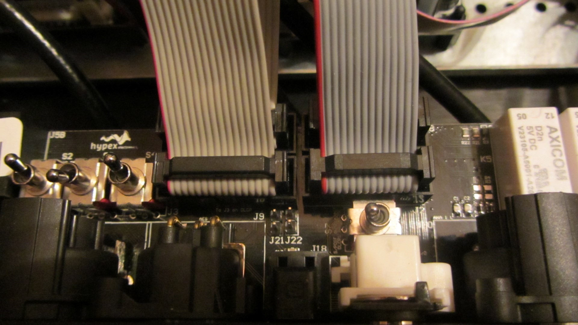

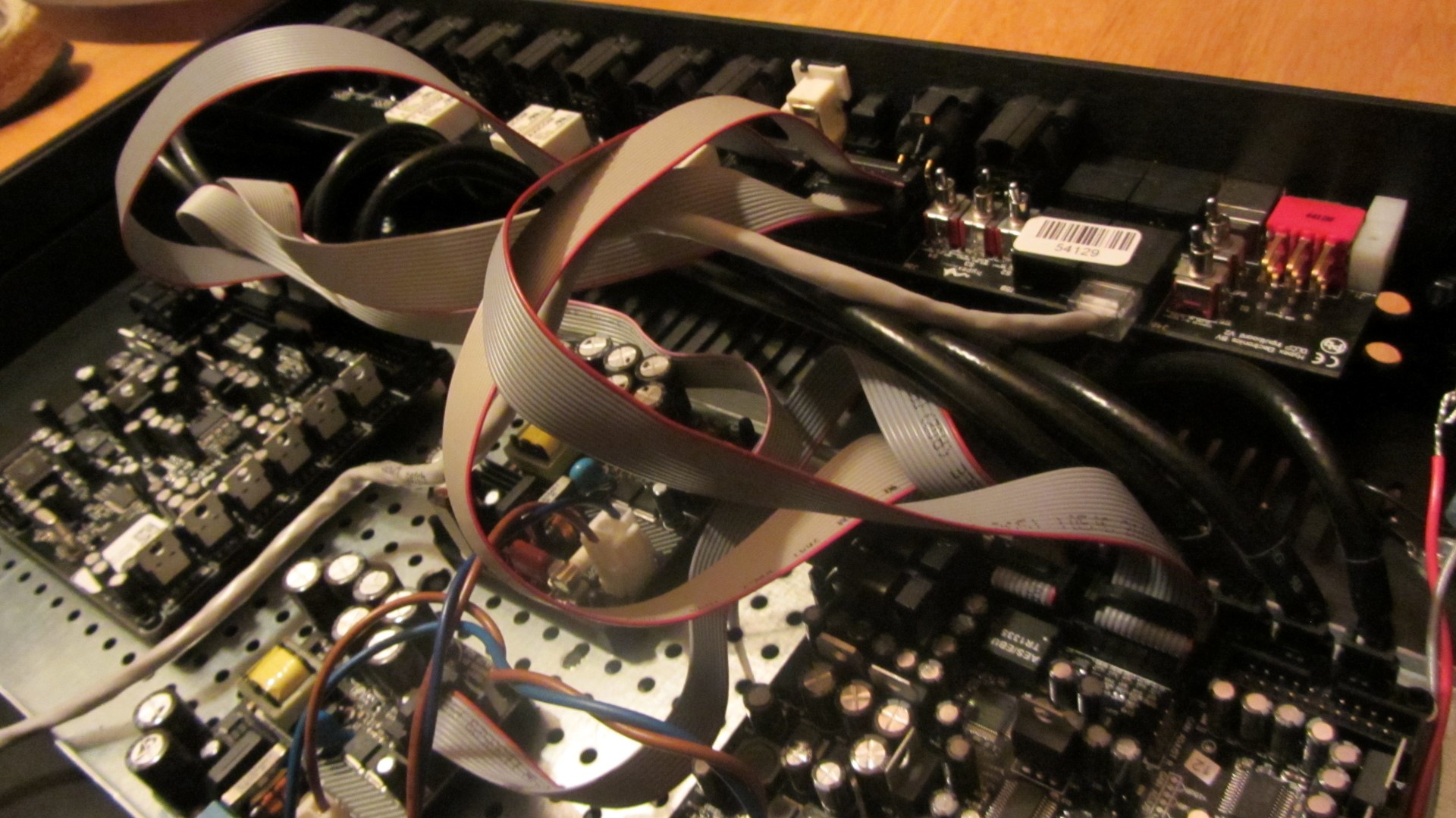

I'm no trying to get my second DLCP with 12 channels running but haven't been successful here either. It says "Waiting for DLCP" in the display. Someone gave me an instruction of how to set up it with 12 channels (somethine Hypex hasn't written in the manual!), but it didn't work. Going to try now to flip the S6 switch.

Not able to to update to anything. And I'm only getting connection when shorting pin 4 and 5.Your controller is in bootloadermode, not the DLCP! Do a controller firmwareupdate (V1.3).
Please stop shorting pin's!!!!
First disconnect the controller and disconnect the power supply from one dlcp board.
Power up, plug in your usb cable and check if the PC is seeing the board, if not flip the switch at the back. Check in the HFD controlpanel if it showing the firmware version ( 2.3).
After this step check the other DLCP board. Also check all the led's are working on the boards.

For pin numbering: please look at the DLCP data sheet. The black dot on J6 (right side when J6 is on top of board) represents pin no 1.
The one being stuck in boatloader mode only has one board. The green light doesn't come on anymore, only the three red ones. The software doesn't see it unless shorting pins.Please stop shorting pin's!!!!

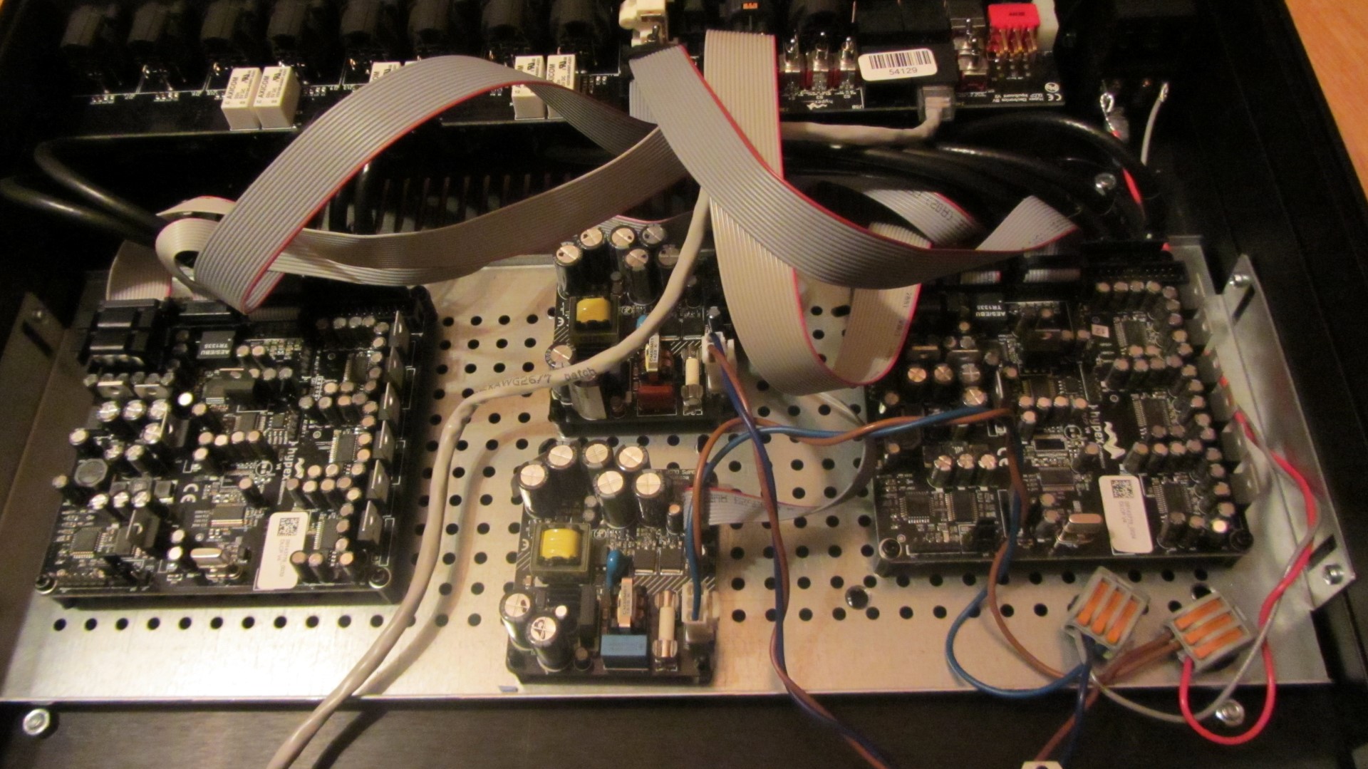

The other one with two DLCP boards is stuck with "Waiting for DLCP" in the display, green light on both DLCPs. Haven't shorted any pins here.
I think you have blown the one with 1 board by shorting pins 2 and 3.
The one with 2 boards, what do you see in the controlpanel?

It connects and says firmware version 1.2.The one with 2 boards, what do you see in the controlpanel?
Are you running a Window's machine?
Windows 7.
Are the switches set correctly for two boards?
You are making the same mistake as StudioAu.
You cannot upgrade directly from firmware 1.2 to 2.1/2.2/2.3. You have to load a new boatloader first.
