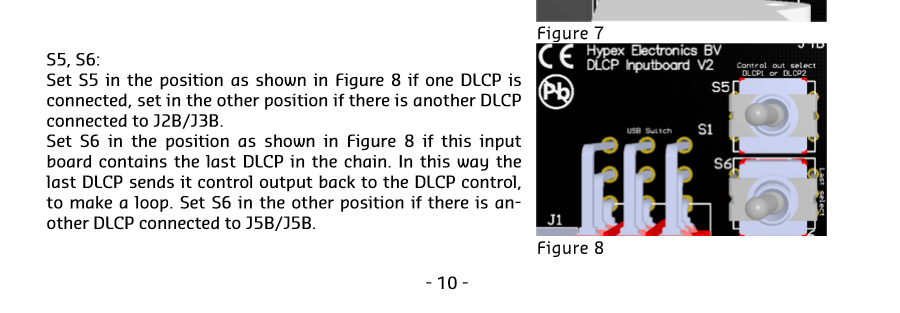

@ Omholt: Did you flip the switch I mentioned for you?
S5 should be AWAY from S1 writing
S6 should be TOWARDS S1 in your configuration (Second DLCP connected to J2B/J3B)
In the picture you published, S6 turns the wrong way. This will cause "waiting for DLCP" since the boards will not find a controller

I had S5 flipped towards S1 as the description said, but S6 the other way. I was able to update the control firmware when S6 was also turned right. The text need to be changed. And again, Hypex have no information on this!@ Omholt: Did you flip the switch I mentioned for you?
The DLCP rebooted afterwards but still went to "Waiting for DLCP". I have now updates to 2.3 firmware and have S5 and S5 both set to right again. Still it's stuck with "Waiting for DLCP".
Try the method from Johan, as soon the controller starts updating you should get the Bootloader mode in the display. If not there is no connection.
I did it and it showed booloader mode in the display. It restarted after the update, but it's still stuck with "Waiting for DLCP" in the display.Try the method from Johan, as soon the controller starts updating you should get the Bootloader mode in the display. If not there is no connection.
The DLCP rebooted afterwards but still went to "Waiting for DLCP". I have now updates to 2.3 firmware and have S5 and S5 both set to right again. Still it's stuck with "Waiting for DLCP".![]()
Text is right.
When installing control firmware with two modules, you flip S5 TOWARDS S1 during the install.
Flip it back when finished.
Do not flip S6. It should be towards S1
Alternatively: Try the method of connecting as a single DLCP. Don´t give up!
