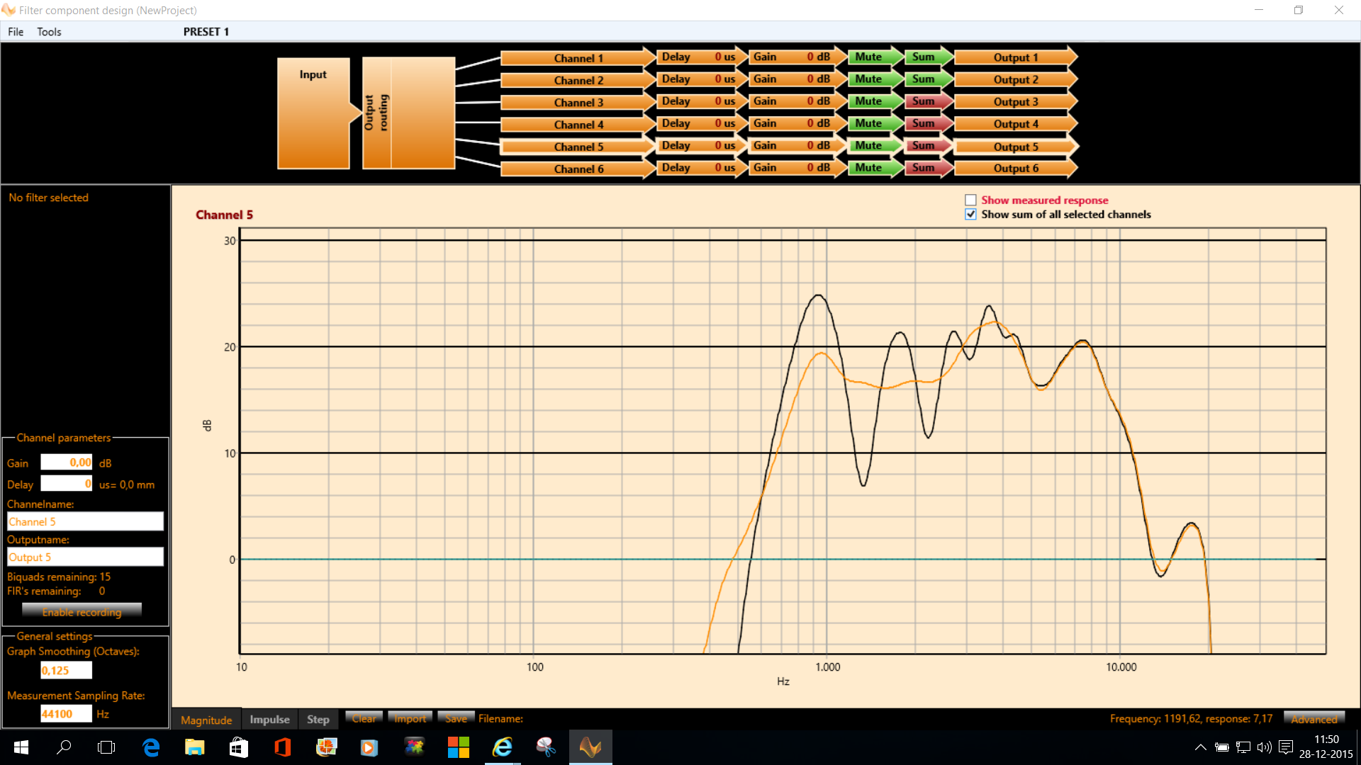

importing REW impulse response data to the DLCP filter design software
Can someone figure out how to correctly import REW impulse response file into the new DLCP HFD software? I can import the file but frequency domain in DLCP HFD is different than originally was in REW.
I was using UMIK-1 USB mic so I understand that I cannot use it directly with DLCP HFD?
This is my importing trial:
and imported to the DLCP HFD:
If we figure out how to do it properly it would be nice afterburner to the decision of purchasing DLCP for DIY people with UMIK-1 and REW!

first get your smoothing the same, then look at them both.
oh, check your sampling rates.
I don't have a usb mic, but I thought you were supposed to be able to use that now with ASIO4All.
Alan

You can use HFD without a Hypex product. So you can test if an Umik will work correctly. The nice thing off Asio4all is the capability to use different soundcards at the same time. But do several repeated measurements to check for latency issues!

Remember guys that it isn't possible to time align drivers with a USB mic. You can't run a loopback which is needed.
Every measuring software uses ASIO, but one still needs to run a loopback on the sound card when signal aligning drivers.HFD does not use a loopback and measures correctly in the time domain because it uses ASIO.
Just tested it, did 6 repeated measurements, all FR responces are the same but there are time differences in the impulsresponses. That's why if you sum the measured channels strange things happens:
This is caused by not running your ADC and DAC on the same clock. It will never be possible to do measurements in the time domain with any program and the Umik. And you need the timing component in simulating the respons.
