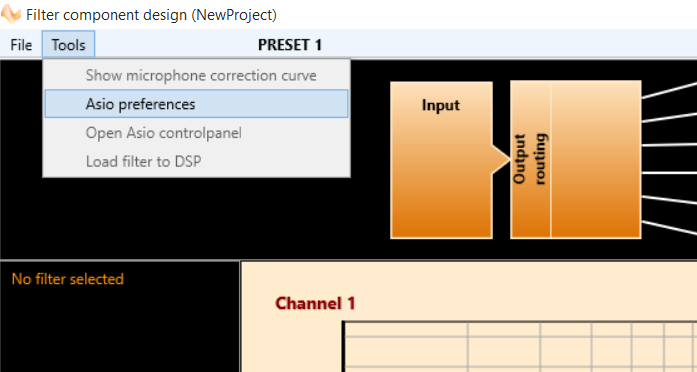

Hmmm the button should appear under Tools (on your top left, next to File). If the application does not find any Asio drivers in the registery, the Asio buttons will be disabled (but still visible).

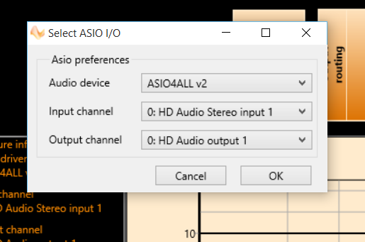

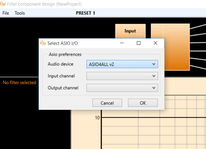

Here we go:
Deinstal HFD if you have it installed in C:/programfiles and reinstal at your D drive or a folder on your desktop.
Install ASIO4All.
Be sure you don't have any other application running which "claims" the soundcard via an ASIO driver.
Start HFD and click ASIO preferences with your soundcard connected:

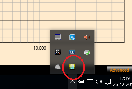

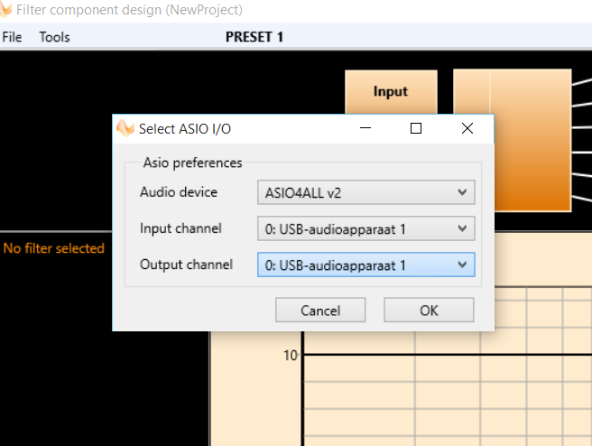

Select audiodevice:
Now you have to see the this symbol in your tray:
If not, restart HFD.
Next, select the in and output channels:

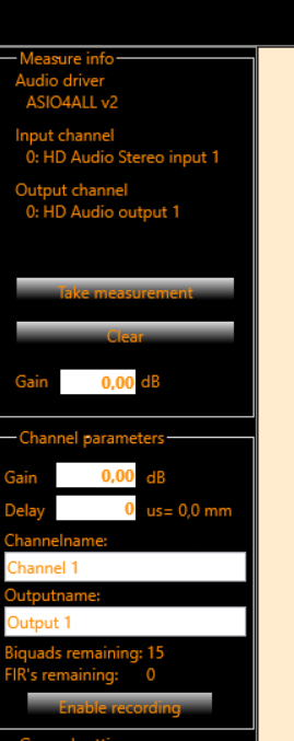

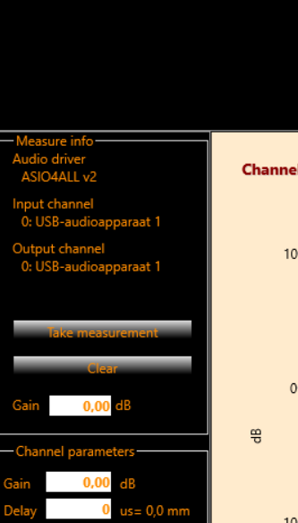

Now this button appears, if not restart HFD:
Press it and you get this:
Now you take your measurements. BTW you have to click Enable recording in every channel you want to measure.

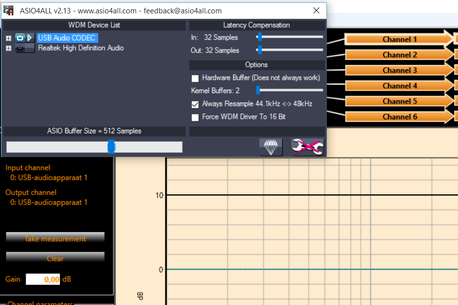

The ASIO controlpanel can also be accessed via the symbol in your tray, you only need this if ASIO4All detects more then one soundcard.
