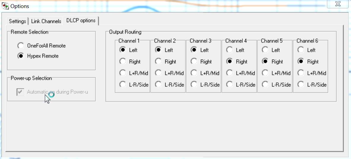

I plan to use DLCP+input_board+control_board+nc400*2 as digital stereo amp/preamp.
(coax spdif and optical inputs only).
Connected all components (ch1=left,ch2=right), but no sound on any input.
As i understand, by default the Unity is a routing input channels onto output channels.
PS I updated DLCP to bootloader 2.0 and to firmware 2.3.
please help

The problem above fixed (had to download my configuration to DSP).

no, default is infinity attenuation
you need to have a profile loaded and gain turned up
is this a new assembly? there are several switches that may be incorrectly set for what you want as well.

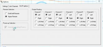

If the controller is connected, you can't control the routing in HFD. You have to do it on the controller.
Of course.If the controller is connected, you can't control the routing in HFD. You have to do it on the controller.
Thank you. 🙂
