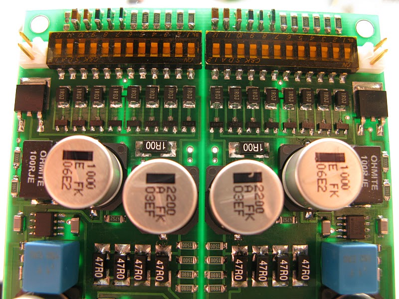

ok, first thing.. this might not be correct. I hope it is
Second, zoom in using the interface (I believe you can save the fullsize images this way, if you'd like to stitch them together) and I made sure that each resistor value is readable. The only ones that might be hard are 0805 resistors that I made fit, but even those seem readable.
Still haven't found a lower profile 2-position connector (the larger ones are Molex KK) or populated the ground point between the two channels, so you'll notice this stuff is missing...

Luvdunhill. PCB looks good , but some soldered joints should have been better made. Too much solder on some transistor legs may hide dry or cold joints.
Perhaps your solder wire is too thick.

Indeed, I think if I were to go back I'd suck the solder off each part afterwards to try and reduce the amount of solder. I'd agree it's perhaps a bit thick for those transistors, but suitable for the rest of the parts. It's amazing how much less solder you use with SMD compared to TH.

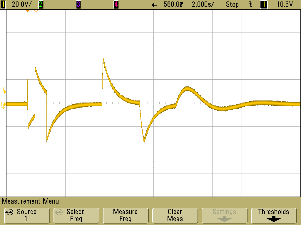

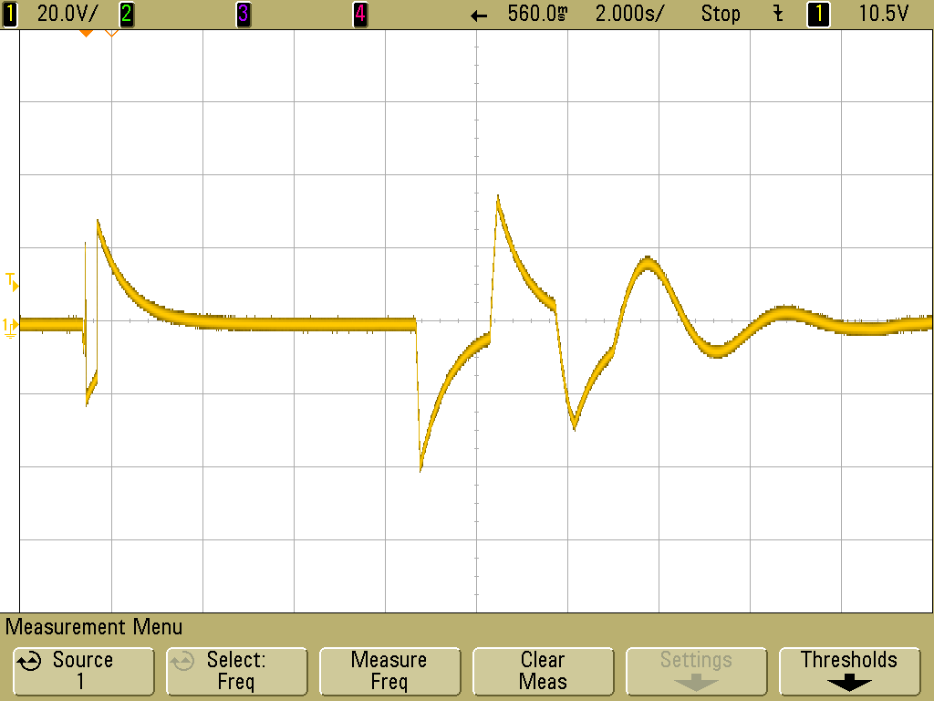

On start up there are some horrible transients on the outputs for about the first 20 seconds; after this some low level, low frequency oscillation still happens but it settles down.
Has anyone else experienced this, I wouldnt want it connected to the amp with this!
