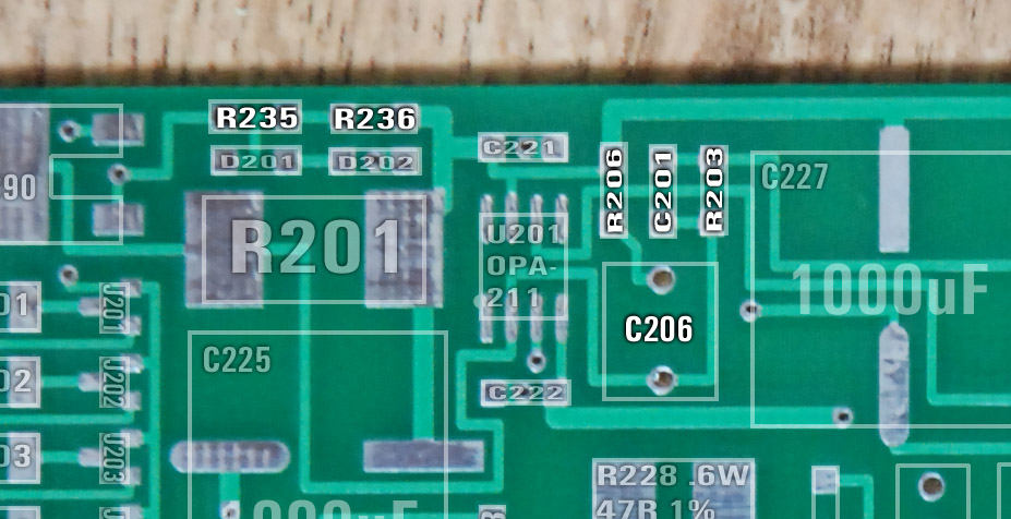

Does anyone has any HI-Res pics they can put up. Following the design is proving a challenge for me. A component overlay woud have been nice!

I really should pony up here seeing as I've been promising it for ages. I'll try and add as much to the solder mask and component overlay today as I can. I'm putting up a shed but I promise I'll give it some time.
I'll probably need some help with a few of the small caps/resistors but I should be able to do 80% of it today.
Ok, can someone please check this as far as it goes... I'm sure to have ballsed up.
Another update just uploaded. There area couple of bits in the signal path I need to get my head round, notably what's going on at c202/r205 where I'm missing a component in the layout.
If anyone would like to check for other errors, or has any hints I'd be most grateful.
That's a bit too oblique to help me out. I assume you are implying that it's not a 1206 package and therefore those pads can't be right. But the only other pads from that ztx690 that aren't 1206 are where I have R201 and i can't see anywhere else for that 2 watter to go.
Or are you just saying it's not 1206 and is another package and not SMT like all the other 100n caps, I don't understand?

Now I get it, they aren't vias, they are 5mm spaced leads. which means that I have both the cap and resistor wrongly placed. So, those two go there and those two replace them- which means these two must go next to them.

....and if that's a 5mm pitch cap then my other missing component, c202 is too. Some times the smallest hints can be all that you need. ;-)

SMD DPAK power devices in the power supply buffers are the same as those in the signal path: ZXT690/ZXT790 (not ZTX690/790).
