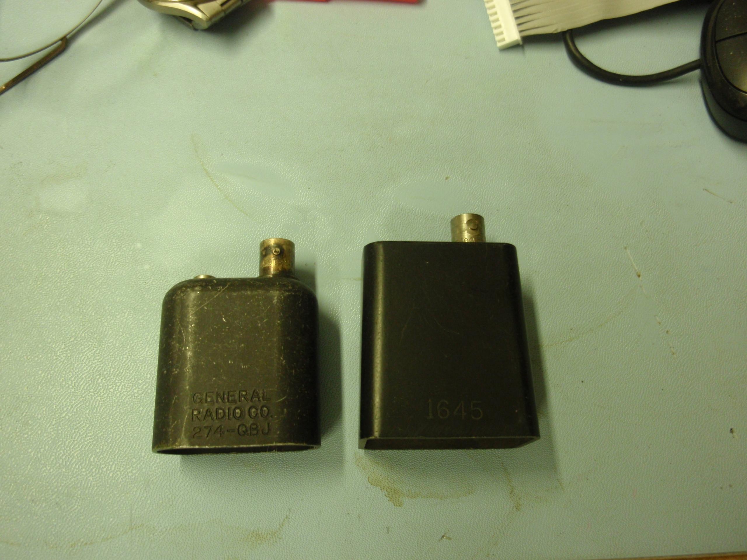

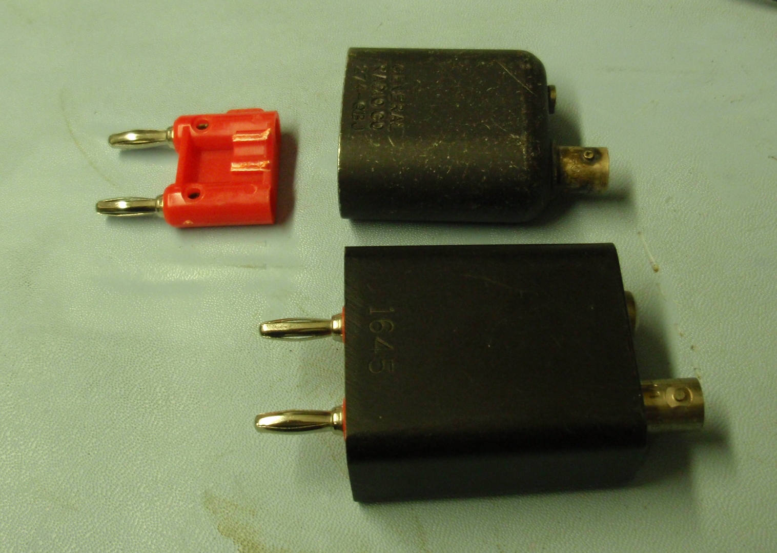

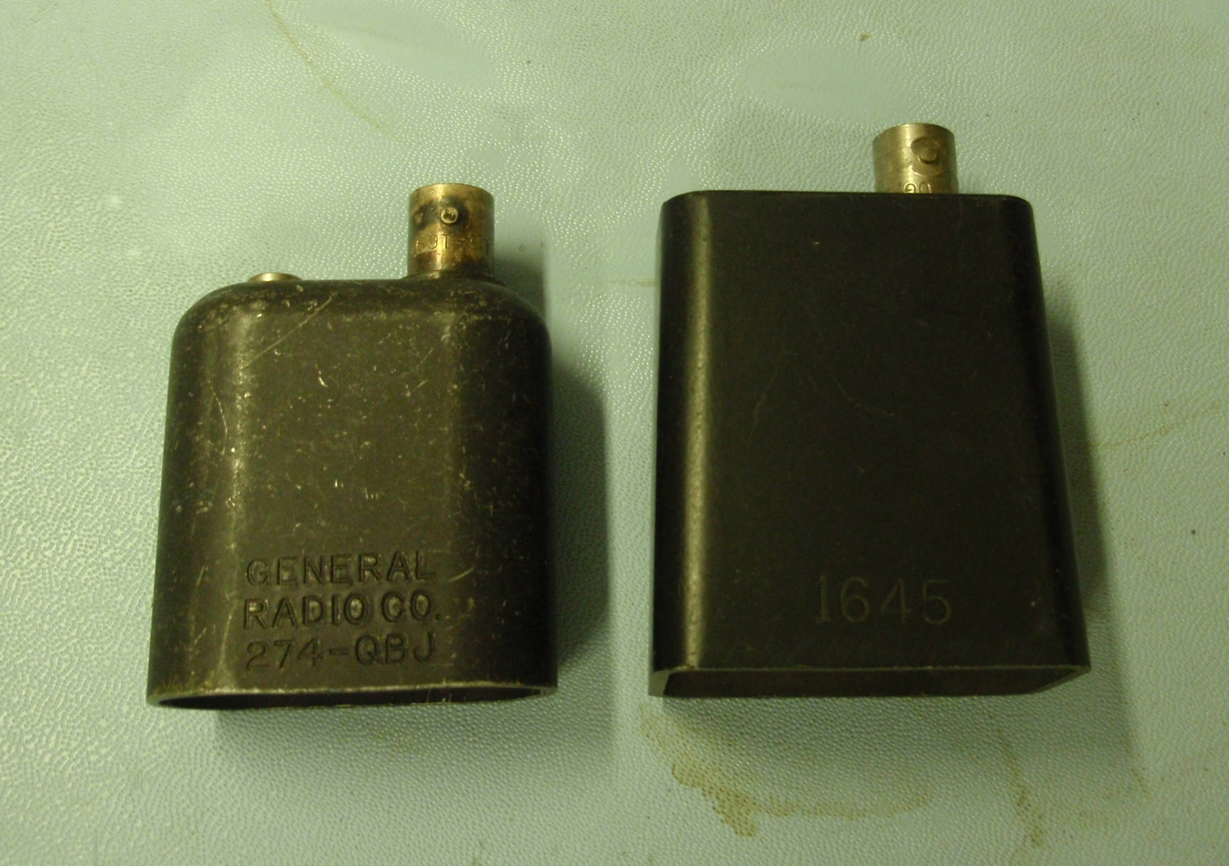

From an old post:"Binding post to BNC adapters. I have some Pomona adapters. I agree they are decent for the money. What I can't find are the dual binding post plugs with the ground skirt. Maybe they will be a DIY thing."
General Radio 274-QBJ or POMONA 1645 are life savers, worth there weight in GOLD.
Duke🙂
Hi KC,
Pomona 1645 in stock here.
My, they are dear, aren't they!
I had already decided I would have to make my own ugly ones, but I misplaced my banana "pins". I'll use plastic sheet and some copper sheet. They will be crude, but I can't afford a bunch of those.

Ouch! I collected them from local surplus stores and eBay over the years. Why isn't China watching? These would be less than $2 OEM in any quantity if someone was making them. They may not be of the GR quality and fit but probably more than good enough.
I do understand why they may not be common any more. With the need for shrouded banana connections and flush female connection in panels they don't work on new stuff.

Expensive yes, but I had to address my very real problems, and I am stuck with those older instruments for a while yet. I converted a couple cheaper devices to BNC, but I don't want to chop up an HP 339A, or my old 3581B or 3580A. So these will be used with those older pieces of equipment. I even have a 654A and 334A to use these with ('cause I like those instruments, I remember using them for work).
Anyway, it's done and ordered. Some day it will show up and I have one more issue dealt with. As for adapters, yes. You need a lot of them. I don't have enough, but they still overflow a little drawer (from a parts cabinet). They are split up between types (RF, audio and LF stuff).
