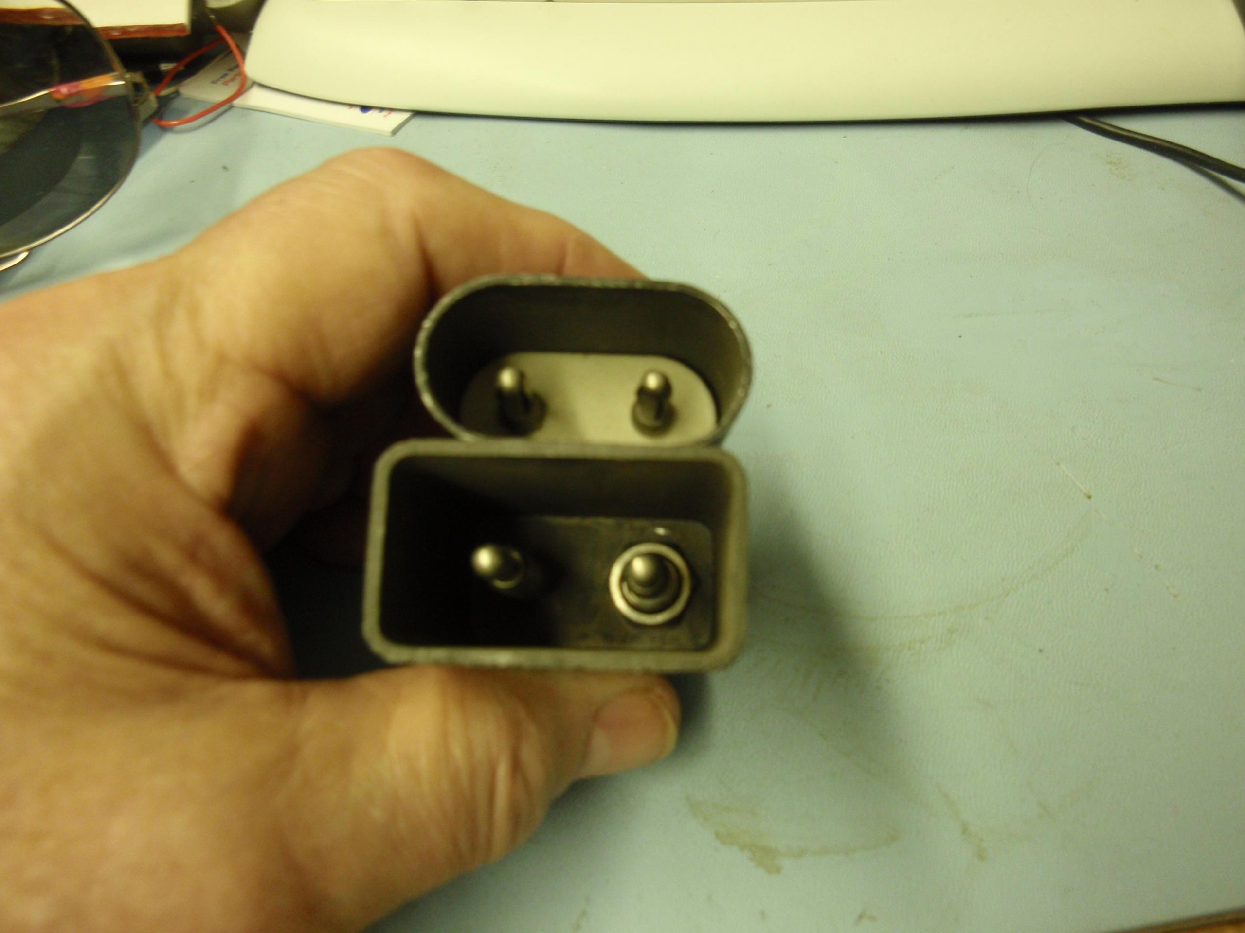

Thank's Duke, that is what I was looking for. 🙂
Just wanted to see what was inside them. Is the outside magnetic?
Or is it a ferrite type that is connected to the ground point.
Hi Sync
The GR is drawn alum can. The POMONA is a poured alum or pot metal.
I have seen several version of this type of shield on dual bananas. I have seen some with steel, brass and copper that were hand made.
Duke🙂
