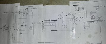

My option 1 339a bit the bullet the other day. Its been working good for me and all of a sudden... I thought I'd pass it by you guys in the hopes some of you might some ideas for me. My voltage/distortion readings disappear at the 100mV input range and below. The meter just drops to 0. My first thought was that one of the switch wafers was still dirty and needed a cleaning, so I got out the alcohol and Q-tips and started working on S4 on the A4 pcb. After cleaning it up good I tested it again and still no signal displayed.
I hooked up the scope and traced the input signal into the A4 and at A4 U100 TP 101 I have my input signal and it looks correct on the scope. Checking TP 103 on the output of U100 and I have a correct signal until I switch to the 100mV input range and then I have a flat line coming out of U100. I also notice a good bit of DC on the output of U100 and at 100mV range and below its pretty much on the neg rail at -14V with no sine wave, not even a clipped positive sine. The input of U100 (TP 101) has about -3V of DC on it at input ranges of 1V and below.
I began thinking that maybe the S4 switches came out of alignment or maybe one of the contacts was bad so I went through and verified that I have continuity on the S4 wafer contacts at the appropriate switch positions. I then decided to pull U100 and install a socket, I had a few LME49710's on hand so I tried one of those in place of the original 8451. Same problem, no output from U100.
My 339 is an Option 1 unit so it has two more input ranges.
Any idea's folks?
I attached a picture of the full A3 - A4 signal routing. I got tired of the 4 separate sheets of paper to trace the signal so I cut and taped them together to make my own fold-out.
Any idea's folks?
The is a dual gate mosfet before/at the first amplifier. It's purpose is to null the junction capacitance of the input protection diodes. Verify this circuit is working properly. You can do this by removing the mosfet or lifting one leg of the first protection diodes. If one of the coupling caps in the protection circuit is leaking it could cause this.
Okay I lifted one leg of CR102 & CR103 in the input protection string and retested and the problem still exists. I misspoke in my earlier post. The dc on the input to U100 drops to about -600mV on all ranges below 10V. However -14V (and no sine) is present at TP103 once the range selector is at the 100mV input range or lower.
After looking the schematics a bit more I realized why the DC measured at TP 101 would be highest at ranges below 10V. This being due to the signal being directly connected to the U100 input at those lower ranges with no voltage divider. C510 on the A3 should be blocking any DC from the input and I tried feeding a signal from my Amber 3501 into the 339 as well the other day with the same results, measuring DC and a loss of input signal at TP 103. I'll have to go back this evening and verify that I lifted the legs on the right diodes this morning. It doesn't seem likely that the DC on the input would come from much else.
I'm also beginning to wondering if I have some weird grounding issue. I'll inspect that also.
