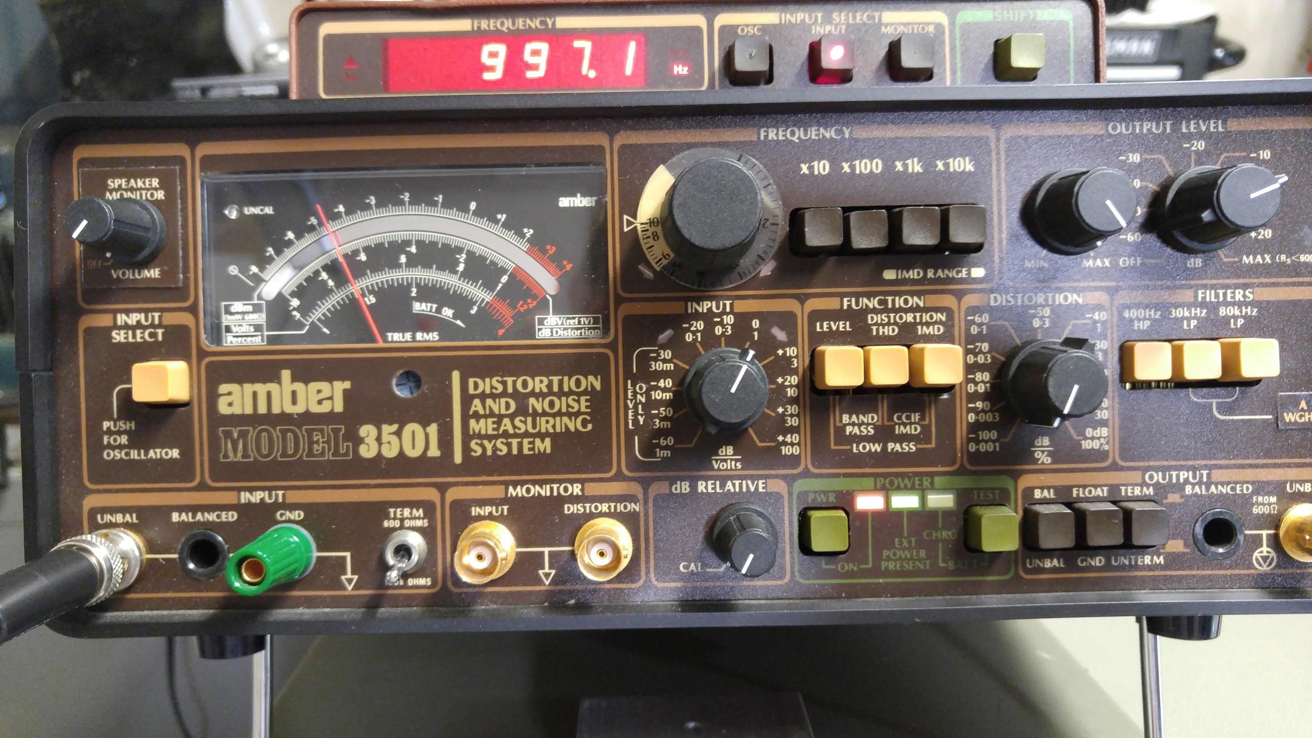

I attached a pic of the 339A oscillator as measured on my Amber. I prefer to use the Amber 3501 analyzer as it has a -100dB range so I do not have to squint at the meter. What you cannot see is that the needle is wavering from about -.00066% to -.0007% on the Amber. This is approximately what I see on the HP 339A's analyzer as it wavers about +/- .00005% when measuring the same signal.
Correction the last post should have read,
"What you cannot see is that the needle is wavering from about .00045% to .00047% on the Amber."
Not sure what I was thinking when I wrote that this morning. Maybe I should've finished my coffee first.
I had the numbers right in my post from a few days back.
Something I just noticed as well, the distortion performance of the 1.0 X 1kHz setting on the 339A oscillator improved substantially with the removal of these parts. Previously I had to use the 10 X 100Hz setting on the oscillator for best performance. The 1.0 X 1kHz setting had distortion of about .0012%, after the parts removal its now about .0008% so only slightly worse than the 10 X 100Hz setting which still has the better performance of the two.

Hey, I don't know if those 3501 Amber are selling but over on the
bay they want $1K - $2K for them. Go figure.
I get a head ache looking at it, but then I bet the knobs are original
while in the HP they tend to break and be replaced a lot.

The 3501's you reference have been for sale on the bay for a Loooonnnng time and at those prices they will continue to be on there for a much longer time. The few that I have seen sell in an actual auction, not at a crazy high fixed price like the ones you mentioned, sold for approx $200. I paid $185 shipped for mine. It was a helluva bargain IMO for the measuring capability you get.
The 3501 takes a bit of getting used to especially if you're familiar with a different meter like the 339A, but once you get used to the layout it becomes quite intuitive. The knobs are more durable than the 339A however they are a clamping type of knob and do not use set screws so they'd be a pain to replace if ever needed. I really like the user configurable filters that Amber implemented and the fact that the footprint of the 3501 is about 70% the size of the 339A's.

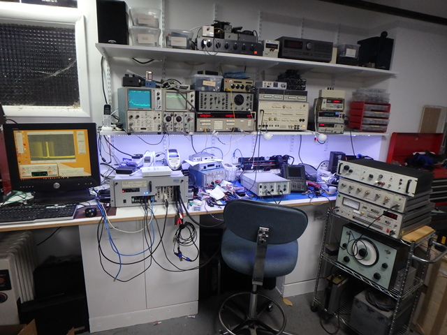

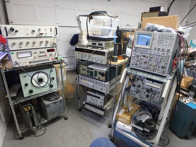

Sync-
Here is the shop. Its stuffed and a mess. The workbench is dominated by the ST1200 test panel. I think I'll move that along soon since I'm not making much use of its real strengths in my work.
The workshop follows Boyles law- stuff expands to fill all available space. In the middle of this stuff are some large worktables piled high with projects and stuff that all need homes.
I attached the pictures as usual but DIYaudio seems to be misbehaving tonight. If they aren't working I'll repost once things are.

@ Demian,
So clean, how can you stand it?
What is the thing sticking up in the 2nd pic from the left.
Red chair pic, on the main bent top between the power
supply and the head phones? Looks like some kind of
High Voltage Test Probe or something.
I can't tell from here though. I ask because I've got to build one
that won't screw up higher frequencies 40kHz to 1MHz,
and can withstand 40kV to 50kV. Affordability it key here.
Now I see why you like the under shelve lighting, just
looking at it, I like it.
While youre cleaning things out, if you have an old TEK SG603
I think and it's power supply let me know as I'm looking for one
that might be working.
My only criticism has nothing to do with you, but the cheezey
dual plastic wheels that the frame carts/shelves come with.
That is until I coated mine with a thin layer of Goop glue.
Now they roll over a grain of sand instead of getting stuck.
Thank you, you've grown into your larger space well!

Sync-
This is quite off topic so i'll keep it brief. That object is an HP 1" measurement microphone with an NBS 9A headphone coupler. I use it as a primary reference for headphone sensitivity.
How are you generating 1 MHz at 40KV and staying in the same space?
The correct probe is a Tek P6015. The A version is the current one. Its $2000 and good for 40KV with a realistic derating curve. download the manual and study it. I don't know of an alternative that is practical. There are some solutions for 1 MegaVolt transmission lines etc. but none of those would be meaningful outside of a substation or high energy physics lab. There is also the Sensitive Research ESH electrostatic voltmeter that's good for 40KV in some models. I have one good for 30 KV from the surge testing (and an older P6015 and 2 P6013's).

Demian, say it ain't so? I thought that was your 339A sitting there
just over the B&K Null.

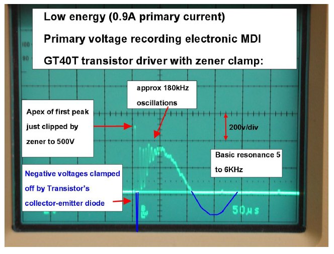

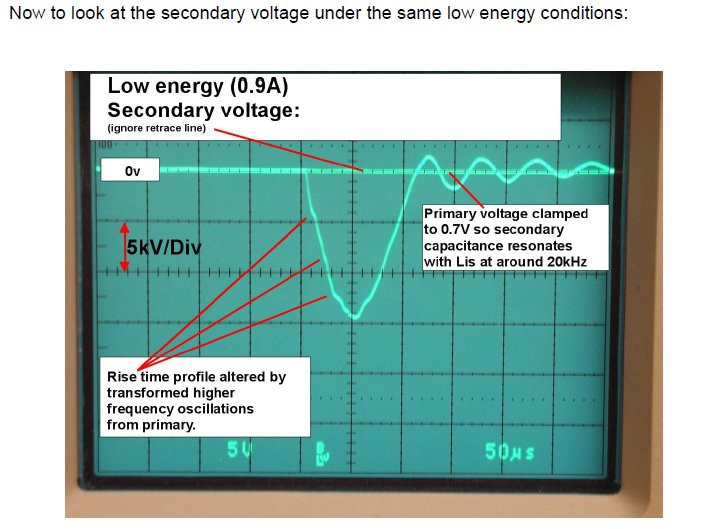

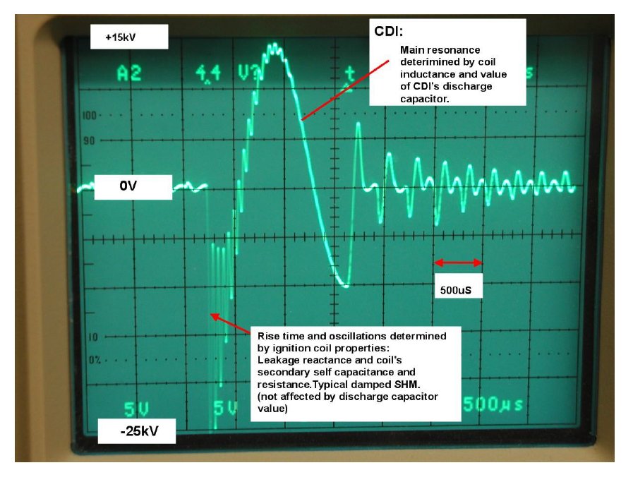

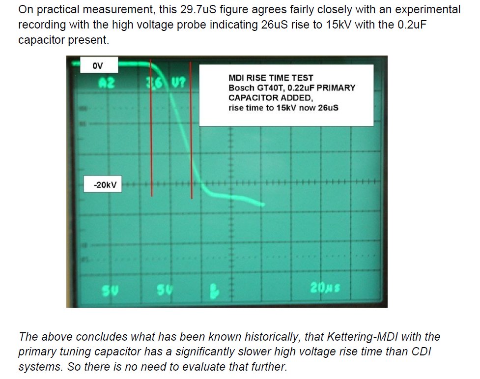

Yes, but using some DIYaudio parts among other things this is interesting
to me to build and it looks to be pretty good for testing as well.
Let me attach the four page information piece.
I've not done one but think I can and take some
measurements w/o killing myself.
The second pic is the spark shown on the Scope.

Chris, you are right, but if I told you or others here I could FEEL this, you'd
give me even more of a hard time.
So I'll include HH's scope captures and state those
oscillations really affect the seat of the pants driving experience.
You expect the vehicle to really take off hard, but instead kind
of feel it burping farting around.
